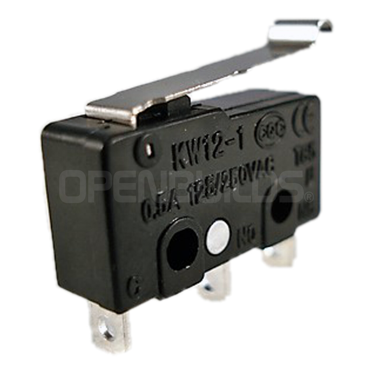

You could realise this with just an Uno and a handful of jumper wires and a couple of switches like the one s below. Use the built-in led as your annunciator for now.
These switches can usually be wired no or nc; just make sure the ones you get can be (3 connectors).

Thanks. Is there a pressure pad that can be wired NO or NC? We are trying to come up with something that can be placed in the bottom of the car seat, and also in the driver's seat. The switch you cited has the correct logic, but is not ideally suited for our application.
In fact, thinking a bit more about it, you can in any case handle the logic of the switch in code. You won't actually have the switches in series like in your diagram; they will both be read independently in your code, into two different Arduino pins.
(edit: Neither switch will "energize" anything: The Arduino will be monitoring them both all the time. It can easily be programmed to detect changes in occupancy, and make decisions based on those changes and the sequence in which they change.)
So even if they both read "high" under normal circumstances, you can decide in the code what it is you're looking for. What you're looking for is the child's or driver's seat to be occupied or not. If the child's seat becomes occupied, or is occupied at start up, and the driver's seat isn't, start the timer, kind of thing.
You could probably get started with 2x no pushbuttons. In real life you would "digitise" an analog sensors like the FSR suggested, by its value being above or below some threshold, and know the state (un/occupied) of each seat.
