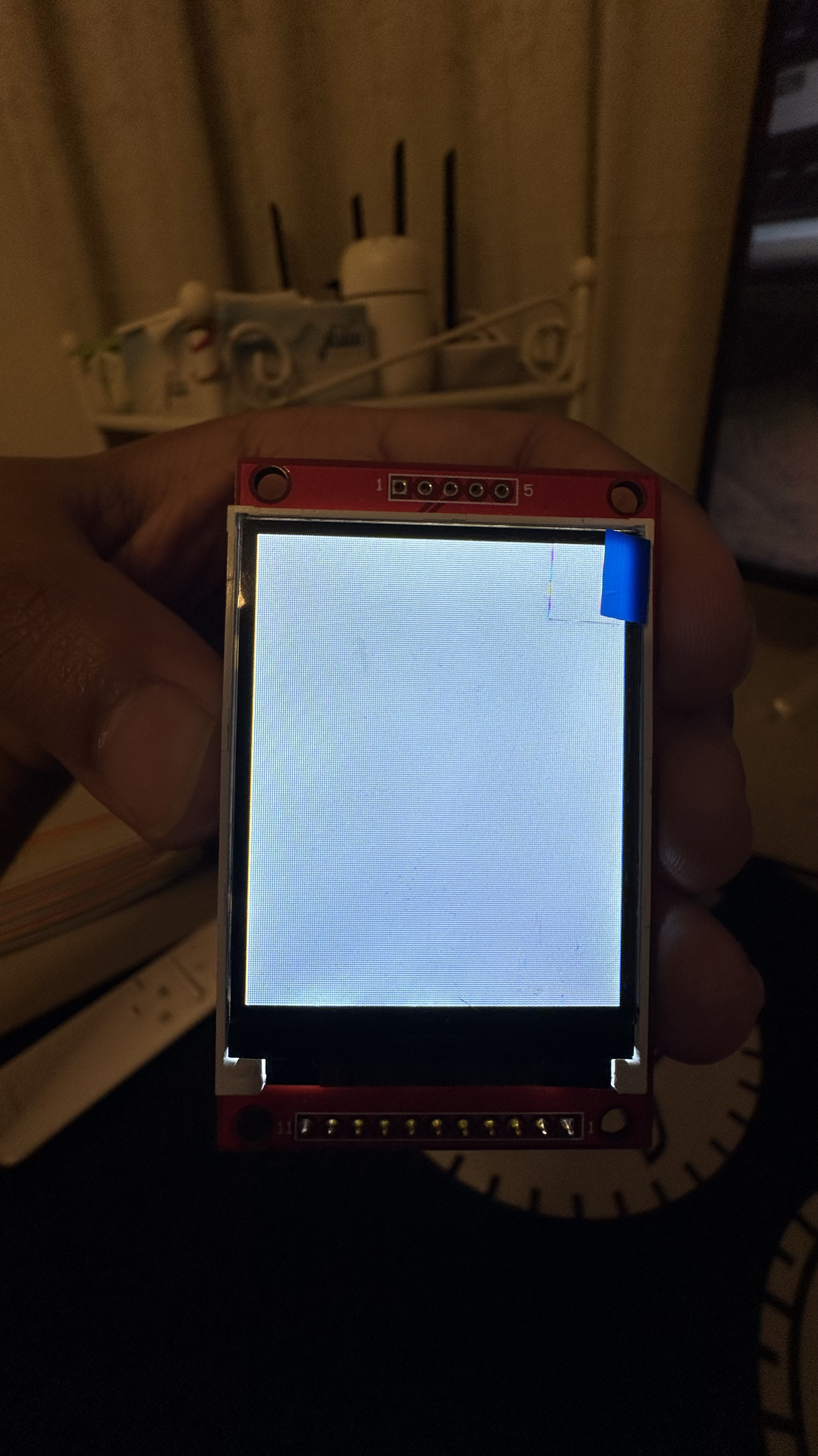

Display showing only white screen. Unknown controller 2.2 inch LCD display
I'm very new to Arduino and this is my first time working with a LCD display. This is the display i bought.
I'm having trouble finding any documentation regarding it, and it will only show me a white screen. How do I proceed and use this display? I'm very lost and worried I won't be able to use this display.
I tried connecting it this way as per chatGPT's suggestion:
Column 1 Column 2
VCC VCC (3.3V)
GND GND
GND Not Connected
NC Not Connected
NC Not Connected
LED VCC (3.3V)
CLK SCK (SPI Clock, Pin 9)
SDI MOSI (SPI Data, Pin 8)
RS 4
RST 3
CS 5
I'm using an arduino MKR wifi 1010. Tried running this sample code:

@jaykapse In the picture there is no connection on RST, your probably going to need that when you initialize the display

I actually connected all the wires other than one GND and the NC pins. My reset was connected to 3, i just took the picture before the connections were made.
Am I missing something with respect to the pins on the Arduino MKR? I just trusted ChatGPT's suggestions, but maybe the MKR pins corresponding to the display do not support it.
@jaykapse the only thing I can suggest is initializing the display driver like this

Adafruit_ST7735 tft = Adafruit_ST7735(TFT_CS, TFT_DC, TFT_SDI,  TFT_CLK, TFT_RST);
Check this link , there are many sources for this display. Get it with the backpack (I2C adapter) soldered to it if you do not have the soldering skills. This link should get you several possible sources. https://www.youtube.com/watch?v=xVC0X_PE_XE
