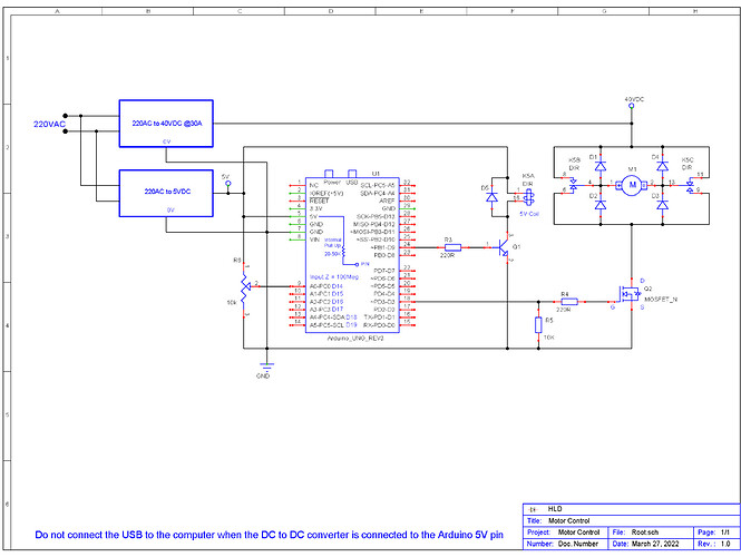

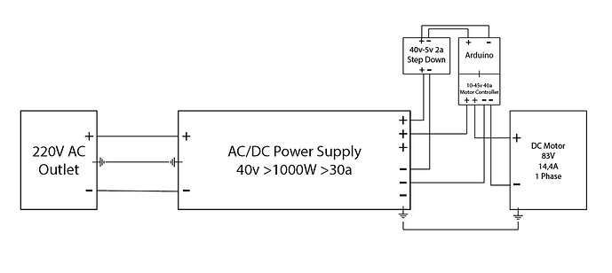

Suggest you start with a block diagram that includes all the items in your project.
Next create a schematic of this diagram.
We can then tear the above apart :wink:
IMO, use a relay to control the direction of rotation.
A simple MOSFET driver should work for PWM control.

A motor controller is over kill. :nerd_face:
As mentioned, a DPDT relay for FWD/REV and a logic level MOSFET for PWM speed control will suffice.

Thank you for the diagramm, i think i'll need to read an electronics book before i fully understand it :wink:
Ask if you do not understand :wink:

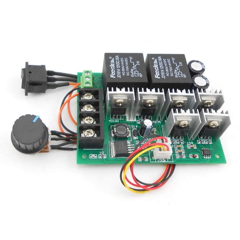

What about just using one of these motor control boards
and just replacing the 100k poti knob with a volume pedal the same resistance?

Its some chinese controller, 9-50v, 40a peak 20a continious - supposedly rated up to 2000w.
It would already have the reverse on it, and atleast on the pcb it says 100k where the poti knob is connected.
