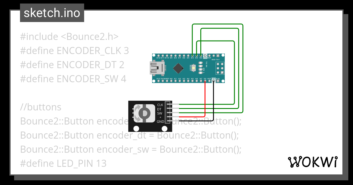

Using above code I was able to get proper clock wise and counter-clock wise serial prints of rotary encoder movements without any bounce.

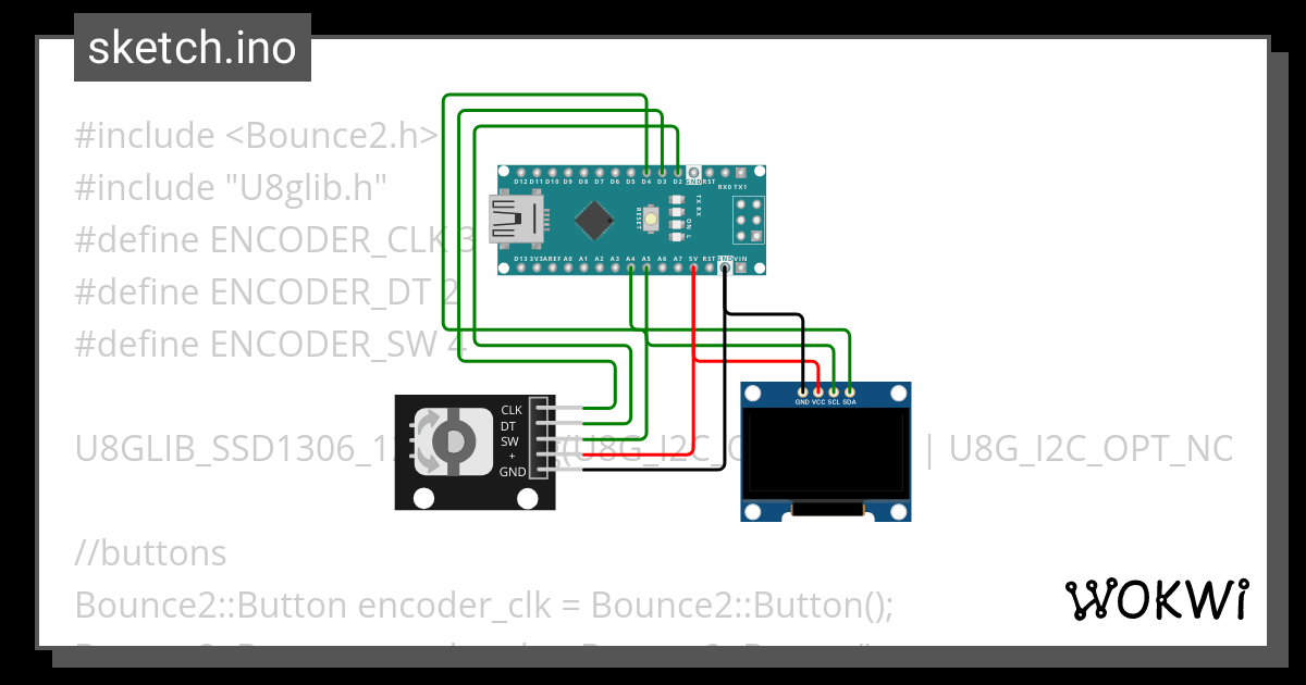

But then I decided to test the oled
The display works properly but the rotary encoder movement are not being registered.
Can anyone tell me what I am doing wrong and what is the proper way to do it.
Above is my wokwi simulation project. I have teste this same setup and code in hardware aswell and it doesn't work.
This is the simulation of rotary encoder only
Your subject explains the problem. You'll have to switch to a different way to read the encoder, which as you see the way you do it needs constant attention.
I googled
  interrupt driven rotary arduino
to be sure you'll get lotsa hits when you do that. Sry I can't.], but maybe someone has a favorite rotary encoder library.
By using interrupts, the encoder is able to count whilst the main line code is doing the display update.
Although it occurs to me that this too may not work if U8glib turns off interrupts. So far I can neither confirm nor deny this is the case, looking more now.

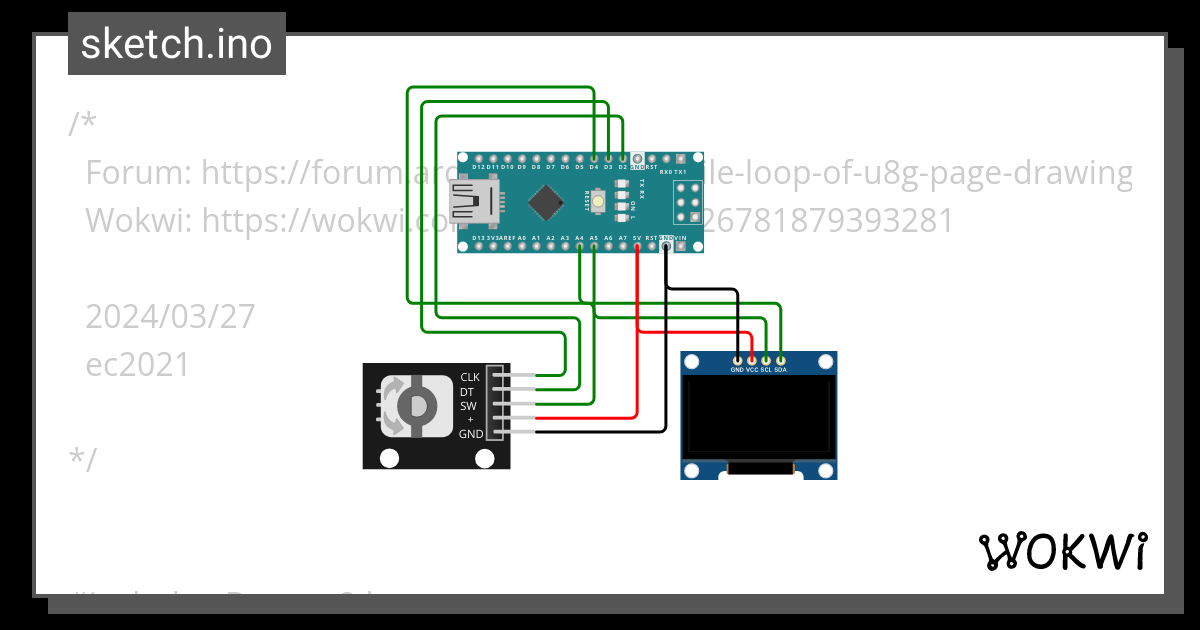

Hi @chizbiz ,
I took your Wokwi simulation and modified it so that it works:
Sketch:
  Forum: https://forum.arduino.cc/t/do-while-loop-of-u8g-page-drawing-mode-stops-everything-else-in-void-loop/1240533
  Wokwi: https://wokwi.com/projects/393526781879393281
  2024/03/27
  ec2021

You can test it here:
Changes:
For further information see the comments in the sketch ...
Good luckj
ec2021
