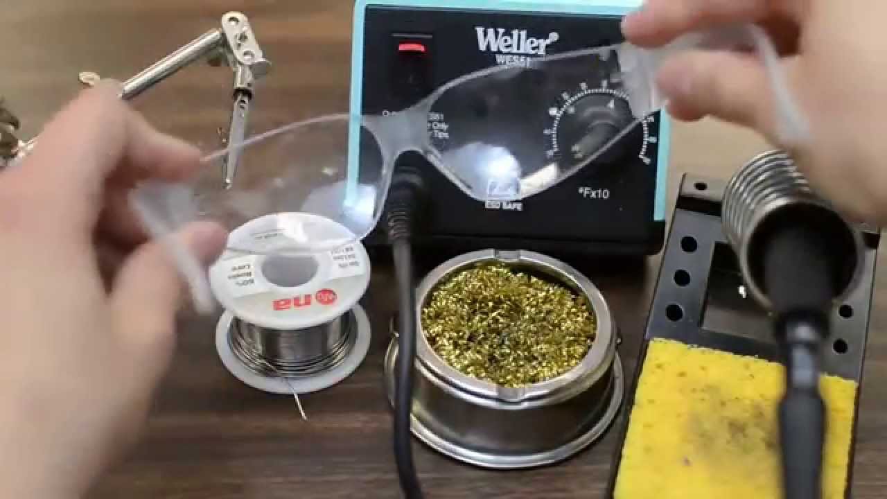

I bought this Mini Panel Mount DPDT Toggle Switch : ID 3220 : Adafruit Industries, Unique & fun DIY electronics and kits on-off switch, how do I connect it to the Arduino? The normal jumper wires don't work, the male is too long and the female too narrow and short.

You cut the opposite end of jumper wire off. Strip the insulation back about 1/4 inch. Twist the wire strands together. Insert that wire into the switch terminal you want to use and solder the wire and switch terminal to make a permanent connection.

Your DPDT switch has solder posts. Cut a few jumpers in half and solder them to the switch
What does "soldering" mean? Aren't there adaptors for this kind of stuff, is there an easier way? like these https://amzn.eu/d/eSpbWmr ?
I guess there are some connectors for that, but firstly not pre made and second off all not for the thickness of these connectors. The easiest solution in your case is to solder your wires to the connections. However if you don't have a Solderiron you may also just cut off the end of one jumper cable(make sure its the right one) take off some isolation. Now twist them together and put them through the hole in the connector and bend it downwards (or around). It wont be a strong connection but its enough for testing purposes.

Can this one do the job? The Amazon link might be in Italian for you, because that's where I live, but looking at the pictures is this the right tool for soldering? link: https://amzn.eu/d/6RRJcgn
Affirmative.
Practice flowing solder on wire/s first.
