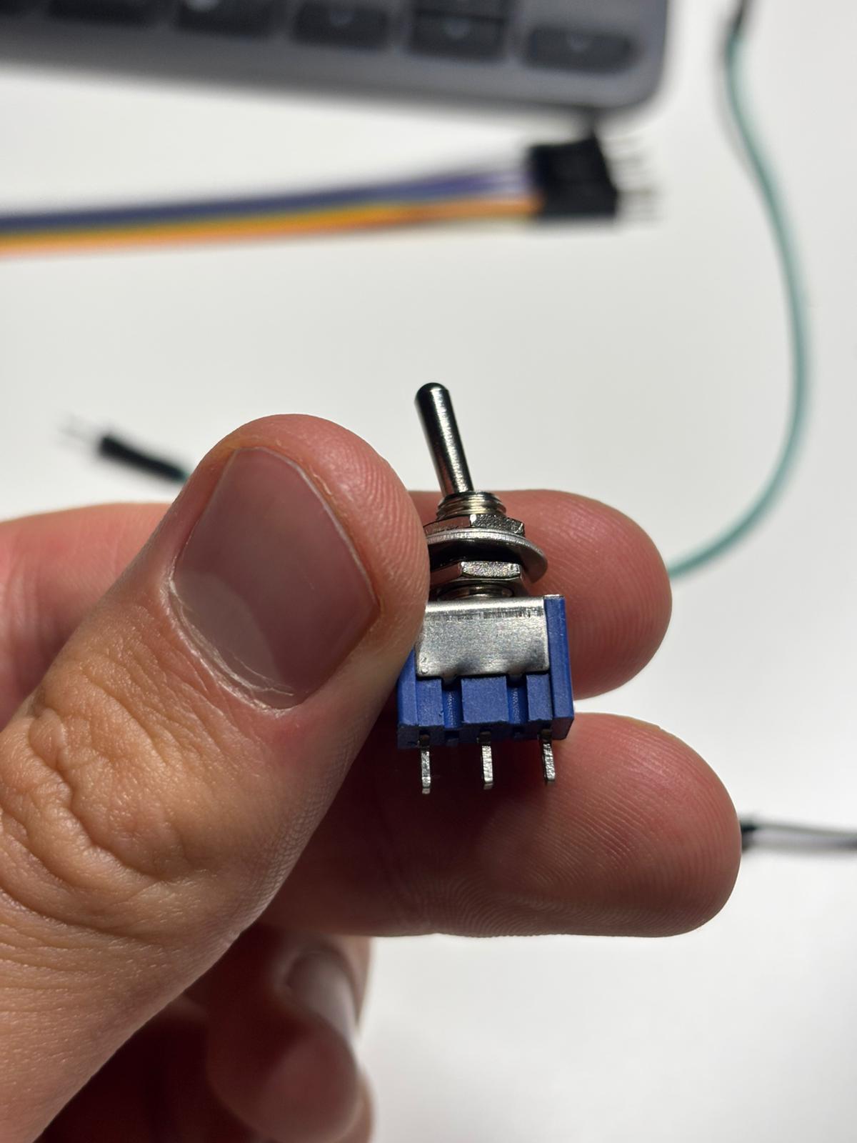

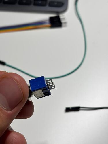

Hello everyone, I'm a complete newbie to Arduino, I bought this lever / switch QWORK® 20 Pezzi Mini Interruttore a Levetta SPST AC 125V 6A 3 Pin 2 Posizione ON/ON per Arduino Barche Veicoli (MTS102 Blu Scuro) : Amazon.it: Commercio, Industria e Scienza and I have these wires ELEGOO 120pcs 3 in 1 Kit Cavetti Jumper Filo Dupont Multicolore Wire 28AWG Cavi 40 pezzi 40 pezzi da Maschio a Maschio, 40 pezzi da Femmina a Femmina per Arduino Raspberry Pi : Amazon.it: Informatica
How do I connect the two? Via soldering? Is there some kind of adapter? The three metal parts coming out from beaneath the switch have a hole in them, how would I solder the wires to the metal parts? Please let me know.
Thank you in advance,
Hans

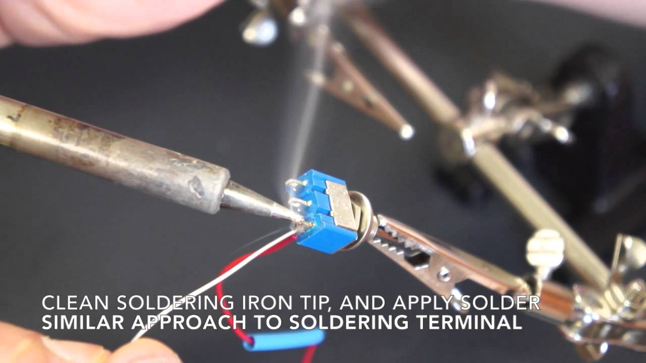

Strip off some insulation, push the bare wire thru the holes and bend over so they stay put. Now solder each wire to the tabs.
Normally, you'd solder (soldering iron, solder, and flux). I'm sure there are thousands of YouTube videos. ![]()
You could possible use Possibly Quick Disconnects which are crimped to the wires with a special crimping tool.
An electronics hobbyist should have a soldering kit, a supply of "hook-up wire", a multimeter (a cheap one is OK), wire cutters, wire strippers, and jeweler's pliers. (Thats what comes to mind off the top of my head.)
