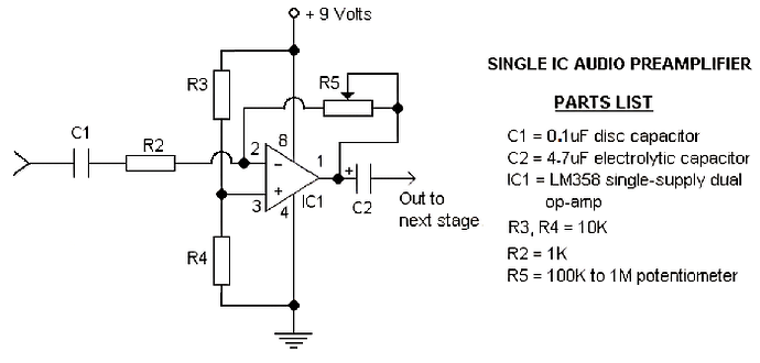

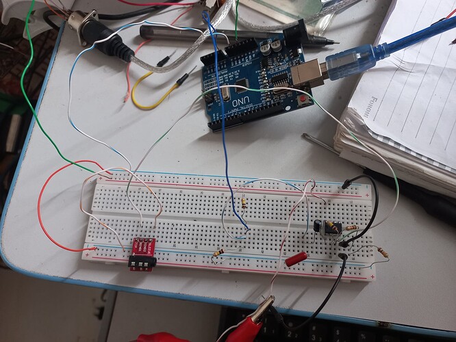

My circuit:
It's probably worth trying a couple of batteries.
Normally, op-amps use dual (positive and negative) power supplies. You can use a single supply but you have to bias the input instead of the output. (I don't have a handy schematic for you.) Or if the circuit has gain it might be best to bias both the input and output.
It's also a bit "dangerous" to potentially send more than 5V (or negative voltage) into the Arduino. Voltage Protection Circuits
The 12V and Arduino need to have a common ground. so the - of the 12V needs to connect to the - of the arduino.
Also a TL082 is NOT rail-rail compatible. Look at the table you will find here and choose one that is, or (as shown in the original circuit) use two batteries.
You have wired the power to the op amp backwards. Pin 4 should be the negative and Pin 8 should be the positive.

The reason for two 9V supplies is to give a positive and negative supply to the op-amps.
The junction of the two is connected to circuit gnd.

Why are you angry?? @TomGeorge just posted the wiring diagram from the site that I mentioned in the op which i am already based on, and no I am not wiring ground and vcc wrongly look at my picture of breadboard...

All operation amplifiers need a split supply, some times called a dual supply. With only a single power supply you need some way of creating a mid way voltage point known as a virtual ground.
That is what @runaway_pancake showed you how to do in his post #17. The resistors R3 and R4 provide a mid rail point or virtual ground, for the other signals to pivot around.
This technique can be applied to any operational amplifier. Personally I would put a 10uF and 0.1uF ceramic capacitor across each of R2 & R3 to make this virtual ground a bit more robust and stable.
However, in your case you need a virtual ground like this and a way to reduce your 12V signal into a 5V peak to peak signal centered or shifted down to 2.5V so as not to damage your Arduino.
This link shows you how you can achieve this using operational amplifiers.
PDF on DC offset and shift
Note this is in addition to any operational amplifiers you will need to boost the very small signal you get from the guitar's pickups so that it is about 5V peak to peak.
The other thing about the successive links (rabbit holes) from the original article you were trying to follow, is that the author of the frequency measurements is very concerned about not getting clipping on the input waveform. Where as the way the signal's period is measured will work a lot better when the signal is clipped. You see what I mean about instructables being full of fundamental mistakes.
Your schematic in post #17 has a lot wrong with it.
  1. there is no capacitor on the operational amplifiers input to remove the DC bias from your source.
  2. the mid point from your virtual ground using the 10K resistors is not wired to anywhere.
  3. but you do get a virtual ground from your two 100K resistors for the Arduino but it is not wired to the operational amplifiers where it is needed.

But on your photograph you don't seem to know that as the notch on the IC that indicates which way round it is, seems to be aligned with the artifact.
This a a part of what you posted:-
It is pretty faint but looks like a notch to me, certainly I can't see anything like that on the other side.
So I would suggest it is not wired up like you think it is, as you showed in your post #10, and that this chip might already be toast.
Because of the angle the photo was taken from and the underexposure. However, we can fix that up well enough to get clarity on the matter:
The white "O" artefact in the wiring diagram is probably the first letter of the word "Opamp", with the rest cut off because it didn't fit onto the component shape.
