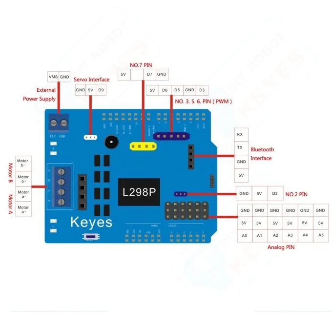

How can I connect the shield to the arduino but not connect it directly because I need the other free pins on the arduino to connect microswitches and buttons.
I will connect the stepper motor to the shield (M3 and M4), which will be used to open the door of the elevator I am working on.
The "other free pins" might also be available on the shield. Find the datasheet, or use a multimeter to discover which pins are available.

Dk electronics l293d shield
I already have an arduino that controls the cabin, up and down. On that arduino, I have connected buttons, micro switches and a driver for the motor that starts the cabin. I have another arduino to control the second stepper motor that should open the cabin door. I was thinking of bringing signals from buttons and microswitches to that arduino in order to synchronize them. The problem is that my Dk electronics l293d shield takes up the whole arduino, and when I try only some pins, it doesn't work. I don't know how to connect it all I have a l293d ic and a 74HC595N to expand the pins if that helps.

I'm interested in which pins the shield uses on the arduino (specifically M3 and M4 from the shield, which pins does it need on the arduino). The stepper motor works when the shield is placed directly on the arduino, but when I try via certain pins it does not work

Which 'certain pins' did you try? I think you must connect all pins that are marked as 'used pins' on the PCB (pins 3-12) and 5V/Gnd. If you only use M3/M4 and no servos you may omit M1,M2,S1,S2
M4 - pins 6 and 7
M3 - pins 11 and 8
When I put the shield directly on the arduino, the stepper motor works, but I can't because then there are no free pins for buttons and micro switches. I even tried connecting the motor to the l293d IC on the protoboard and it didn't work, it just locked it in place.
The picture of the shield shows "USED PINS -->"... Looks like you have DIO 13 and 2 available, and all the analog pins A0 through A5 (14, 15, 16, 17, 18, 19) for buttons.
The dots on 12, 8, 7 and 4 probably mean something.
Where did you see these connections?
These are the connections to the HC595 serial-parallel converter. The H-bridge inputs are controlled by the HC595. Without connecting these pins it will not work.

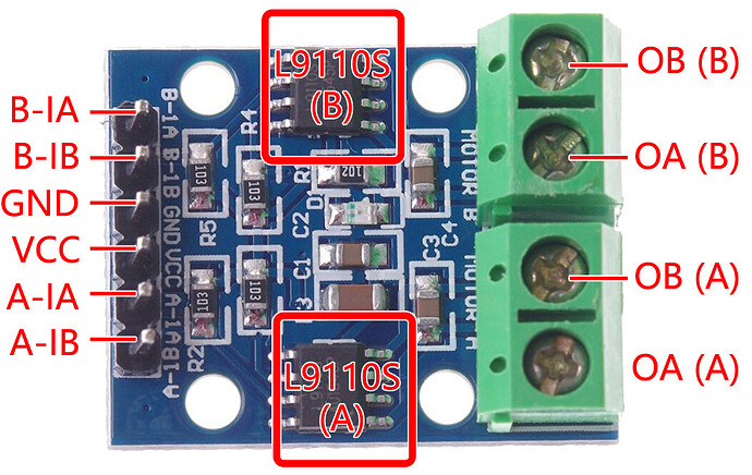

I have 3 more motor drivers that I can use: L298D, L9110 and ULN2003
Which one is best for my stepper?
FVD19INJ9YJH4P1
The ULN2003 is not suitable for your driver. If you don't exceed 12V for your stepper, the L9110 board seems better than the shield, because it lets more pins free for other purposes. But it definitely needs another software to drive the stepper than your L293-shield.
