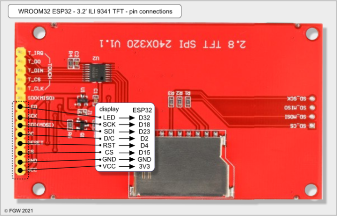

To which pins of the ILI9341 display should I associate the four pins of the #defines.
I couldn't find any information.
Any advice is welcome
I know what are the analog pins and digital pins of ESP32.
But my problem is to associate #define YP A2, #define XM A3, #define YM 8, #define XP 9 with which of the 14pins on the ILI9341.
Which of the 9 pins that are needed for the display or the 5 pins that are needed for the touch.
which specific ILI9341 based display do you have? give a link?
it looks like the code of post 1 is for the Adafruit 2.8" TFT LCD with Touchscreen
The link is this: 1PCS NEW 2.8 inch SPI LCD module 240*320 TFT with touch ILI9341 #YT | eBay.

the Adafruit code is probably for a different touch technology to the display you are using
try the following using the TFT_eSPI library
file Test_Touch_Controller.ino
// toutch screen connections
// connect T_CS to GPIO 5
// T_CLK to GPIO 18 CLK
// T_DO to GPIO 19 MISO
// T_DIN to GPIO 23 MOSI

#define TFT_CS   15
#define TFT_MOSI MOSI
#define TFT_SCLK SCK
#define TFT_MISO MISO
#define TFT_DC   2
#define TFT_RST  4
#define TOUCH_CS 5    // toutch screen CS pin

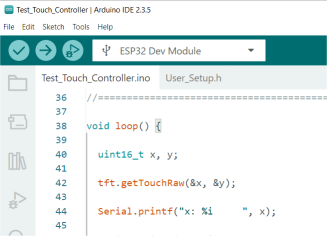

just recompiled and linked the code OK
I am using IDE 2.3.5, ESP32 core 3.2.0, TFT_eSPI 2.5.43
Tools>Board "ESP32 Dev Module"
what is your configuration?

thinking again - did you copy the User_Setup.h file in to the same directory (Windows calls them Folders) as the test program .ino file?
the IDE should show tabs for the .ino and User_Setup.h files
the User_Setup.h defines the touch pin
#define TOUCH_CS 5    // touch screen CS pin
if that is not defined the function getTouchRaw() is not compiled
I copied and verified the User_Setup.h.
It is in the same folder as the .ino file.
The T_Cs is connected to the GPIO5.
The version of ESP32 that I use is 2.0.17.

I installed ESP32 version 3.0.0 and the sketch works.
I see on the Serial Monitor the numbers changing if I press on the display.
With versions of ESP32 higher than 3.0.0 it gives me the previous error.
