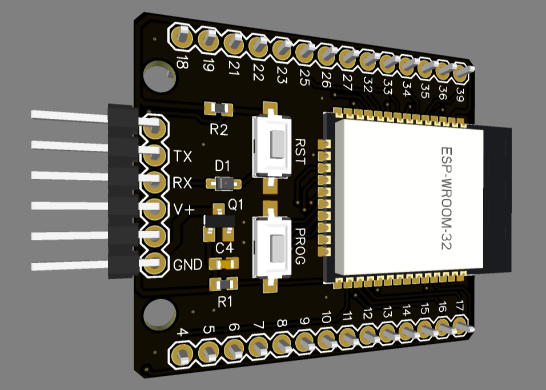

I want to design a circuit that only the esp32 chip can be placed on the PCB along with the 5 to 3.3 V power supply and that it can be programmed from the board through the pin header.

The serial connection, for upload, is fairly clear. Easier to use manual reset and boot switches.
Power supply needs to be around 500mA or more capable.

I also found this. With an FTDI module, the module can be programmed by the pin header.
Schematic_ESP WROOM 32 Breakout_2020-07-14_22-13-05.pdf (53.9 KB)
Yes, something like this. But I don't want it to be programmed from pcb with usb. I want it to be programmed with the converter through the pin header on the board. Like what I posted above
