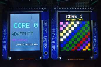

Good morning.

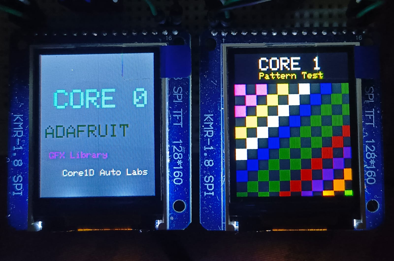

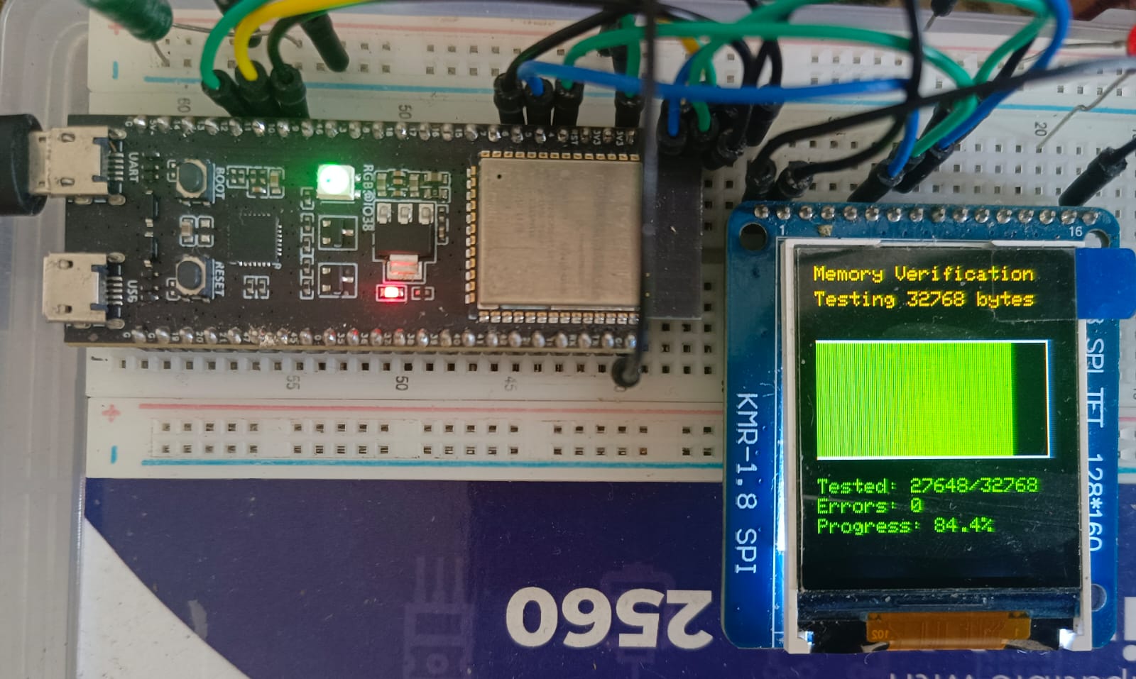

For the last few days I was experimenting and testing various ST7735 displays with an ESP32 S3 Devkit C1 N8R8, and also testing optimizing tricks and under the hood working as I read along about them.
From that endeavour, my first step to a long term goal has come to fruition.
I have managed to assemble together my own graphics library implementation, designed to drive two BACKTAB ST7735 displays efficiently (more displays will be added soon, starting from all the displays I own), using as much techniques i could learn about from LX7 specific optimizations and a slightly better knowledge of C++ in general and the βunder the hoodβ working of Arduino AVR GCC Compiler.

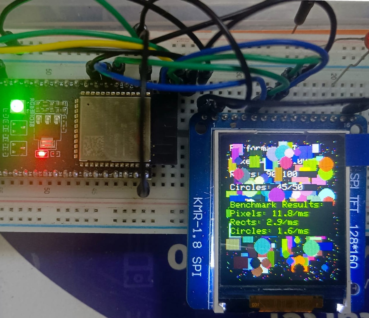

My focus was to deliver a perceptive and undisputed smooth animation (Frame State Transitions) rather than brute chasing FPS.
It may not provide much, but from what it does, mostly they have been robust tested.
I have not started to make a GitHub repo yet, but it seems like the time might be coming soon if I work on this further.

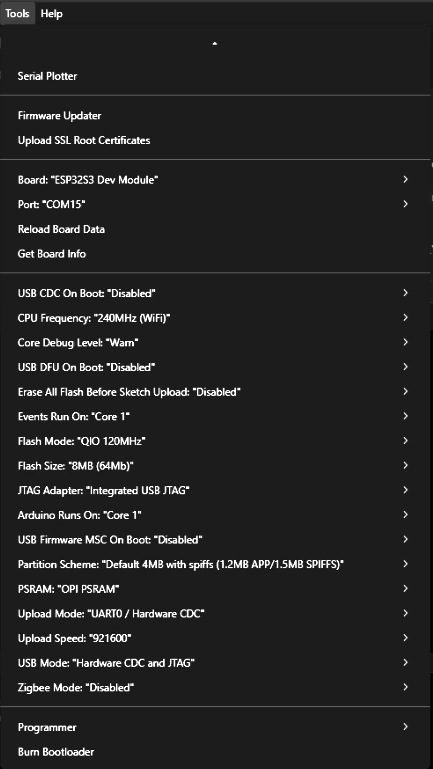

I only have Devkit C1 with me so far, so I only could test it there. If anyone else would like to test it, feel free to do so and even modify and use it in whichever project you like, provided this niche hardware setup somehow comes to be of use.
This is still a work in progress and patches and updates for different screen are soon to come.
First small goal is to cover all ST7735 lineup. And improve on it as per my project needs.
Presenting the Beta release of:
TFTFriend - ESP32 ST7735 Duo BLACKTAB GFX Library
Arduino SPI

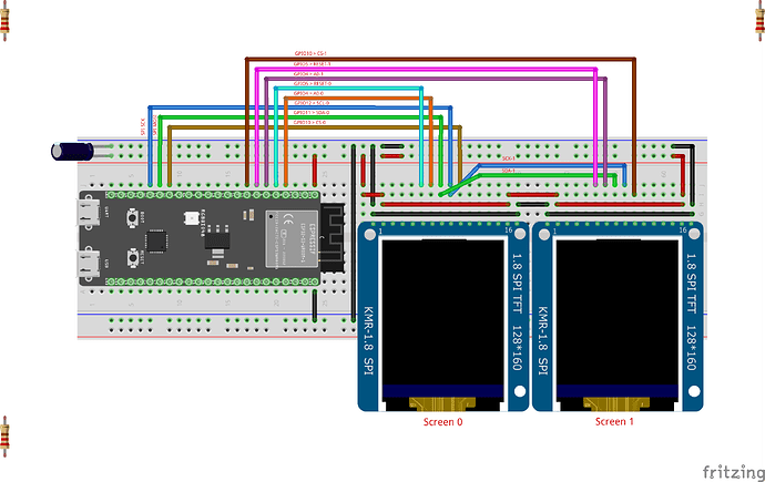

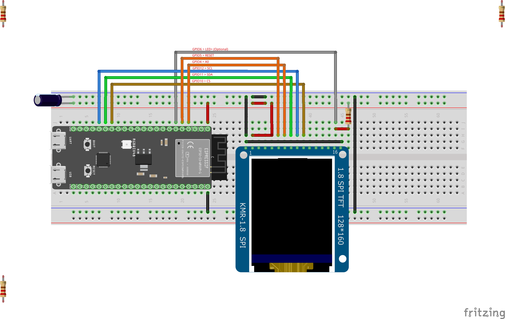

Hardware Requirement:
- ESP32 (S3 N8R8 Devkit C1 tested)
- Two ST7735 BLACKTAB SPI displays with common MOSI and SCK bus line.
βββββββββββββββββββββββββββββββββββββββββββββββββββββββββββββββββββββββ
β CONNECTION SUMMARY TABLE β
βββββββββββββββββββ¬ββββββββββββββββββ¬ββββββββββββββββββ¬ββββββββββββββββ€
β Function β ESP32-S3 GPIO β Display #1 β Display #2 β
βββββββββββββββββββΌββββββββββββββββββΌββββββββββββββββββΌββββββββββββββββ€
β SPI Clock β GPIO 12 β SCL Pin β SCL Pin β
β SPI Data β GPIO 11 β SDA Pin β SDA Pin β
β Chip Select 1 β GPIO 15 β CS Pin β N/C β
β Chip Select 2 β GPIO 10 β N/C β CS Pin β
β Data/Command 1 β GPIO 7 β DC Pin β N/C β
β Data/Command 2 β GPIO 4 β N/C β DC Pin β
β Reset 1 β GPIO 6 β RST Pin β N/C β
β Reset 2 β GPIO 5 β N/C β RST Pin β
β Power (+3.3V) β 3V3 β VCC Pin β VCC Pin β
β Ground β GND β GND Pin β GND Pin β
βββββββββββββββββββ΄ββββββββββββββββββ΄ββββββββββββββββββ΄ββββββββββββββββ
PS: For no manual control for the display Backlight, treat LED+ as VCC and LED- as ground. Do refer to respective datasheet for 5v5 compatibility. the used BLACKTAB display supports 5v5 logic as well.
