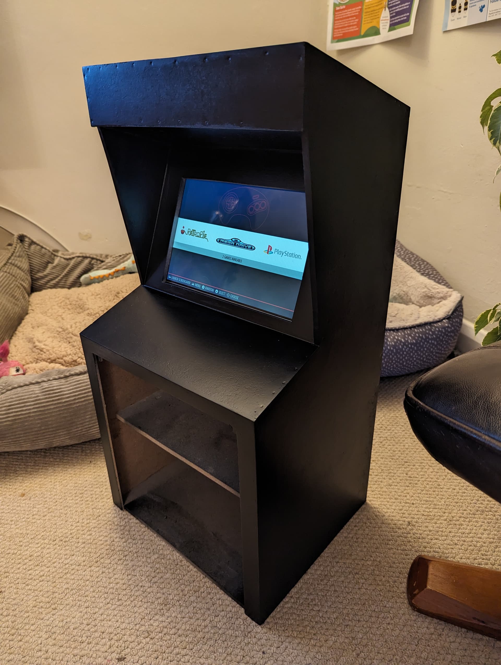

I have been building this mini arcade and part of the project is some push buttons that are mounted to a PCB.
I want to mount these inside the case and then drill hold though and have a button on the out side that pushes though to the button inside to give a clan look. I am sure there must be a name for this kind of "button extender" but I can't find them online if any one can help let me know what I should be searching for.

This is not for the controls, this is the screen controller board, brightness, contrast, etc. So I don't have much flexibility the control board that comes with the screen is what it is.
So will be mounted at the back next to volume control buttons.
I am mounting mini joystick and buttons for game control on the front, they will be just standard mounts.

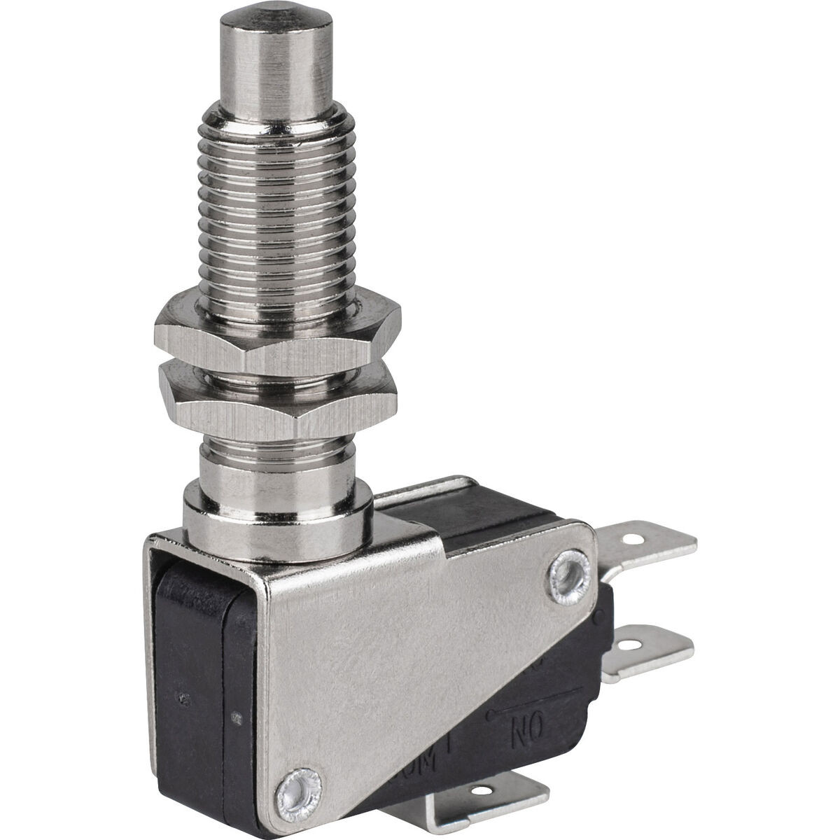

Those are absolutely the worst switches you could use for this.
Use quality micro switches.

If you don't mind resoldering - extended actuators available:
