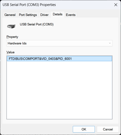

  1. Make sure that nothing else is using COM14. It might be the port being locked by a previous upload attempt or something totally different.
  2. I suspect that your board has the FT232 chip on the bottom. If you're using IDE 2.x, there is a known issue when uploading to a board with FTDI chips while the serial monitor is open. So close that if it's open.
I think those two contradict each other. The loopback usually fails if your board has the CH340.
You can determine what the serial-to-usb converter (the chip on the bottom of the board) using Windows device manager.
I'm using Windows 11; in both images, it's the bottom one in the list
CH340
FT232
You can take it a step further.
  1. Double click the entry for the port in device manager.
  2. Select the details tab.
  3. Select Hardware Ids from the property drop down.
CH340
1A86 identifies the manufacturer of the CH340 (WCH) and 7523 identifies the chip (CH340).
FT232
0403 identifies the manufacturer as FTDI and the chip as a FT232 chip.
Is that for the chip at the bottom or for the chip on the top? Note that markings can be difficult to read. I usually take a close-up photo; you might have to angle the board a little to get the right light conditions.

Ok so, sterretje, you have confirmed what I thought in that my PC does not show the serial device as a CH340. but as FT232.
