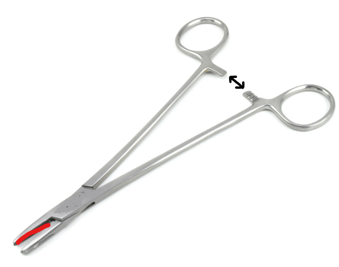

I need guidance on how to set up a force sensor with arduino to read in newtons or pound force. The best way to describe the set up I have currently is through the following example:
I want to measure the pinching force when hemostats are locked onto a 2mm thick magazine.
Please leave any guidance, suggestions, or questions you have below. Thanks in advanced!

The setup currently looks like this but the basic arduino code im using only output messages such as "light squeeze" or "medium squeeze".
