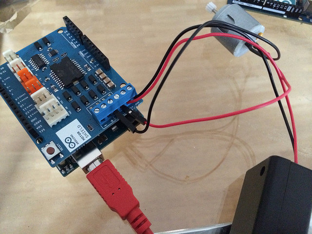

Sorry for the missing information in the initial post.
This is my setup
I got the motor moving with an Arduino UNO instead of the Arduino Yun (hmm.. something feels buggy with my Yun...)
In any case, the main question was how to map the pins from the Arduino to the pins on the shield. The main motor pins are clear now, and luckily I found http://www.instructables.com/id/Arduino-Motor-Shield-Tutorial/step4/One-Motor/
But on the shield are many more pins (the mail header pins e.g.). what are they for?

const int AMDir = 12;
// AMDir: Digital direction (rotation sense) output pin assigned to the "A" motor. The pin assignment is not free, as the motor shield has the pins assigned (12: motor A; 13: motor "B". By convention, the forward movement HAS to correspond to the HIGH value in this pin; rewire if not)
const int AMotPWM = 3;
// AMotPWM: Digital output pin assigned to the "A" motor. The pin assignment is not free, as the motor shield has the pins assigned (3: PWM motor A; 11: PWM motor "B". Both signals are boosted by the board to the LSP1/2/3/4 terminals)
const int BMDir = 13;
const int BMotPWM = 11;
Hope it helps.
