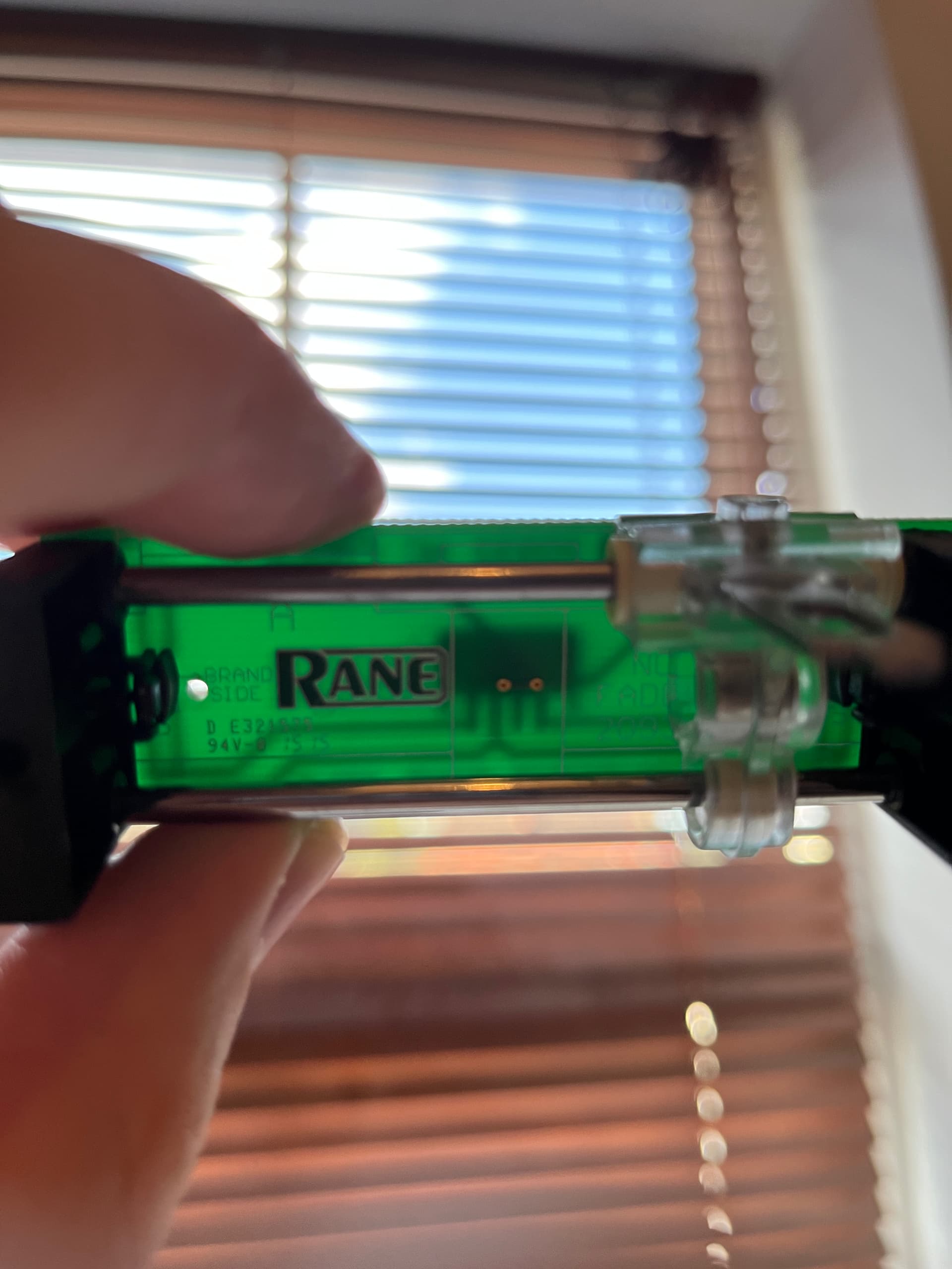

I'm working on an improved version of a DIY MIDI controller that is based on a DJ-style crossfader. For the updated version I plan on using a contactless approach using the main rails/PCB from a commercial crossfader.
rf_dirty_fader
You can make out the two hall sensors next to the black vertical bits, and in the middle of the fader bit is a neodymium magnet.

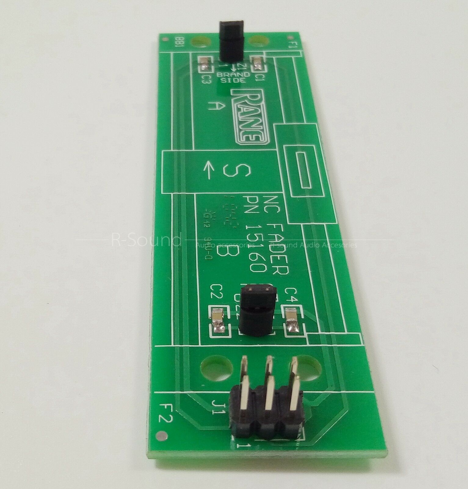

Incidentally, these are the best/clearest pics I could find of the PCB. Not nearly clear enough to read the part numbers however.
You do realise these are a discontinued line..??
There would be replacements though.

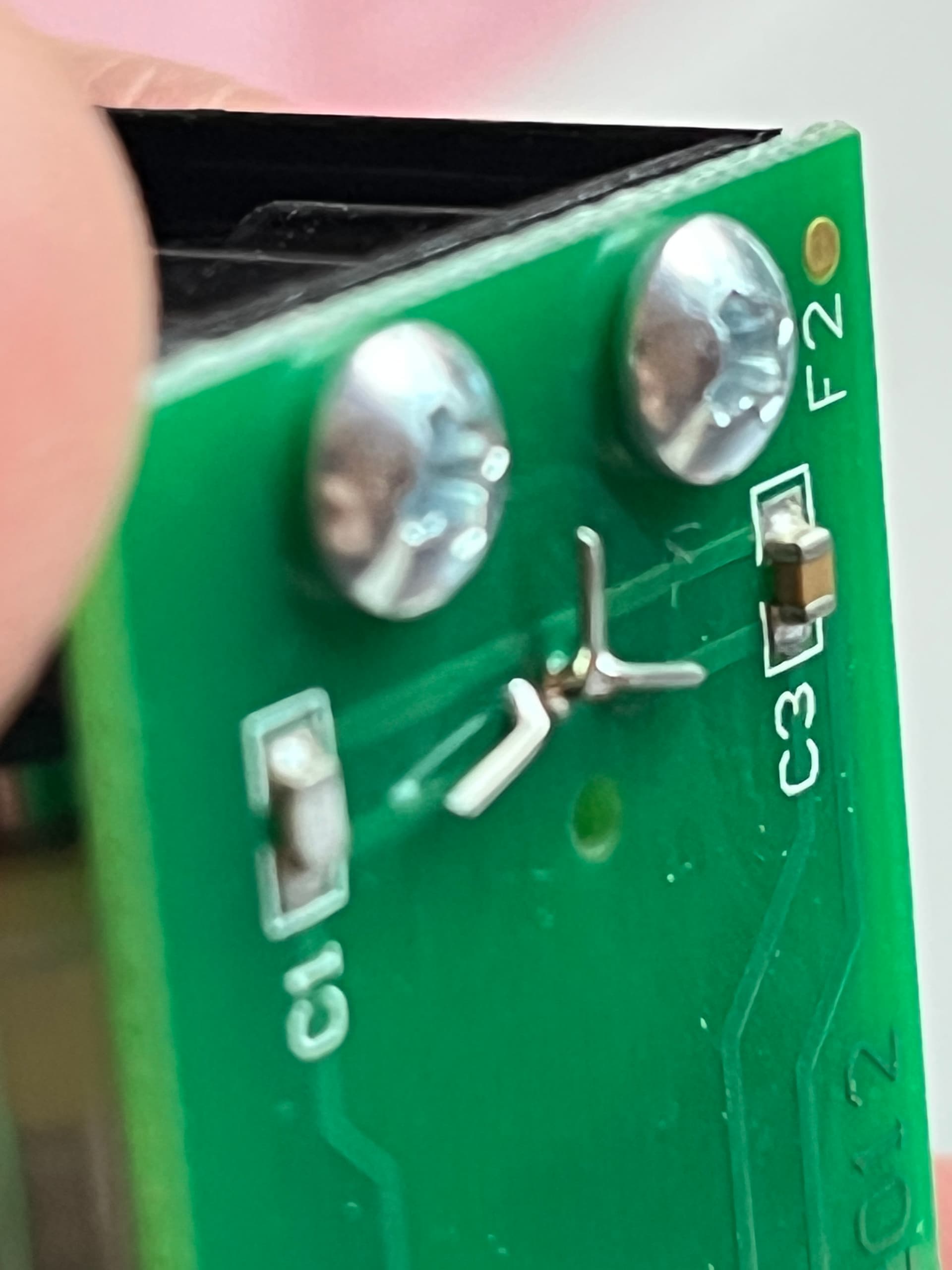

Ok, finally received the fader and after zooming in with my phone to take some pics, it looks like it's an Allegro A1324:

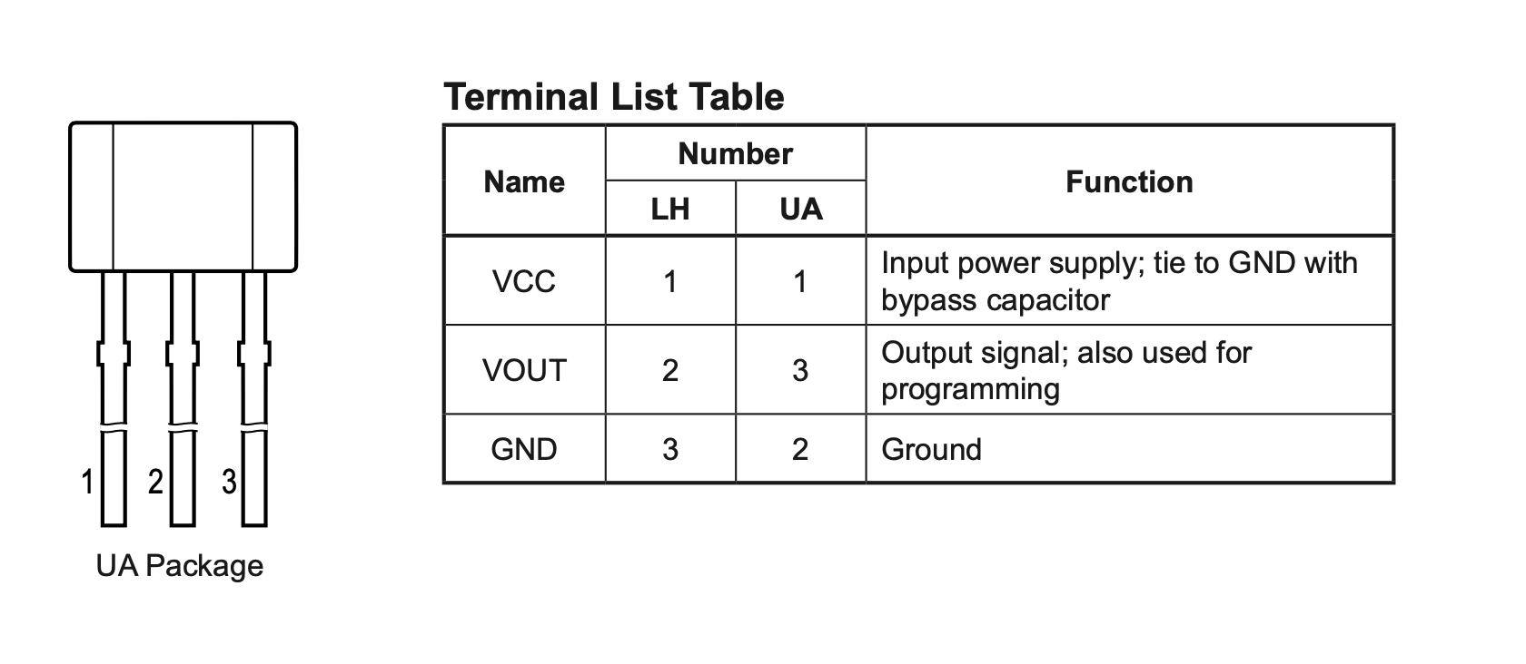

The wiring of it looks pretty straight forward in the datasheet:

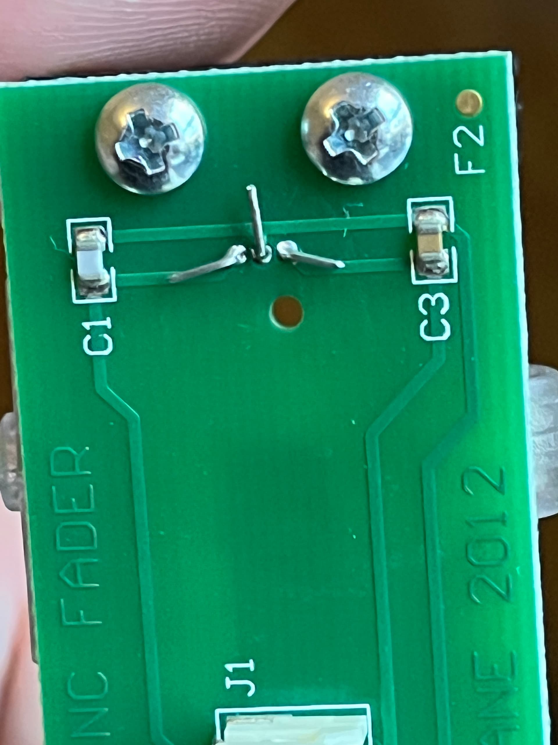

On the bottom of the board there are two caps:
I've no idea what the values are as I don't really work with SMT packages too much, but I'm guessing the values are appropriate to the bypass cap called for. It does seem odd that it's two separate caps also bridging with the output pin:
It's a bit hard to see without snipping the pins, but it looks like the top trace connects to the middle pin.

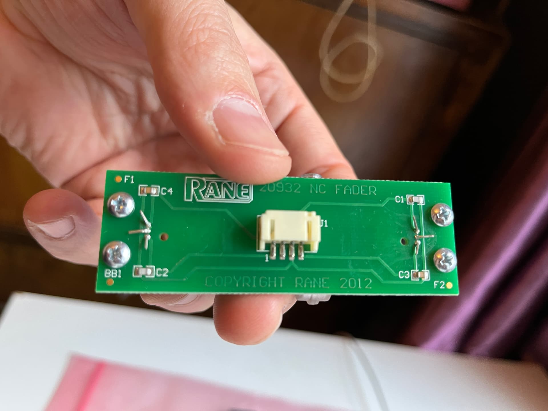

Then all of the pins come to a 4-pin breakout:
I'm assuming these would represent VCC, GND, and VOUT1 / VOUT2, but it's hard for me to tell from the pic which is which. It also looks like the output pins from the hall sensors only get there from being bridged across C2/C4 and C1/C3 respectively. I would assume pin3 of the output is either GND or VCC as it clearly goes to both sides. Holding it up to the light there's a couple traces on the other side and/or connecting to some of the output pins:
Or is supposed to, but the soldering looks highly suspect!
Hehe, with the bent and un-snipped pins, it is definitely on the casual side of a production PCB.

When decoupling a supply it is normal to have two capacitors, a large one to handle low frequency interference and a small ceramic one to handle high frequency interference.
The thing is that surface mount capacitors do not have a value printed on them so you can't tell the value. However it is clear from your photograph that the two are different. I suspect the right hand one is the small ceramic capacitor. The left one could also be ceramic but it has an unusual look to it if it is.
