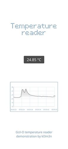

EPISODE 1: TEMPERATURE READER
I will be using a thermistor to read and display the ambient temperature. The display will show the current ambient temperature and ambient temperature over time using a graphical representation.
I will be using GUI-O IoT (MQTT) connection, but the example can be easily be ported to other connection types.

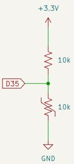

1. CONNECT THE COMPONENTS
Connecting the components is straightforward. The "D35" is one of the ADC1 pins on ESP32 (note that ADC2 pins are not available when WiFi is enabled).

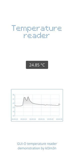

Make sure that the GUI-O application is connected to the MQTT server.
Also make sure that the ESP32 board (or other Arduino supported board) is connected to the MQTT server (you can check this by observing the serial debug messages using the Arduino serial monitor).
Press the Initialize button (see image below) from the GUI-O application home screen.
5. THE RESULT
Image below shows the result (screen capture) on my Android device after pressing the "Initialize" button. The label and chart are updated every time the ESP32 board calculates the temperature and publishes new data to the MQTT server.

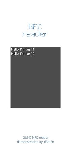

EPISODE 3: NFC READER
I will be using Android builtin NFC reader to read text records of NFC tags. The text records will be displayed in a scroll-able text widget.
I will be using GUI-O Bluetooth SPP connection, but the example can be easily be ported to other connection types.
Software prerequisites:
Components needed:
  • ESP32-WROOM-32 (or any other Arduino supported Bluetooth capable board)
The entire tutorial is split into various steps. All necessary information is given in each step.
0. DESIGN THE GUI (optional)
The best way to create a GUI layout is to use GUI-O live designer tool.
Note that the Arduino source code already includes the necessary commands, so this step is not needed, unless you want to make some visual adjustments. If you make adjustments, please include the generated ASCII code in the Arduino source code (see section 1. UPLOAD THE SOURCE CODE).
First, you need to establish a TCP/IP connection between the designer tool and GUI-O application:
  1. Determine the local IP address of your PC's network interface (WiFi or Ethernet)
  • Under Windows, open the command prompt, enter ipconfig and press Enter
  • Under Linux, open the terminal, enter ifconfig and press Enter
  1. Open GUI-O application and open settings menu. Select "Connections -> Ethernet" and create a new device with IP address (determined from 1.) and any port between 49152 - 65535
  2. Open GUI-O designer and select "TCP/IP connection" tab. Set the IP address and port. Both values must match the device settings created within the GUI-O application. Click "Start server" button.
  3. Within the GUI-O application, tap the created device and wait for successful connection.
  4. In the GUI-O designer, select "File -> Load designer file" and load the NfcReader.gdf design file. Make the desired adjustments, if necessary. Copy / replace the GUI-O commands into the Arduino source code (see section 1. UPLOAD THE SOURCE CODE).
The source code has inline comments, describing the important parts of the code. You can copy the source code from the snippet below, or download it here.
Upload the code to your board (make sure that the correct board and upload port are selected). Reset the board after upload.
 * GUI-O NFC reader Bluetooth example (using ESP32-WROOM-32)
 * Copyright (C) 2022, kl3m3n
 * last updated on 5.11.2022
 * SPDX-License-Identifier: BSD-3-Clause
#include "BluetoothSerial.h"
// if not enabled, the SDK must be recompiled
#if !defined(CONFIG_BT_ENABLED) || !defined(CONFIG_BLUEDROID_ENABLED)
#error Bluetooth is not enabled! Please run `make menuconfig` to and enable it
#endif
// forward declare parser for incoming messages
void parseGuioMsg(const String &msg);
// icoming data buffer
String in;
// global
BluetoothSerial btSerial;
  // debug output
  // setup bluetooth serial
  btSerial.begin("NFCReaderBluetooth");
  Serial.println("Bluetooth ready to pair!");
  while(btSerial.available()) {
    const char c = btSerial.read();
    in += c;
    if(c == '\n') {
      // parse message string
      parseGuioMsg(in);
      // clear buffer
      in = "";
void sendMsg(const String &msg) {
  btSerial.write((const uint8_t*) msg.c_str(), msg.length());
void parseGuioMsg(const String &msg) {
  if(msg.startsWith("@init")) {
    Serial.println("GUI-O app is requesting INITIALIZATION!");
    // clear screen, hardware and set background
    sendMsg("@cls\r\n");
    sendMsg("@clh\r\n");
    sendMsg("@guis BGC:#FFFFFF\r\n");
    delay(100);
    // initialize GUI
    sendMsg("|LB UID:title X:50 Y:20 FSZ:4 FFA:\"font8\" TXT:\"NFC<br>reader\"\r\n");
    sendMsg("|TA UID:nfcOutput X:50 Y:50 W:70 H:40 FSZ:2 FGC:#FFFFFF\r\n");
    sendMsg("|LB UID:details X:50 Y:90 FSZ:2 TXT:\"GUI-O NFC reader<br>demonstration by kl3m3n\"\r\n");
    // initialize NFC hardware
    sendMsg("|NFC UID:nfc HID:nfc SEN:1\r\n");
  else if(msg.startsWith("@nfc")) {
    const auto idx = msg.indexOf(' ');
    if(idx > 0) {
      String txt = msg.substring(idx + 1); txt.trim();
      // display NFC (text) record
      sendMsg("@nfcOutput TXT:\"" + txt + "\"\r\n");

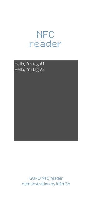

2. ESTABLISH CONNECTION
Make sure that the ESP32 board is ready for pairing (you can check this by observing the serial debug messages using the Arduino serial monitor).
Open GUI-O application and navigate to settings menu. Select "Connections -> Bluetooth and IoT" and search for devices (enable Bluetooth and Location services, if prompted). Tap on the "NFCReaderBluetooth" device and wait for successful connection (confirm device pairing if prompted).
Close the settings menu and press the Initialize button (see image below) from the GUI-O application home screen.
3. THE RESULT
Image below shows the result (screen capture) on my Android device after pressing the "Initialize" button and scanning two different NFC tags (I added some arbitrary text records using a third-party application).
Note that if code "-2" is displayed after pressing the "Initialize" button, the NFC is available, but is not enabled. In this case you should enable NFC through Android system settings. If code "-1" is displayed, your device does not support NFC.
If you have any questions or run into any problems, please let me know!
Best regards,
kl3m3n

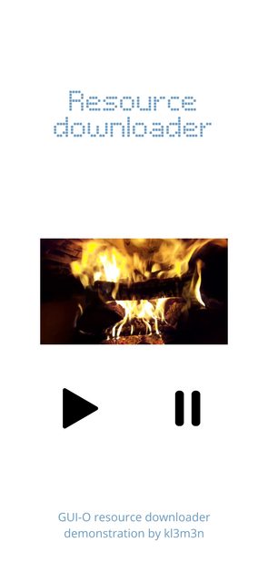

EPISODE 4: RESOURCE DOWNLOADER
This is a simple example that shows how to download videos and images from online resources, which can be incorporated into any application.
Components needed:
Note that the Arduino source code already includes the necessary commands, so this step is not needed, unless you want to make some visual adjustments. If you make adjustments, please include the generated ASCII code in the Arduino source code (see section 3. MODIFY AND UPLOAD THE SOURCE CODE).
  4. In the GUI-O designer, select "File -> Load designer file" and load the ResourceDownloader.gdf design file. Make the desired adjustments, if necessary. Copy / replace the GUI-O commands into the Arduino source code (see section 3. MODIFY AND UPLOAD THE SOURCE CODE).
1. CREATE A UNIQUE MQTT CHANNEL
Open GUI-O application and navigate to settings menu. Select "Connections -> IoT" and add a new device. After adding the device, note the In and Out token (you can share this tokens e.g., to your e-mail by pressing the "share" button).
Finally, press "Connect" menu entry to establish the connection with the MQTT server.
2. MODIFY AND UPLOAD THE SOURCE CODE
The only thing that needs to be done is to set the ssid and password of your router and the unique In and Out channels that were generated by the GUI-O application (see section 2. CREATE A UNIQUE MQTT CHANNEL).
After setting these values, upload the code to your board (make sure that the correct board and upload port are selected). Reset the board after upload.
 * GUI-O Resource downloader MQTT example (using ESP32-WROOM-32)
 * last updated on 12.11.2022
#include <WiFi.h>
#include <PubSubClient.h>
static const char *ssid = "<ssid>"; // router name
static const char *pass = "<pass>"; // router password
static const char *mqttServer = "mqtt.gui-o.com";   // host name
static const char *mqttUser = "gui-o-mqtt-generic"; // user name
static const char *mqttPass = "lqXeZpv5VJyv0XBT";   // password
// IMPORTANT NOTE: if optional user name was specified when adding a new IoT device,
// the user name should also be included when setting the topics (e.g., "xxxxxxxx-xxxx-xxxx-xxxx-xxxxxxxxxxxx/<user_name>")
static const char *Out = "<Out>"; // GUI-O app publish topic
static const char *In = "<In>";  // GUI-O app subscribe topic
// mqtt client
WiFiClient wiFiClient;
PubSubClient mqttClient(wiFiClient);
// forward declare functions for mqtt messages handling
void mqttCallback(char* topic, byte* message, unsigned int length);
  // debug output
  // connect WiFi (keep trying...)
  Serial.print("Connecting to ");
  Serial.println(ssid);
  WiFi.begin(ssid, pass);
  while(WiFi.status() != WL_CONNECTED) {
    Serial.print(".");
  Serial.println("WiFi connected!");
  // setup mqtt
  mqttClient.setServer(mqttServer, 1883);
  mqttClient.setCallback(mqttCallback);
  while(!mqttClient.connected()) {
    Serial.println("MQTT connecting...");
    // mqtt client id is the mac address (AABBCCDDEEFF)
    char mqttClientId[15];
    uint8_t mac[6];
    WiFi.macAddress(mac);
    snprintf(mqttClientId, sizeof(mqttClientId), "%02x%02x%02x%02x%02x%02x", mac[0], mac[1], mac[2], mac[3], mac[4], mac[5]);
    if(mqttClient.connect(mqttClientId, mqttUser, mqttPass)) {
      Serial.println("MQTT connected!");
      mqttClient.subscribe(&Out[0]);
    else {
      Serial.print("MQTT connection failed (");
      Serial.print(mqttClient.state());
      Serial.println(")! Retrying...");
      delay(2500);
  mqttClient.loop();
// mqtt callback function
void mqttCallback(char* topic, byte* message, unsigned int length) {
  // build message string
  String msg;
  for(int i = 0; i < length; i++) {
    msg += (char) message[i];
  parseGuioMsg(msg);
    // clear screen and set background
    mqttClient.publish(&In[0], "@cls\r\n");
    mqttClient.publish(&In[0], "@guis BGC:#FFFFFF\r\n");
    delay(100);
    // initialize GUI
    mqttClient.publish(&In[0], "|LB UID:title X:50 Y:20 FSZ:4 FFA:\"font8\" TXT:\"Resource<br>downloader\"\r\n");
    mqttClient.publish(&In[0], "|VI UID:fire X:50 Y:50 W:70 VP:\"https://i.imgur.com/lVwrTnZ.mp4\"\r\n");
    mqttClient.publish(&In[0], "|IM UID:play X:30 Y:70 W:15 IP:\"https://i.imgur.com/Gs2ERbO.png\"\r\n");
    mqttClient.publish(&In[0], "|IM UID:pause X:70 Y:70 W:15 IP:\"https://i.imgur.com/FXywHFH.png\"\r\n");
    mqttClient.publish(&In[0], "|LB UID:details X:50 Y:90 FSZ:2 TXT:\"GUI-O resource downloader<br>demonstration by kl3m3n\"\r\n");

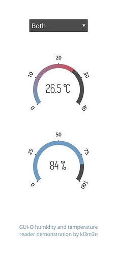

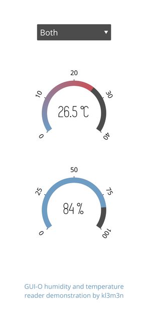

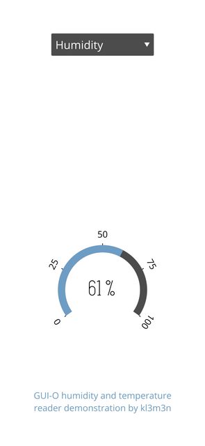

5. THE RESULT
Images below shows the result (screen capture) on my Android device after pressing the "Initialize" button. The humidity and temperature indicators are updated every 2 seconds. The visibility of indicators can be controlled via the drop-down box widget.

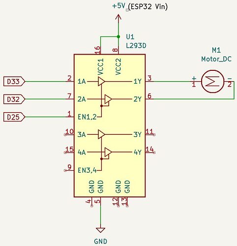

EPISODE 8: DC MOTOR CONTROL
I will be using a dedicated motor driver IC to control the direction and speed of a DC motor via a virtual joystick widget.
I will be using GUI-O Bluetooth Low Energy (LE) connection, but the example can be easily be ported to other connection types.
Components needed:
  • ESP32-WROOM-32 (or any other Arduino supported Bluetooth Low Energy capable board)
  • L239D motor driver
  • Small DC motor
  4. In the GUI-O designer, select "File -> Load designer file" and load the MotorControl.gdf design file. Make the desired adjustments, if necessary. Copy / replace the GUI-O commands into the Arduino source code (see section 1. UPLOAD THE SOURCE CODE).
Connecting the components is straightforward. "D25" pin is used to set the motor speed (via PWM output), while pins "D33" and "D32" are used to control the motor direction.
2. UPLOAD THE SOURCE CODE

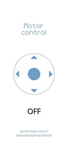

4. THE RESULT
Image below shows the result (screen capture) on my Android device after pressing the "Initialize" button. Motor direction and speed is controlled by the virtual joystick position (only in horizontal direction). If the joystick is pushed all the way to the right (or left), the speed of the motor is at its maximum. When in this position, pushing the joystick up or down decreases the speed of the motor.

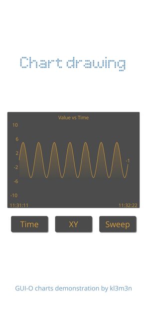

EPISODE 13: Drawing charts
This episode shows the different chart types that are supported by GUI-O application:
  1. Time chart
  2. XY chart
  3. Sweep chart
All charts are highly customizable.
Components needed:

3. ESTABLISH CONNECTION
4. THE RESULT
Images (and video) below show the result (screen capture) on my Android device after pressing the "Initialize" button and selecting Time, XY and Sweep, respectively. The active chart is updated every time the ESP32 board published new data to the MQTT server.

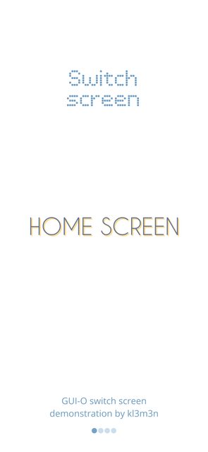

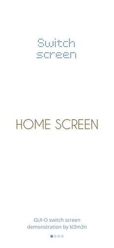

Open GUI-O application and press Add in the upper-right corner of the home screen. Tap on Bluetooth LE and search for devices (enable Bluetooth and Location services, if prompted). Tap on the "SwitchScreen" device, select Nordic UART service and wait for successful connection (confirm device pairing if prompted).
3. THE RESULT
Image below shows the result (screen capture) on my Android device after pressing the "Initialize" button. The bottom screen indicator indicates the number of screens and the currently active screen. Navigation between screens is possible by flicking left or right at the bottom of the screen. This is shown in the video below.
