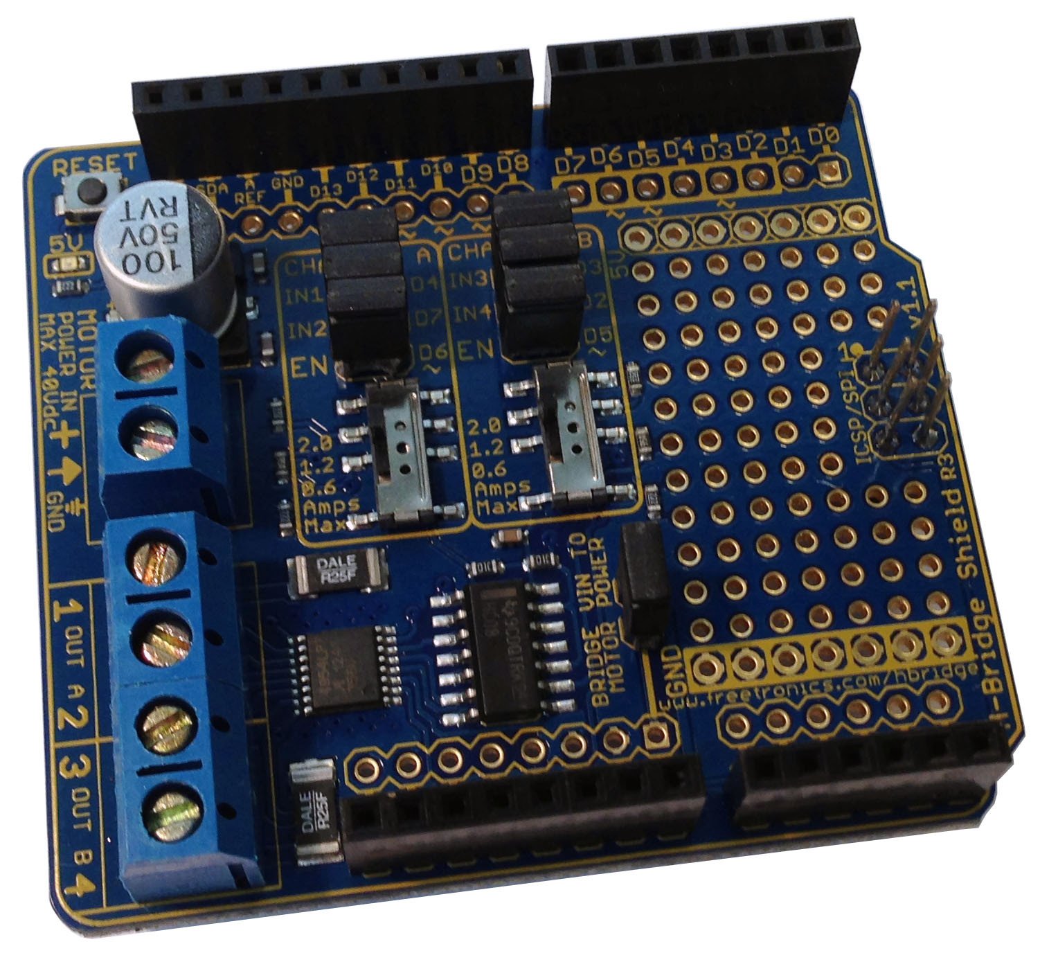

Hi guys, I am testing my Freetronics 2-Channel H-Bridge Shield with a simple example code on my Uno clone. I have tried powering the set up with both 8v and 11v power supplies and both show the same results. When under no load, the output channel measures the full 8v or 11v, but as soon as my 8v motor is connected, the voltage drops to 0.1-0.3v. Any guidance on this is highly appreciated.
Thanks in advance

The shield looks like it can supply max 40v and 2A
The page for the motor driver shield is below:
If the motor winding is 1 ohm, then yes the startup current is 8A, and a 2A controller would not cope (unless somewhere in the docs it says the controller has a higher limit for short spikes like at startup.)
