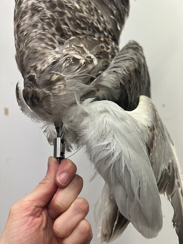

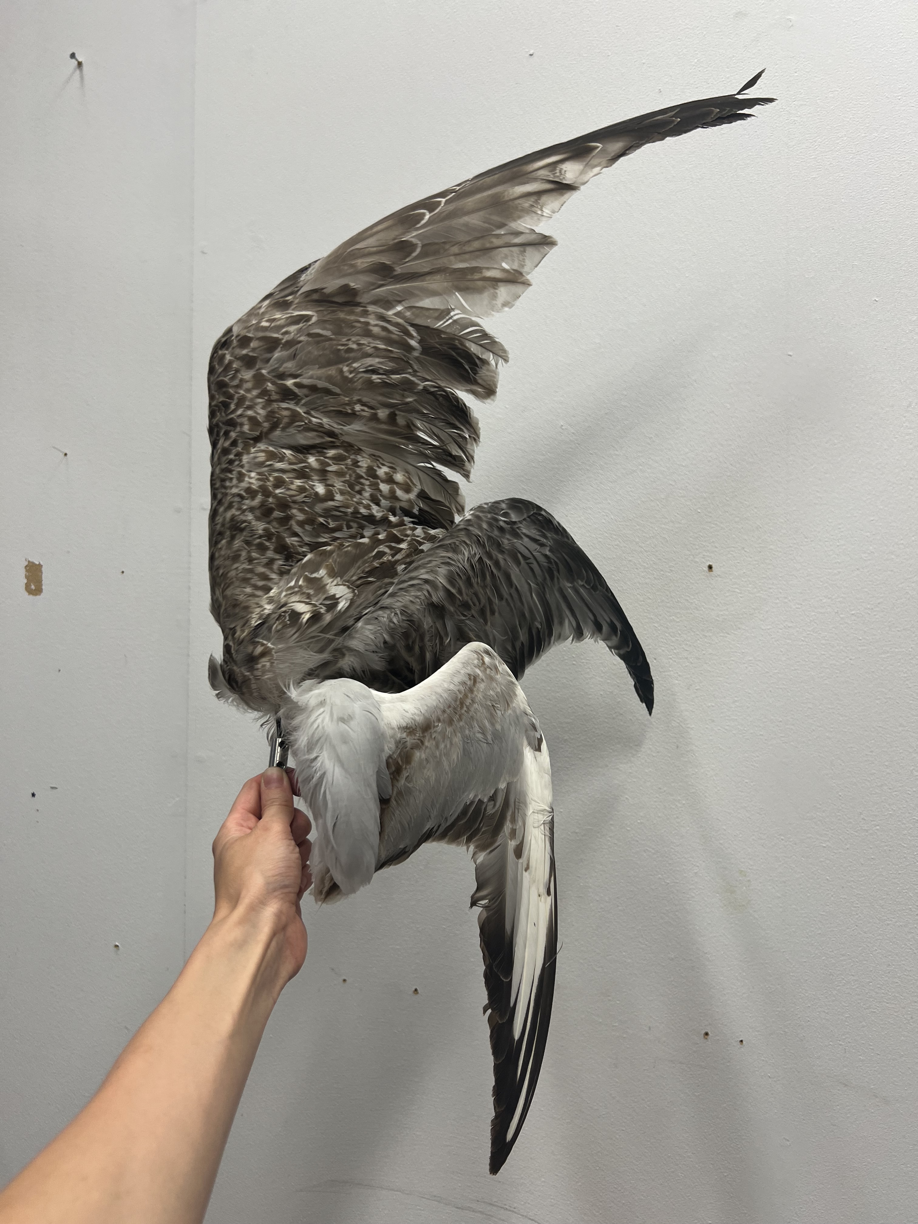

Hi, I’m an artist working with bird wings that I connect to servos, making them move again. I control them with arduino nano copy and homemade shield. Right now I have a wing weighing about 150g being 80 cm long that I attach to the servo from the bottom. I gave ChatGPT a go at calculating and suggesting a suitable servo and gave me Hitec HS-645MG which turned out too weak. I have a budget for more expensive, I just don’t want to hunt any longer. What should I think about and do you have any suggestions?

Looking at your picture, the center of mass is likely close to the Servo.
You could approximate everything and say the wing is like a 150g mass at say 30cm of the servo.
The force exerted F is the mass x gravity = 0.15 kg x 9,81ms-2 = 1,4715 Newton
The torque required to lift the weight can be calculated using the formula F x distance, so 1,4715N x 0.3m = 0,44145 Nm or in units you usually find for servos, 4.5 kg.cm (0.15kg x 30cm)
Your Hitec HS-645MG offers 9.6kg.cm under 6V so it should be plenty unless there is something else at play.
A possible issue is that it's challenging to model the wing as a simple weight force applied at the center of mass because the weight distribution is uneven; for instance, there may be more weight at the front of the wing compared to the rear. This uneven distribution can create a torque that causes the wing to attempt to rotate around the pivot point, exerting pressure on the axis and the shaft, which may lead to friction that hinders the proper functioning of the servo.

The servo is moving the wing, but it's not smooth and it's clearly too heavy at critical points when it's fighting gravity on it's way down and up again. It's definitely unevenly balanced, I've been thinking about adding weights to the other side to make the pivot point closer to the center. Would that make any difference?

Yes it would make it worse
It should be 5 or 6V and at least 3A
The further away from the servo the center point is and the heavier the wing is, the more torque you need …
So no don’t add weight.
Yes, do add counterweights on the other sid if you can. If your application and space permits then counterweights on the opposite side of the pivoting servo shaft as versus the side the wing is on can cancel out almost all the torque needed to lift the wing against gravity. The only torque the servo then needs to provide is enough to handle the peak acceleration you want the wing to achieve. Where they can physically be eprmited counterweights are very effective.

The key is in ‘if you can’. I don’t think it’s possible.
There is no other side according to the pictures… the servo is at one end of the wing where the articulation with the body is. The bird’s body should stay where it is when the wings flap and both wings go up and down at the same time so you can’t tie them so that one would act as the counterweight for the other.
