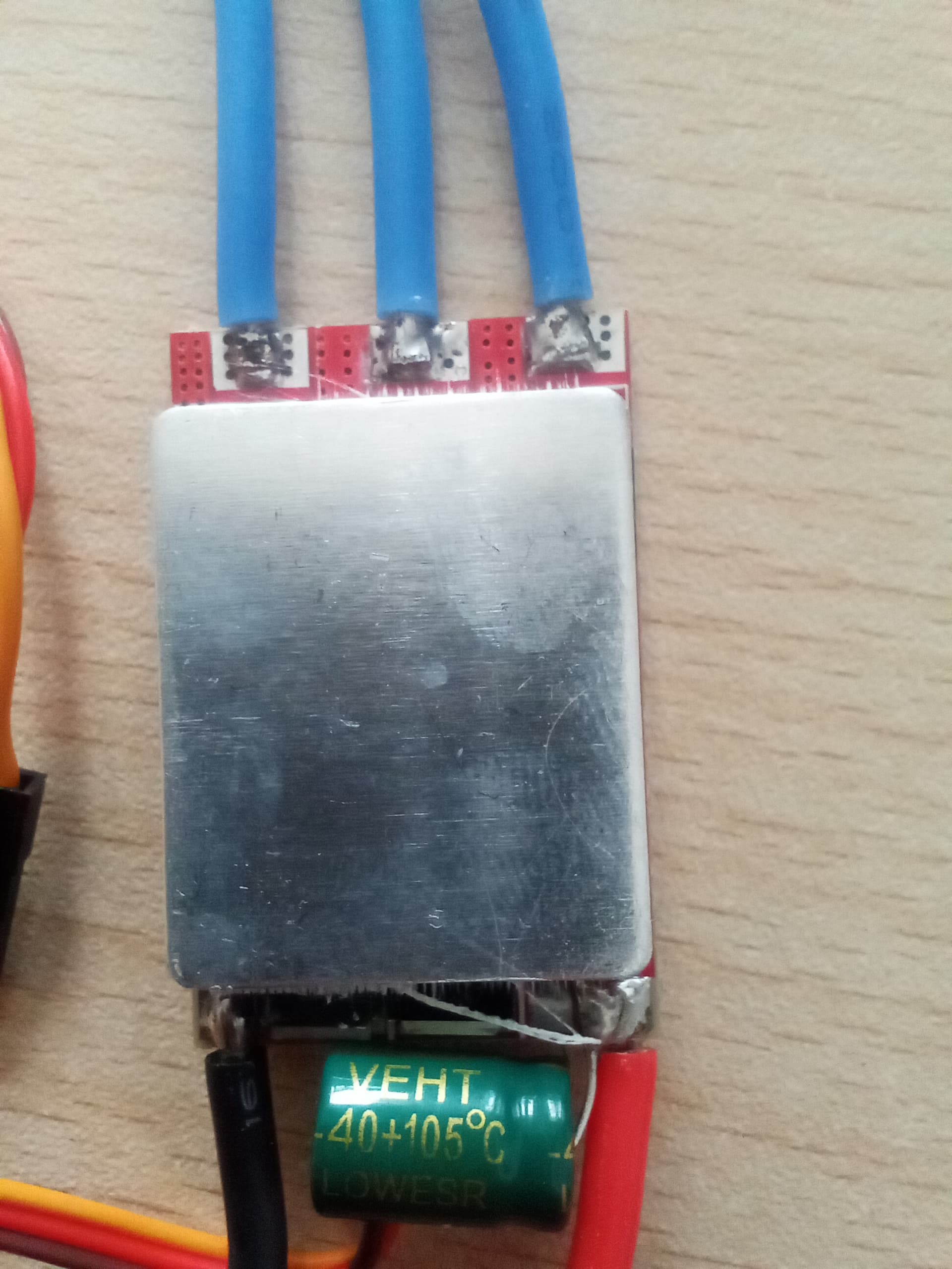

I bought this 30A ESC
so i could use it to control brushless motors of this manipulator robot,
but the the problem is that i don't know if you could use it to reverse.
I tried looking for type of chip it uses so i could install a new firmware but it's scratched/ hidden.
It sounds like you know what you are doing. The only idea I have is to try the better known configurators and see if any of them recognize the device and allow setting it differently or uploading new firmware.
After that fails, you could start with the better known stick gestures used for calibration and in some cases allowing parameters to be changed, however slightly.
On a time = money basis, you would probably win by tossing this and buying a new unit from a reputable dealer so you know you have BLHeli 30A 6s ESC, or whatever.
And get back to having the kind of fun you really want to. :expressionless:

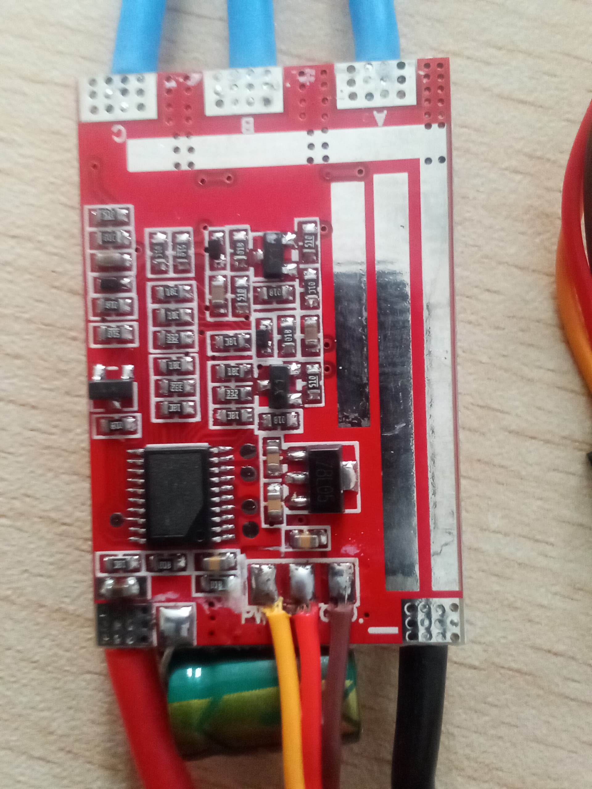

I bet it is a Nuvoton N76E003
the programming pads give it away.
In your picture:
On the left side the pad to pin 18 is ICPCK (clock)
on the right side the pad to pin 9 is VDD, to pin 8 is ICPDA (data), to pin 4 is RST (reset) and the last pad is GND.
You will need a Nu-Link programmer to program it.
(Datasheet Apr. 21, 2022 Page 257 of 278 Rev. 1.10)

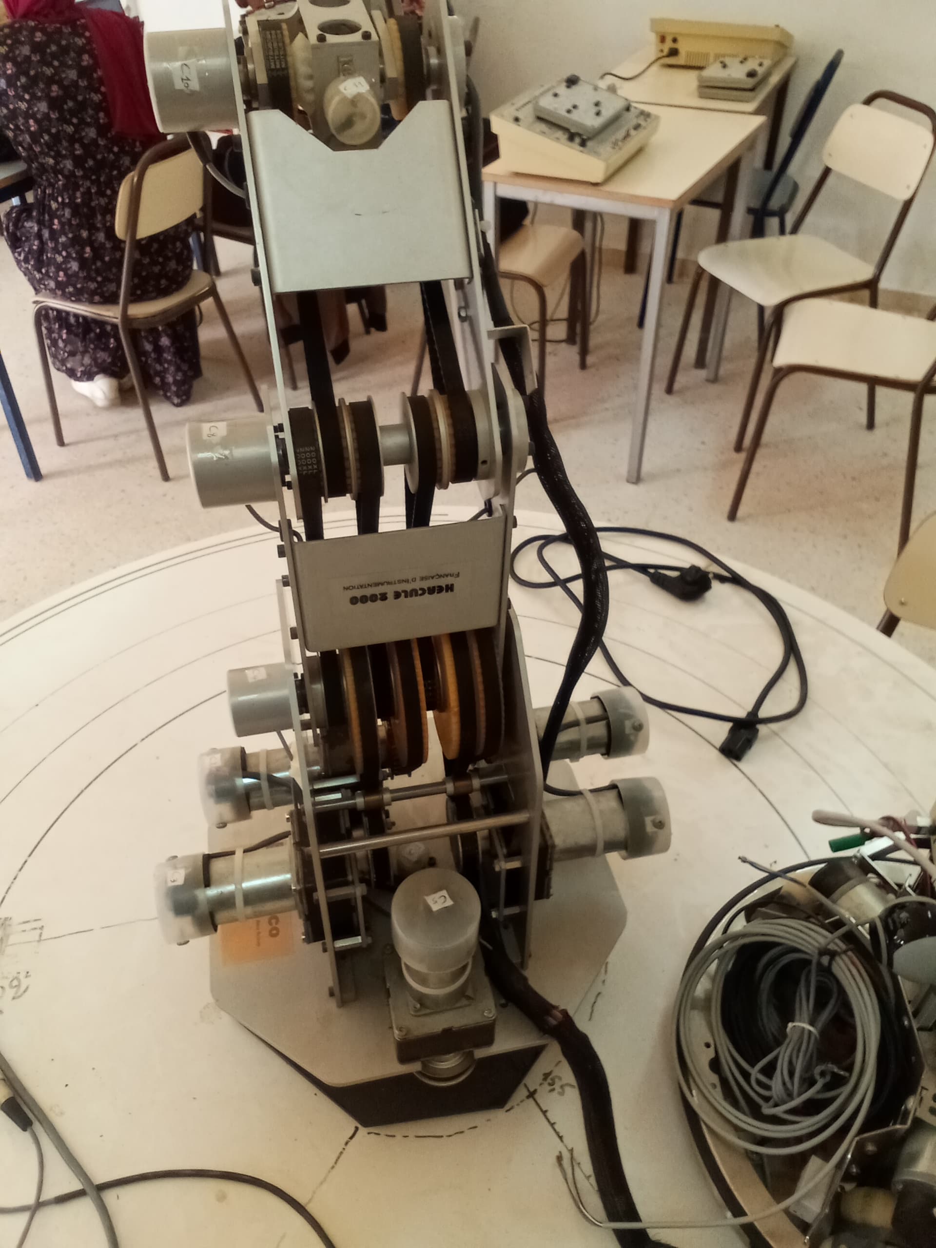

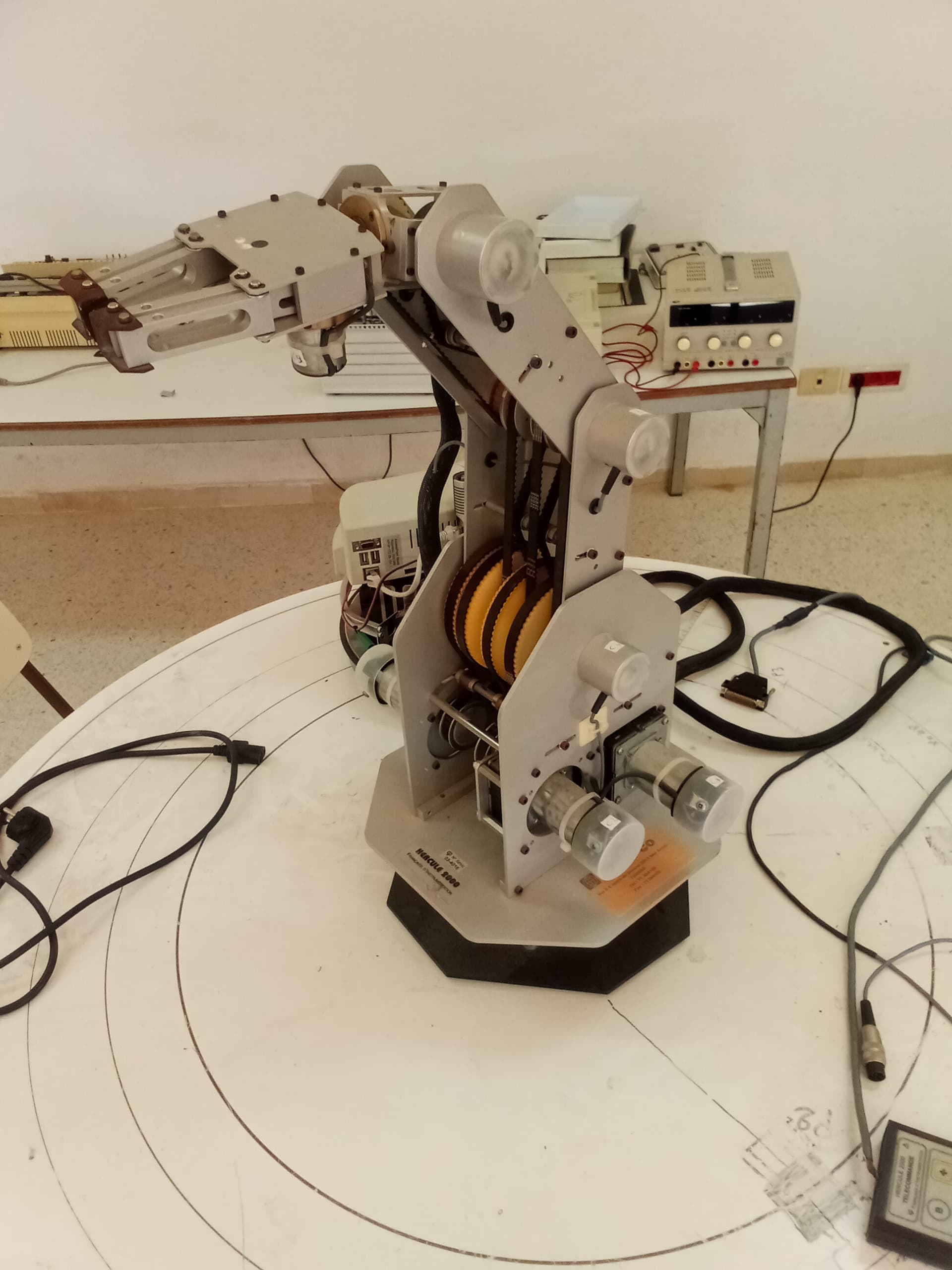

Its part of my end of year project :
Theres an old arm manipulator in our university (Since 2003/2004 i think) that stopped working years ago and apparently the professors told me that the circuit boards in the control box are either missing some parts or the whole board (there was like 5 or 6 circuit boards inside the control box).
So my job is to replace the old control box with a raspberry pi to control the movement of the arm and also add a web interface to control it locally.
When i asked about a technical documentation all they had is some papers that has instructions on how to use it, not the details about parts that i wanted.
Heres the documentation if you want to read it (it's in french because it's from a french company):
In the documentation it said "The actuators are DC motors" :

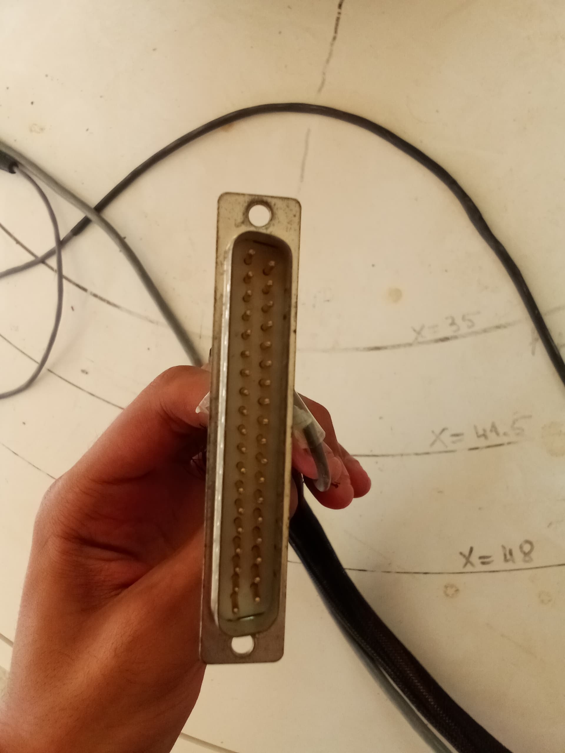

From what i counted theres 11 motors
and the cable that connects the robotic arm to the control box has way too many cables for a normal dc motor (11*2 =22 cables) so i assumed it would be a brushless DC motor because they are the the only other DC motor that fits the description.
Also i tried looking for the original company online but apparently they changed type of product they sell or make ?
Tried also contacting them but no response.
Looked online for the same robot but only result i found is from old website with programming language i couldn't understand ( help me if you could recognize what programming language that is ) :
http://www.metz.supelec.fr/metz/recherche/ersidp/Software/Nono/Hercule.html
There are many types of dc motor therefore your assumption is incorrect.
My original suspicion was that they are stepper motors. Some have 4 wires, some 5 and others 6.
This probably explains the cable numbers you refer to.
If you look at the cabling coming from each motor it might give a clue, better still any details printed on the motors.
Then again, they might be geared dc motors with encoders run on the back of each. If the encoders are quadrature, then even more cabling to track direction as well as distance.
Biggest hurdle is it's a discontinued item with zero follow up specs or details.
Wouldn't surprise me if they went down the gurgler.
Googled "hercule 2000".....zero, zilch, nothing.
From the pics, I think it's a mix of motors with encoders, plus extra encoders "potentiometers de recopie"=feedback potentiometers(?) on several joints. Maybe the actuator doesn't need an extra encoderpotentiometer, so the 6DOF arm could use 6 motors and 5 encoderspotentiometers = 11 motorish-looking things that combine into 5 servos + one actuator.
