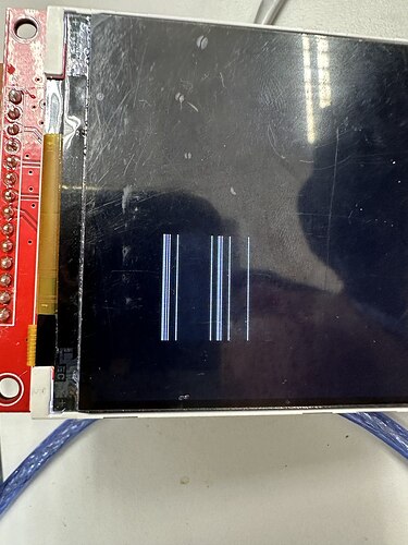

Help with displaying bitmap on Tft screen using LCDWIKI_GUI
Hi everyone, new to this forum. Would like to ask for help on how to display bitmap on tft screen. I have a 90x90 Jpeg image which I converted using LCD image converter and copied the bitmap into a .h file as shown below. After that, i tried using LCDWIKI_GUI draw_bit_map but was not able to display anything on the image. I also tried a similiar code written by david_prentice but we just get gibberish displayed on the tft. Could anyone help with this? Am I doing anything wrong? Been stuck with this for a week:(

LCDWIKI_SPI my_lcd(ILI9488_18, CS, CD, RST, LED);

void setupLCD() {
  my_lcd.Init_LCD();
  my_lcd.Set_Rotation(4);
  my_lcd.Fill_Screen(0x0000);
void setup(){
  setupLCD();
  drawBitmap(50, 50, flowrate, 90, 90, BLACK, WHITE);
void showbgd(int x, int y, const uint8_t *bmp, int w, int h, uint16_t color, uint16_t bg, uint8_t pad = 7)
    int yy, xx;
    uint8_t first = 1, RVS = pad & 0x80;
    uint16_t pixel;
    pad &= 3;
    uint16_t wid = (w + pad) & ~pad;                    //bits per row
    //tft.setAddrWindow(x, y, x + w - 1, y + h - 1); //
    my_lcd.Set_Addr_Window(x, y, x + w - 1, y + h - 1); //
    for (yy = 0; yy < h; yy++) {
        uint32_t ofs = yy*wid; //bit offset
        const uint8_t *p = bmp + (ofs >> 3);            //flash address
        uint8_t mask = 0x80;               //bit mask
        uint8_t c = pgm_read_byte(p++);
        for (xx = 0; xx < w; xx++) {
            if (mask == 0) {
                mask = 0x80;
            pixel = (c & mask) ? color : bg;
            //tft.pushColors(&pixel, 1, first);
            my_lcd.Push_Any_Color(&pixel, 1, first, 0);
            first = 0;
            mask >>= 1;
    //tft.setAddrWindow(0, 0, tft.width() - 1, tft.height() - 1);
   my_lcd.Set_Addr_Window(0, 0, my_lcd.Get_Width() - 1, my_lcd.Get_Height() - 1);
void drawBitmap(int16_t x, int16_t y, const uint8_t bitmap[], int16_t w, int16_t h, uint16_t color, uint16_t bg)
    showbgd(x, y, bitmap, w, h, color, bg, 0);
Trying to display this image
flow rate
But got this instead
  • Is "bitmap" the image name in flowrate.h?...
  • show flowrate.h
  • have you looked in the library examples folder?
  • use image2cpp to get the bitmap...
