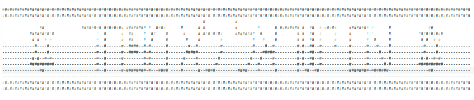

I modified it to use dashes and hashtags based on the previous messages I saw on this thread. Here is the actual text of it:
My mom wants to make this for some family friends. They are lyrics to a song that she wants to show, not just displaying this on the matrix but as lyrics that move across the slideshow. I guess I can just make 157 frames and have a for loop of an array that just displays the next frame but that seems like a big waste of time. Also don't know anything about memory that was also mentioned here. I am using an Arduino Uno but can upgrade to an Arduino Mega if I need to. Can anybody help me make this into a slideshow for my LED matrix?

  • Your banner of ascii-text is 189 x 14 (cols x rows) = 2646 characters
  • I think the size was intended to be 192 x 16 = 3072 for even multiple of 16
  • 192x16 pixels will fill five 32col x 16row (512 pixel) panels

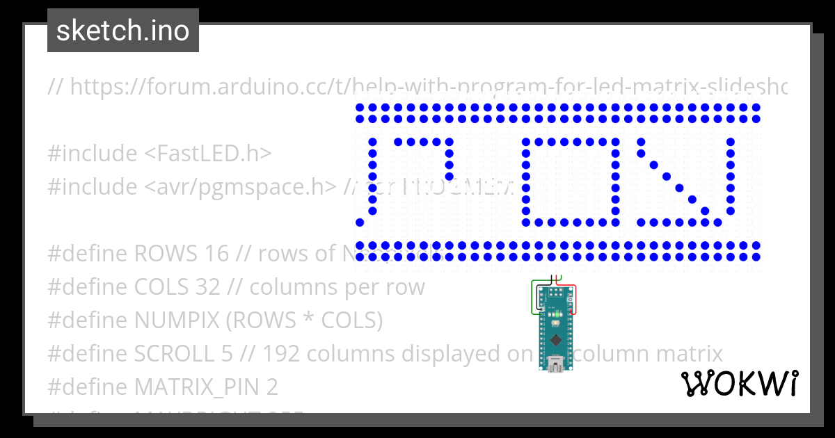

Here is your banner in a simulation...
Here is the sketch for your banner...

... AND... it fits on a Nano!
Sketch uses 7766 bytes (25%) of program storage space. Maximum is 30720 bytes.
Global variables use 1812 bytes (88%) of dynamic memory, leaving 236 bytes for local variables. Maximum is 2048 bytes.

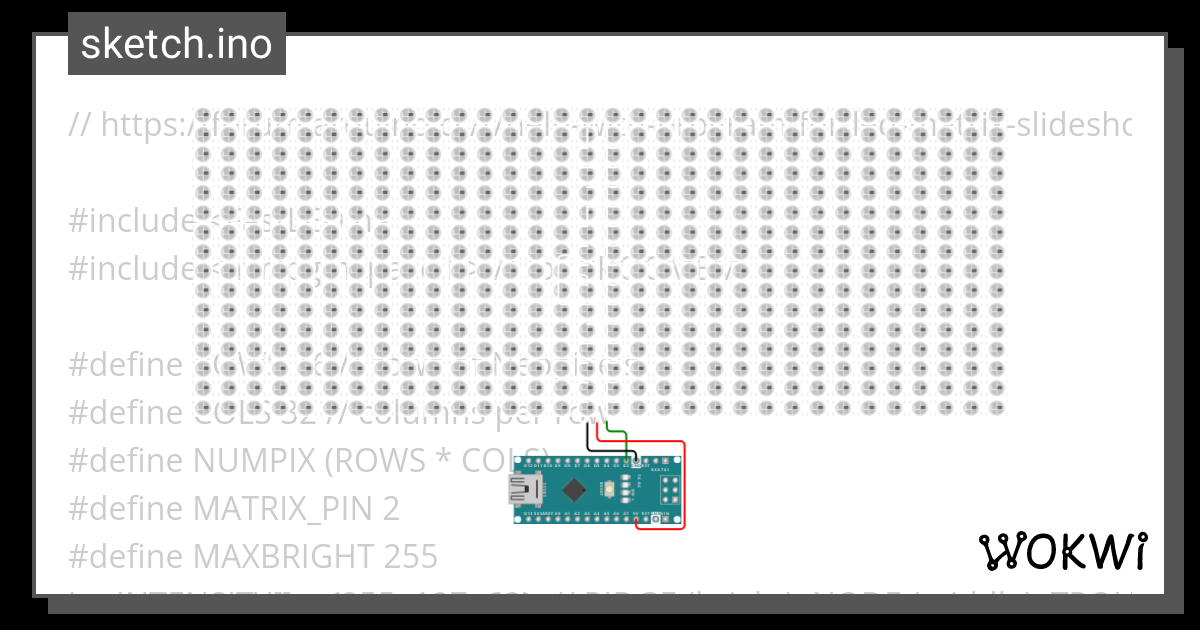

If you click the link to the simulation and press the green button with the white ">" , you can see the five pages of the first banner you made... reading right to left.

Only two lines changed from page-flipping to scrolling "x" pixel columns each step, but the change caused the loss of a necessary "multiplication by zero" (COLS was my 0) to start on the LAST page (left-most), rather than the first (right-most). You can see the green pixels show "start=lower right pixel" and "stop=lower left pixel"... This is my inwork-copy, so the original still works as a page flipper. I won't move this copy to the working original until I figure out my multiplication problem.
** IN-WORK COPY- NOT WORKING **

  "-----------##########------------------#--#------#--##----#--##----#------#-----#-########-----########--#-----#--------#-#--##--#-----#-----#------#-#------#-------------##########-----------" // ROW  5
  "------------#-#--#-#-------------------#--#------#--##----#--#-----#-------#----#--------#------------#---#----#--------#-#--##--#-----#-----#------#--#-----#--------------#-#--#-#------------" // ROW  6
  "-------------#----#--------------------#--#------#--####--#-#------#--------#--#---------#------------#----#--#---------#-#--##--#-----#-----#------#---#----#---------------#----#-------------" // ROW  7
  "-------------#----#--------------------#--#------#--####--#-#------#-------#####---------#------------#---#####---------#-#--##--#-----------#------#----#---#---------------#----#-------------" // ROW  8
  "------------#-#--#-#-------------------#--#------#--------#-#------#------#----#--------#------------#---#----#---------#-#--##--#-----------#------#-----#--#--------------#-#--#-#------------" // ROW  9
  "-----------##########------------------#--#------#--------#-#------#-----#-----#-------#------------#---#-----#---------#-#--##--#-----------#------#------#-#-------------##########-----------" // ROW 10
  "---------------##----------------------#--#------#-########-#---#### ----#------#--####---------####----#------#--------#--##--##------------########-#######------------------##---------------" // ROW 11
  "------------------------------------------------------------------------------------------------------------------------------------------------------------------------------------------------" // ROW 12
  "################################################################################################################################################################################################" // ROW 13
  "################################################################################################################################################################################################" // ROW 14
  "%----------------------------------------------------------------------------------------------------------------------------------------------------------------------------------------------%" // ROW 15
  FastLED.addLeds<WS2812B, MATRIX_PIN, GRB>(led, NUMPIX);
  FastLED.setBrightness(MAXBRIGHT); // brightness as needed
  FastLED.clear(); // clear pixel buffer
  FastLED.show(); // display cleared buffer
  // Serial.begin(9600);
  listOfFunctions(); // offload the list for a shorter setup() function
  showSong();
  // randomPixels();
void listOfFunctions() {
  //** TEST FUNCTIONS **
  // Serial.println(strlen(song)); // number of characters in the banner
  // serialSong(); // print banner (in PROGMEM) to serial monitor
  // randomSeed(analogRead(A0)); // increase randomness - not needed
  // fillByRowsCols();
  // fillByNumber();
  // showCorners(); // color corners of matrix
  FastLED.show(); // last function called for pixels to be displayed
void showSong() { // display text residing in PROGMEM
  int column = 0, row = 0, page = 0, asciiChar;
  for (int k = SCROLL; k >= 0 ; k--) { // read banner RIGHT to LEFT "SCROLL" size steps
    for (int i = 0; i < ROWS; i++) {
      for (int j = 0; j < COLS; j++) {
        // asciiChar = pgm_read_byte_near(song + (i * 192 + j) + (k * COLS)); // read 32 (chars), skip 192 (cols), repeat
        asciiChar = pgm_read_byte_near(song + (i * 192 + j) + k); // read 32 (chars), skip 32 (cols), repeat
        if (asciiChar == '-') // white
          led[i * COLS + j] =  CRGB(255, 255, 255); // WHITE
        if (asciiChar == '#') // blue
          led[i * COLS + j] =  CRGB(0, 0, 255); // BLUE
        if (asciiChar == '%') // dim white
          led[i * COLS + j] =  CRGB(63, 255, 63); // GREEN to show first and last page
    FastLED.show();
    // delay(250);
    delay(50);
void serialSong() { // show in serial monitor
  for (int i = 0; i < strlen(song); i++) {
    if (i % (strlen(song) / ROWS) == 0) // 14 rows of 189 pixels
      Serial.println(); // separate the rows
    int pix = pgm_read_byte_near(song + i);
    Serial.write(pix);
void fillByRowsCols() {
  int pix, rows, cols;
      led[i * COLS + j] = CRGB(random(2) * 255, random(2) * 255, random(2) * 255); // six primary colors
void fillByNumber() { // show fill order
  int pix = 1; // for counting, not coloring
  for (int i = 0; i < ROWS * COLS - 1; i++) {
    led[i] = CRGB(random(2) * 255, random(2) * 255, random(2) * 255); // six primary colors
void showCorners() {
  led[0]   =  CRGB(255, 000, 000); // bottom, left
  led[31]  =  CRGB(000, 000, 255); // bottom, right
  led[480] =  CRGB(255, 255, 000); // top, left
  led[511] =  CRGB(000, 255, 000); // top, right
    15*32+0+f               15*32+31+f
    led[480]                  led[511]
    |15                              |
    | PROGMEM ASCII to PIXEL         |
    | PIX = row * COLS + col  |
    +0_____________________________31+
    led[0]                     led[31]
    0 * 32 + 0             0 * 32 + 31
void randomPixels() { // random pixel in random PRIMARY and SECONDARY color on ROWS x COLS matrix
  led[random(ROWS) * random(COLS)] = CRGB((random(2) * 255), (random(2) * 255), (random(2) * 255));
  FastLED.show();
