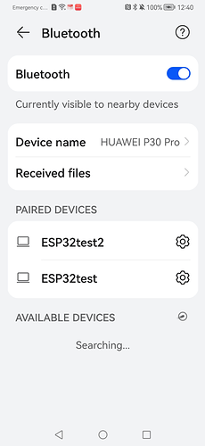

running on a pair of ESP32 NodeMCU devices using Bluetooth Classic
File>Examples>BluetoothSerial>SerialToSerialBT using different BT names, e.g. ESP32test and ESPtest2
can pair to both devices
then run the SerialBluetoothTerminal app connected to ESP32test
the ESP32 Serial Monitor displays
SerialToSerialBT
The device started, now you can pair it with bluetooth!
hello from android
can then close device and open terminal to ESP32test2
