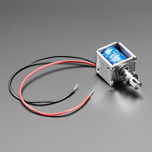

That is the solenoid
i've pluged my solenoid in proberly but it isn't working
Directly to the Arduino? See post #122; you need a driver. See the Adafruit product page: Medium Push-Pull Solenoid - 5V or 6V : ID 3992 : Adafruit Industries, Unique & fun DIY electronics and kits.
I certainly hope that you did not blow up your Arduino. Directly connecting that solenoid certainly brings the risk of damaging the Arduino.

I would start simple and just try to control the solenoid without any additional stuff.
Note:
That solenoid draws more current than the USB port usually can deliver; use a separate power supply for your solenoid.

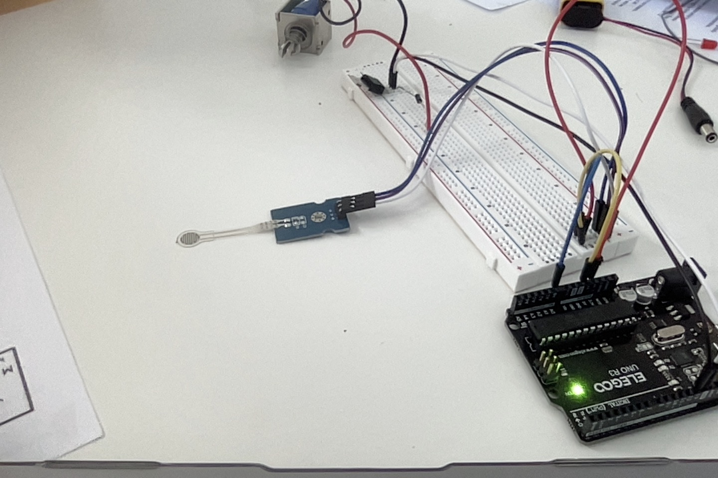

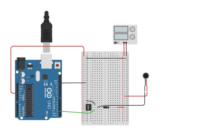

I have connected it all correct but my solenoid will not work.
Which transistor.

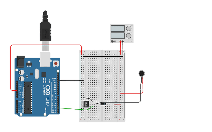

I see no base (or gate) resistors.
The base/gate in post#6 seems to be connected to the Aref pin.
Leo..
ok ill put post 6 back together

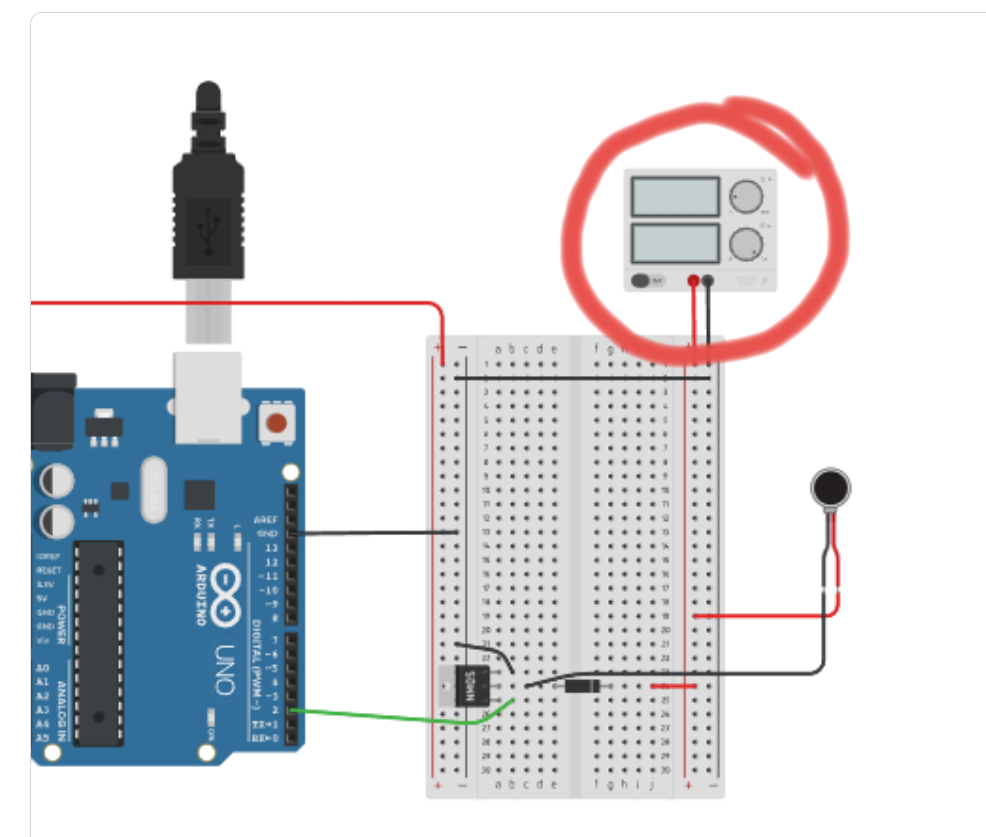

Looking at the photo in post #6, I can see that the red wire from the solenoid connects to a diode, but I don't see any connection to a power supply.

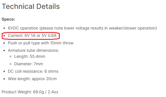

what is the power supply?
The power supply is something that can supply the 0.8A current that the solenoid requires to operate.
If you are asking this question, I assume that you don't have one.
This is the power supply. You need a real one capable of providing at least 1.5 Amps
