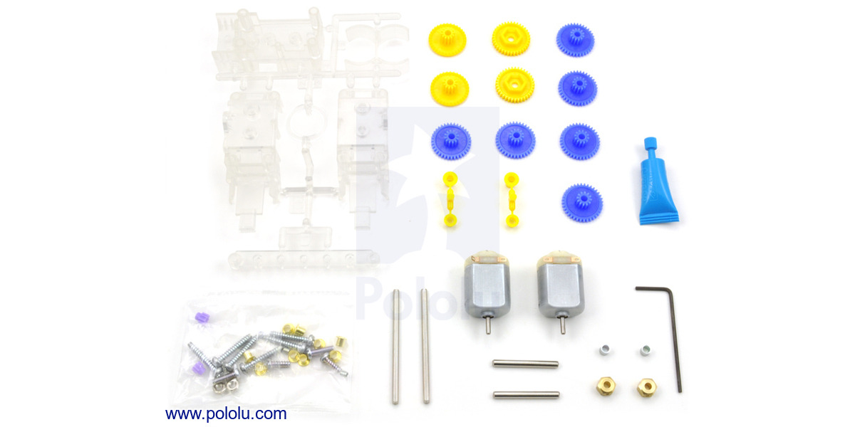

Hello all, brand new to soldering and I was hoping somebody could explain the proper way to solder wires to the flimsy copper "flaps" that stick out of the ends of the motors? They are small motors that came with a Tamiya twin motor gearbox and I believe they are "Type F130" motors or something like that.
I've been reading soldering tutorials and watching YouTube videos so I know the basics in theory (waiting on a few supplies to arrive in the mail before I can start practicing). That said, I'm confused about how to properly do this type of solder joint.
Would I hold the solder on the copper piece and heat the copper piece to "tin" it? If so, wouldn't the copper heat up and melt the plastic housing of the DC motor? Or not?
Should I solder with regular hook up wire (I have single solid wire, 22 AWG) or should I solder some male-to-male jumper wires (also 22 AWG) with the already tinned ends to the copper flaps? I have Kester electronic rosin core solder that is 60/40 (tin/lead).
Here is a link to a picture of the motors, you can see the little copper flaps I am talking about. They seem pretty fragile, I'm concerned about breaking them.

Just solder it up, that plastic is quite tough.

When you get your supplies, practice soldering wires together.
The trick to solder tiny things embeded in in soft plastic is proper preparation.
Test the plastic to get an idea of how easily it melts. Touch the iron tip against a non-critical spot on the motor body, noticing what it takes to melt it. It won't be much.
Practice tinning two wire ends. You should be able to quickly add solder to the ends leaving just a tiny ball of solder on the tips of each of 2 wires. Then practice attaching the 2 wires by touching them together and very quickly remelting the solder on them to make it all flow together. Smile ya done good.
Take a sharp knife point and scrape the oxide coating from the solder terminals on the motor. Close inspection should show a mostly shiny surface. Tin the terminals. Remember how quickly the plastic melts and don't linger anymore than necessary.
Tin the wire. Melt the 2 together. Then do the other one. Congratulate yourself and celebrate with an adult beverage.
Brushed DC motors are ambidexterous. Attach the wires to a battery of the appropriate voltage and it runs in one direction. Reverse the wires on the battery and it will run the other direction.
