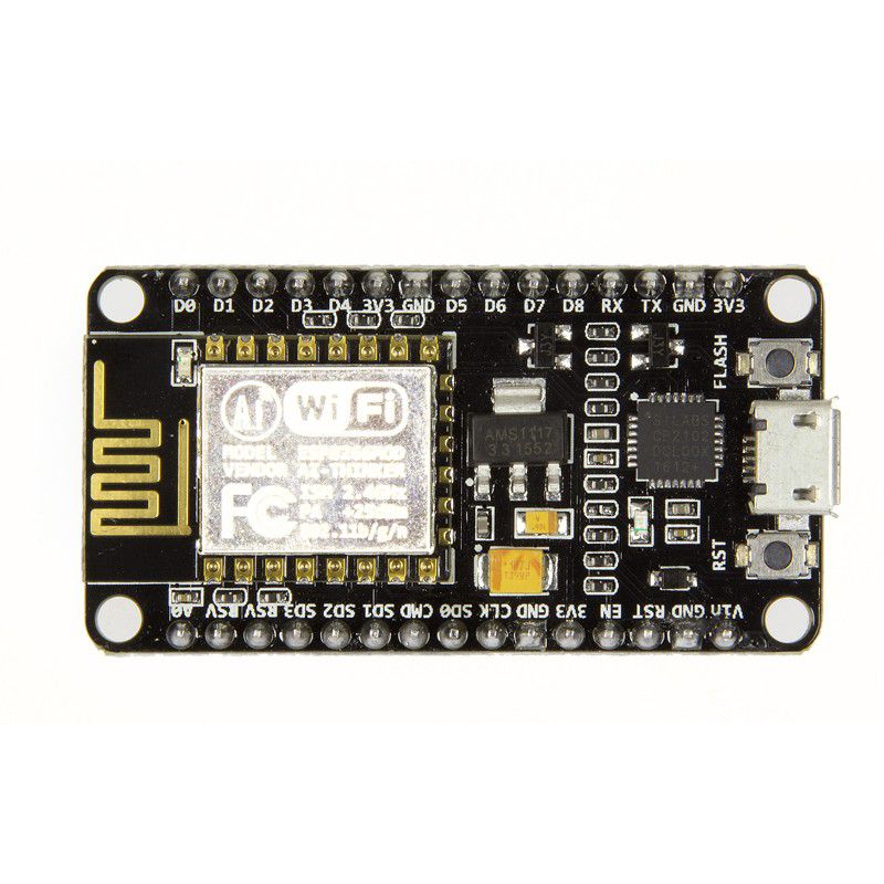

hi , where should i solder antena to the board?
As far as I know, you can't.
I would recommend buying a board with a connector for an external antenna. Often these boards require you to move a resistor to allow the external antenna to be used instead of the built-in/pcb antenna. For example the Wemos D1 mini Pro:
I would guess that the chip component at the top left corner of the tin can couples to the antenna from the Wi-Fi transceiver. However it isn't as straighforward as just breaking the link and soldering a bit of wire. At 2.4GHz you need RF coax with a good ground connection close to the "live" antenna connection. It's easy to lose more signal in your coax than you gain from using a better antenna at the end. I agree that a module that already has a coax connector on the board is a better bet.

A column in a current ham radio magazine reminded of an easy fix for your range problem. Add a counterpoise to the circuit board ground furthest away from the antenna. That will be a 1/4 wavelength of flexible wire soldered to a ground trace somewhere furthest from the antenna.
You can trim the wire length a bit at a time and test the distance you are getting.
Your circuit board antenna is really just 1/2 of an antenna. The designer assumed the rest of the board and your connecting wiring will make up the other 1/2 of the antenna. By adding the wire, you are assuring there other half is actually there!
you can't. buy a version with an external antenna connector
You need the D1 Mini Pro, and an antenna with the right connector.
