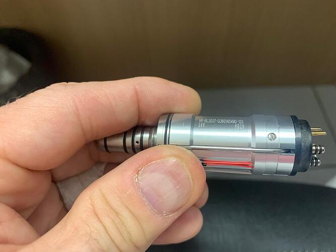

I have a small high speed sensorless BLDC motor (It has 6 pole pairs and 5 ohm internal winding resistance - it's a small high speed driller) that with it's original driver used to run from 2K RPM to 40K RPM, with good torque even at the lower speed setting (2k RPM). It used to draw no more than 3A when in highest torque, and it needs 30V-33V DC to run.

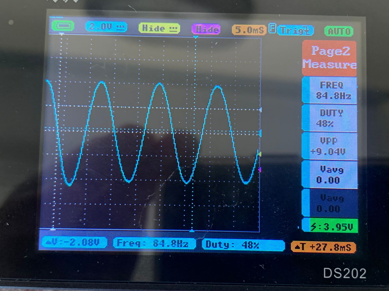

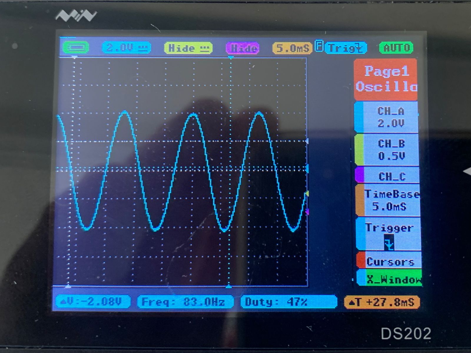

I managed even to read the RPM using the interrupt from the zero crossing detection, when each of the the commutation step happens. I used the Gyver-PID library.
But... still.. even being able to tweak the code, I can't get to less than 4-5K RPM in my motor. When I decrease PWM switching to a certain limit, the motor stops. As there's not Back-EMF anymore available to keep the commutation sequence.
But I know the motor must generate Back-Emf at 2K RPM because the original driver did it and the motor could run at 2K RPM normally with high torque (PID) (so it would mean 5% of the max PWM, or max speed).

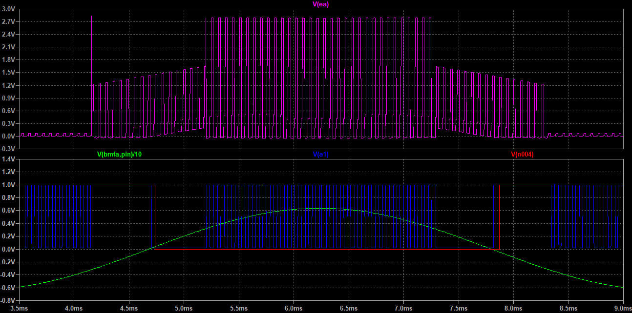

There are 2 types of BEMF voltage detection> during PWM On time and during Off time>
The upper circle shows On time detection.
When the motor goes to high speed, the On time detection is more stable, because the pulse has more width. The opposite happens with Off time detection, which is good for low speed.
It is not clear what strategy is implemented in your board, but the posted circuit uses On time detection> good for high speed.

Here is more clear what is going on, you can see the detection pulses.

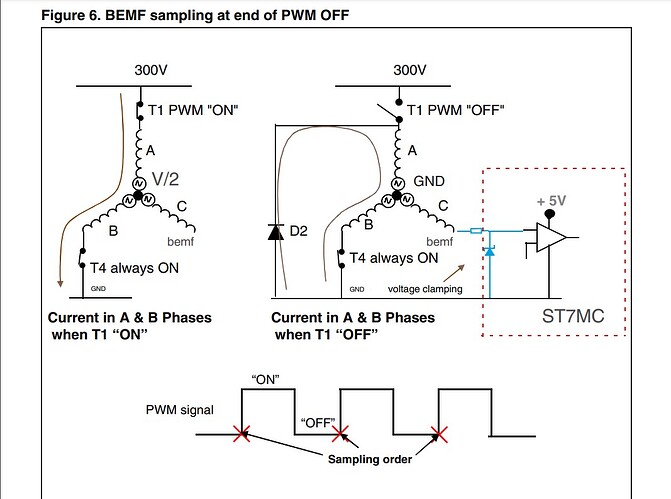

About the BEMF voltage detection during Off time STMicroelectronics has a good application note with HW explanation basically an offset to OpAmp.

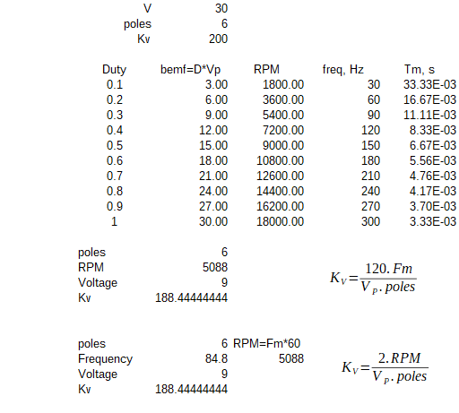

Frequency of the motor:
Fm = D*VP*KV*poles/120 = D*Vp/M		: M = 120/(KV*poles)
									: M = 60/(KV*ppairs)
M – Motor constant. It has dimension of Volt*seconds.
Period:			Tm = M/(D*Vp)
Required delay after zero crossing:		30°/360°=12
delay = Tm/12 = M/(12*D) = M’/(D*Vp)		: M’=M/12
M’ – Volt*seconds for the 30° delay after zero crossing detection.

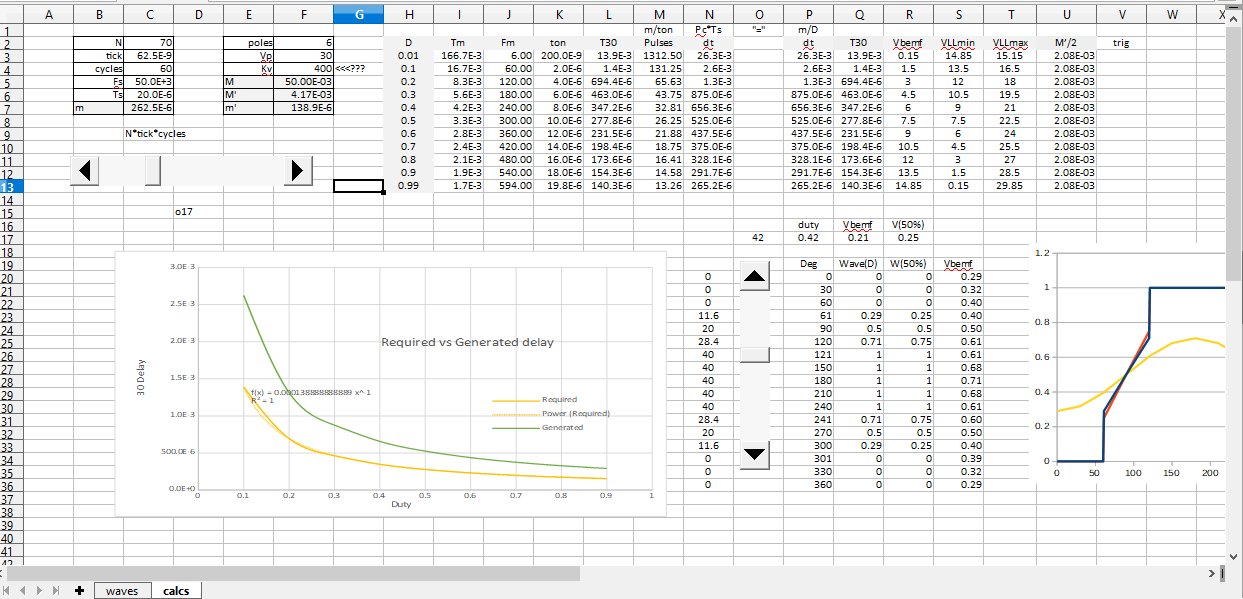

Here is one of my calculators:
ESC_30_delay_arduino.zip (27.0 KB)
The next step could be little changes in your board.
Cheers
About the calculator.
Change "cycles" cell and adjust N by the slider:

I don't know my KV of my motor... But I know it's top voltage, internal resistance, and pole pairs...
Doing this math: RPM = KV.Back-EMF (that can roughly be changed to VCC), so my KV would be something like 1424. (KV = 47KRPM/33V) Is that correct?

Also, by reading the PDF, it seems that I only need a series resistor (to decrease the current) directly between the phase (A,B and C) and the comparator? There's really no need of a voltage divider neither a capacitor (filter) on each phase?
Also, what's that voltage zener clamping diode for? Is it a 5V zener? You just connect it between GND and the positive of the comparator? Or is it a part internal of the ST7MC and not needed for my LM339 comparator?
And that D2 diode? Do I have to implement it also? Or in my DRV8302 chip it already has it internally? Or is it the N-Mosfet body diode?
The negative pin of the comparator I read that should be a low voltage, like 0.35V to compare with the voltage from the A,B or C. Is that so? In the diagram it's not connected to anything...

Can you please run the motor with a drill and measure the frequency and the (phase to phase ) amplitude with oscilloscope? Kv can be calculated that way . It is good to be sure.
Probably just increasing the 10kΩ to 20-30kΩ could help, but please don't do that before you are sure that the timing in the code is ok! Also, reducing the values would require clamping diodes to somewhere.
ST uses ADC, not comparators.

Ok.. I used a driller. My Scope is a hobby 2 channel one... and I'm still new to it..
:grimacing: Does it help?

But this is what I calculate:
Means that your motor can't go more than 18000 RPM at 30V with estimated Kv of 200. Can I have the model of your motor, please? May be I am calculating something wrong.
Sorry, you said 6 poles pairs, my mistake:
Still, please say the model of your motor.
Hi! I tried to disassemble it, but couldn't make it all the way to check if it's really 6 pole pairs. I have another one, of another type (rated at 48V) that when I opened I saw 12 windings around the spindle). Then I assumed this one is also the same, as they are both for the same use, same speeds, but different brands.
But I can confirm the motor is rated at 36V... it's written in it's outer case:
Magnets define the poles, not the slots. The slots will be anything that is divisible by 3.
And that's my problem, I can't figure out how many poles there are in the motor.
For example 8 poles and Kv=100 gives the same speed as 16 poles with Kv=50. Can you please rotate the motor in hand trying to count the resistive ticks for one revolution?
