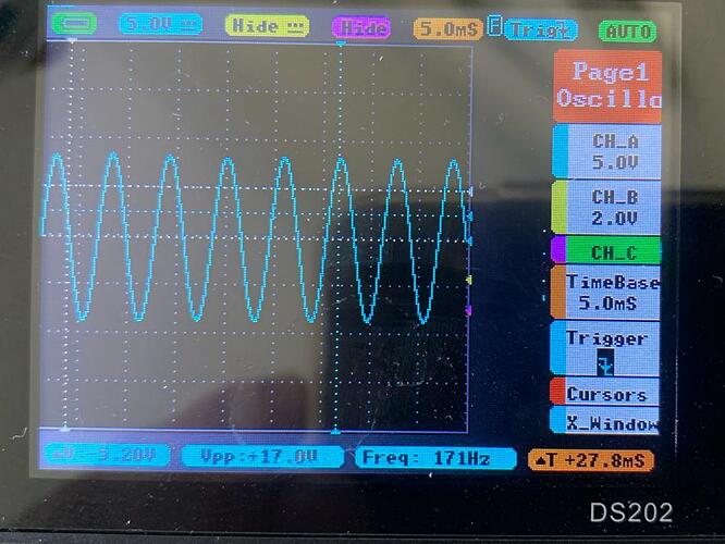

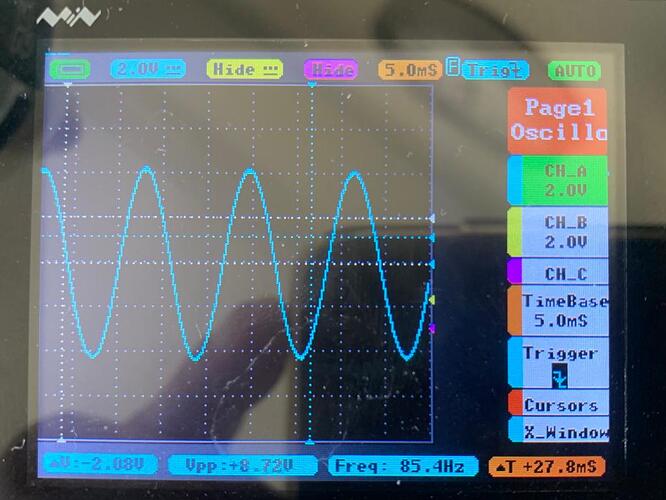

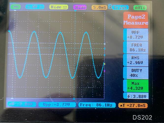

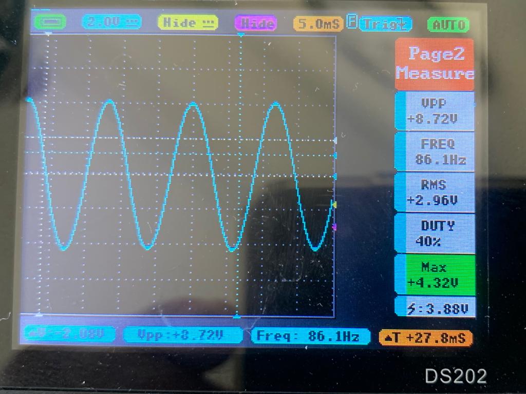

Maybe there is a gear box inside the motor? You have the perfect idea already: measure the RPM's with tacho and simultaneously the generated voltage and frequency with the scope.
Will do it later then the scope measurements, also with the tacho attached!!!
No gearbox, sorry. It’s direct drive…
:blush:
Hi! Sorry for the delay... it's mother's day here in my country!
First two pictures are taken in 5100 RPM more or less. it oscillates a bit.. Second two pictures are taken in 10300 RPM more or less also.. Does it help ??

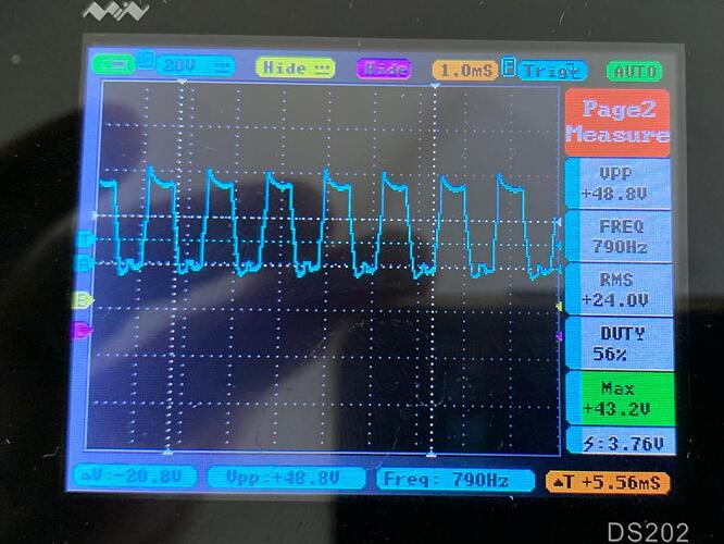

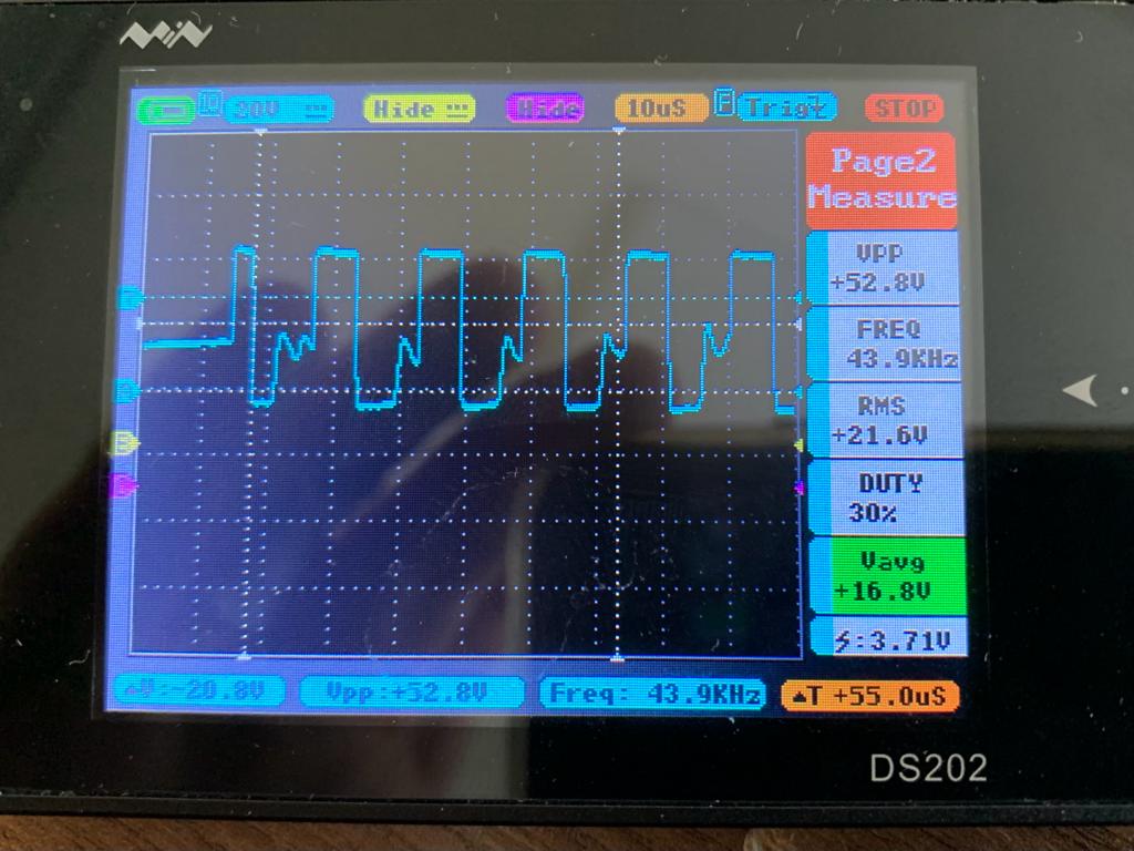

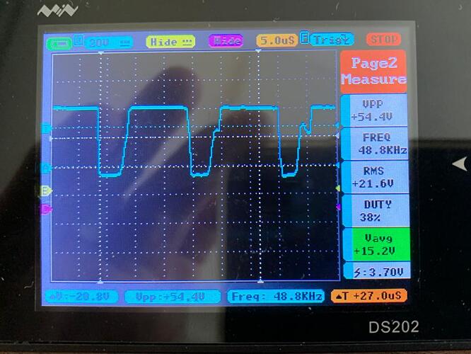

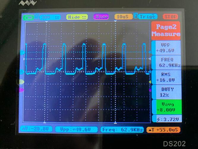

Ok, here we go.. scope connected to one phase (1/10 Voltage setting) with arduino running the motor.
The scope graphs oscillate a lot, is not a beautiful square pwm.. i tried to pause the scope to take pictures in which I considered to be... a more... beautiful image... :smile:
First: 34 pwm close to 10K RPM - no load
Second: 102 pwm close to 30K RPM - no load
Third: 166 pwm close to 40K RPM - no load
Fourth: 255 pwm close to 48-49K RPM - no load
I was getting lower RPM readings some days ago because I attached a handpiece to connect a bur to be able to read the speed with the tachometer before... and this this handpiece acts as a kind of small load. Now I took the measurements of the motor in no load. the RPM was measured within the arduino.
Does it help??

Ok, I think we are almost there with the motor. I had the mistake using Vpp instead Vpk in the calculation of the Kv.
As you see with 10% PWM duty the RPM's are 5k. So, decreasing the PWM frequency may help to get lower speed.
