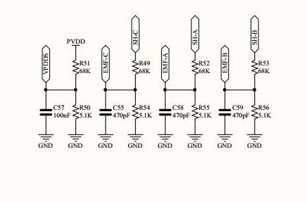

Just for adding new data, this development board has the three back-emf signals filtered, the voltage is decreased to 3.3V acceptable levels and is buffered. This is how it's done below:
Here the signals are brought to a safe voltage and filtered:
Back-EMF DRV8302 driver 1

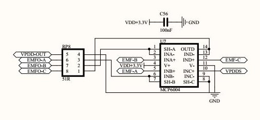

And here they are buffered (why is this buffering needed anyway?)
Back-EMF DRV8302 driver 2
So you can see that there's no Virtual Ground output pin directly from the board. I had to create it externally with 3 10K resistors using EMFO-A, B and C pins. So the Virtual Ground I created after the leveled down voltage and after the buffering. Don't know if it affects anything.
But there's the VPDD-OUT, which is the bus voltage output, also decreased to the same levels and buffered.
I tried to use this VPPD-OUT divided by two (a voltage divider with 2 10K resistors) to feed the comparator inverting pins, instead of using the created virtual ground to feed those pins. it simply didn't work with the code. The only way it works is to create the virtual Ground between the three phases. Why it didn't work? Should VBUS/2 have the same effect of the Virtual - Ground?

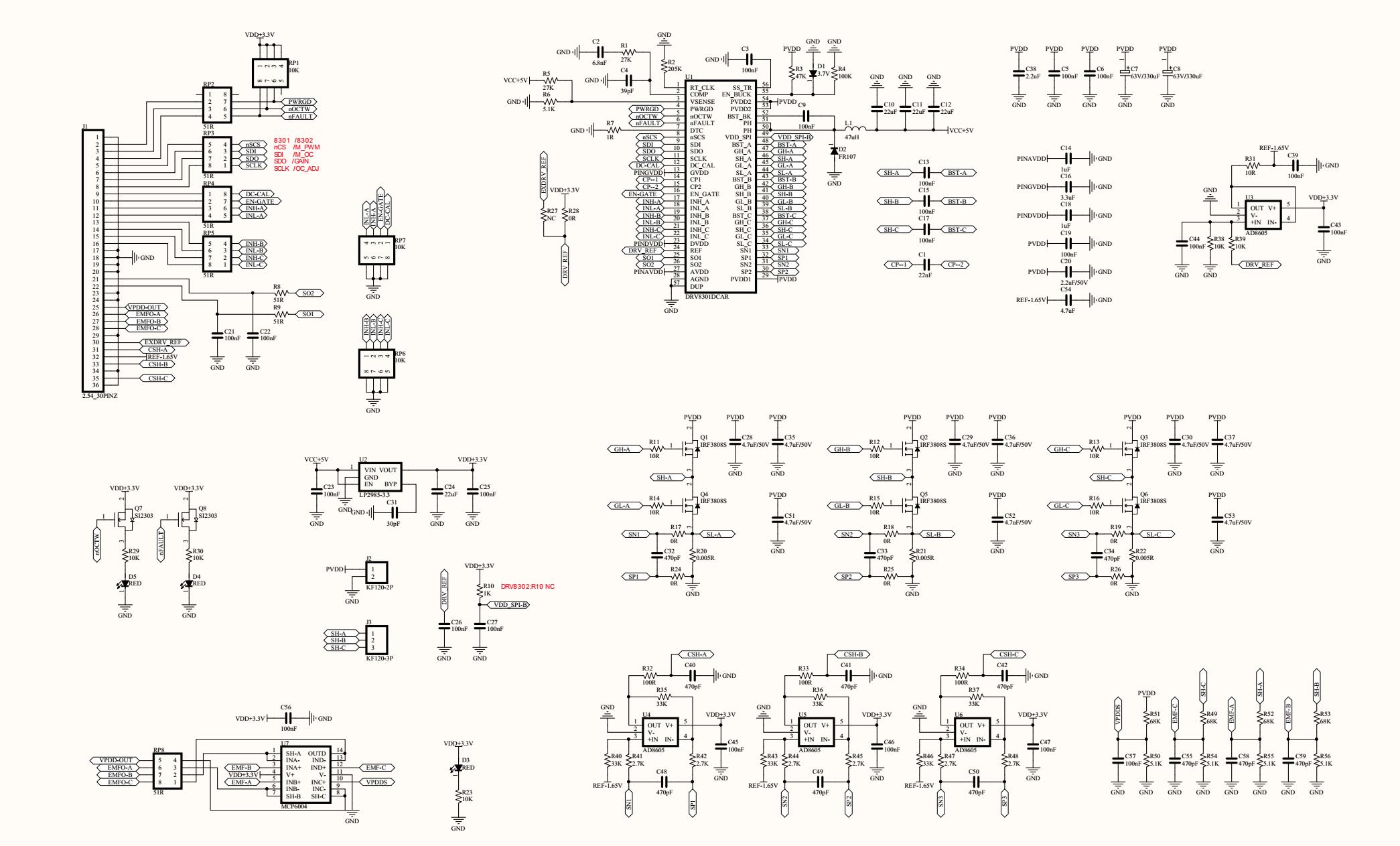

I read about this drv8302 board, it is capable of FOC. Can you post the full circuit, please?

Sure, I have it! :wink:

Added to te circuit I posted, this a google translated details of the pinout of the board.. couldn't take a snapshot in higher resolution...

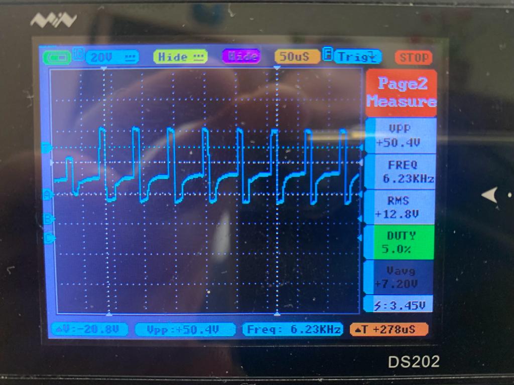

I didn't pay attention to your question... You wanted the Original driver, not the driver I'm trying to assemble. So I got the original driver wired (in the original, the speeds are fixed. I can't continuously vary their speeds. I set one speed and can only turn on and off. So this is how it works at 2K RPM, 3kRPM, 5K RPM and 10K RPM and the last one, a comparison between the original driver at 3K and mine (with that long delay inside the ISR to allow that speed to "happen". The Supply is DC 33V for the original driver, the same I'm using for my project.

10K RPM:

Thanks. I was curious about what the original did with the frequency and duty cycle at the working, low, RPMs while still torquey.
rpm freq duty pulse width, calc'd
2K 4.03K 3.0% 7.4us
3 5.19 2.0 3.9
5 5.62 2.0 3.6
10 6.23 5 8.0
your 3K 62.9 7 1.1
These are speed controlled and unloaded, right? So they wouldn't really need much energy to maintain unloaded speed. Does the 2K ramp up the duty cycle under load?
