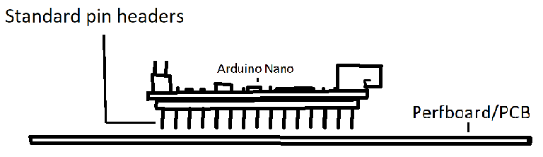

My question is this image basically:
If you lower the Nano so that the pins stick out the other side in the image, can you just solder those pins directly to the perfboard? I mean, I want my project to be permanent, so I can do this, right?
Why do so many people use 2 pin headers to do this? I understand I guess if you want to take the thing out, but, I just like the idea of making something permanent by soldering it and not hoping the Nano will stay put in the second header (I'm sure they would, I just don't like the idea of it much.)

It sounds like you got it mostly, the only thing you didn't take into account for the permanent setup is do you want the long end of the pins going through the PCB or sticking up. In both cases, you will probably cut the excess off. If instead, you choose what you call the non-permanent option, all the pins are the right length. In many cases, this is preferred in case the Arduino goes bad.
In the case of the ATMega, no, it is not soldered. Those are industry-standard sockets. There are likely billions in the world already. Almost none ever fall out; in fact, it's difficult to insert and remove them.

What's the difference between a socket and a female header? If I just connect the Nano to a female header, how stuck on is it really? Can I stick a Nano into a socket? Sorry for the batch of questions.
And for the first part of what you said, I assume you always want the short part of the header going into the Nano, and the long into the PCB. That's how I've always seen it anyways. Thank you by the way, this was very helpful :slight_smile:
A socket is what you showed in the last picture of the ATMega. The thing that plugs into it has much larger blade like legs.
When something like a NANO is inserted into a female header, we have to either use a tool or at least lift one end up then a series of rocking motions will remove it. It does NOT come out easily.
