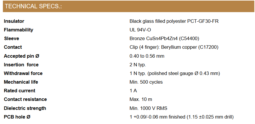

Dill accepts round pins only 0.4mm to 0.56mm

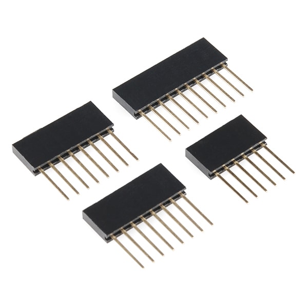

Think about how shields stack together… they are available.
ONE
TWO

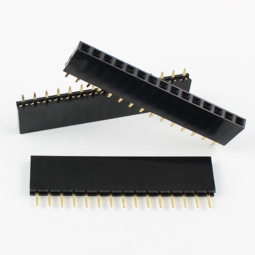

I don't see anything in the requirements that indicate stackable headers. Just use two strips of female headers like these:
They are available cheap from any place you would by electronics supplies and are a very useful thing to have on hand. Rather than stocking a collection of different lengths, I usually buy the 40 pin version and then cut them down to the length I need with side cutters (you lose one pin at the cut, but it doesn't matter).

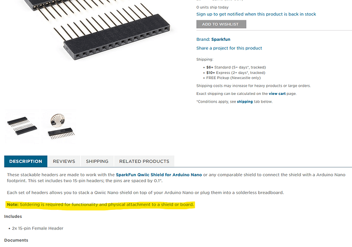

I noticed the Note on #1 says soldering is required. The second one doesn't mention soldering. These look like the little connectors I plug into my bread board and have a tendency to fall out.

I'm assuming these are non stackable, what is the difference
When soldered to a PCB the pins on the connectors pictured above barely protrude.
For them to be stackable , the pins are much longer and will protrude about 10mm, allowing them to be plugged into another connector.
Sockets provide a solderless electrical connection. You will never solder the Nano to the socket itself. However, other than perhaps some very rare "press-fit" exceptions, you will always solder the socket itself to the circuit board.

They are not for use with a breadboard. They are for use soldering to a circuit board with through holes.

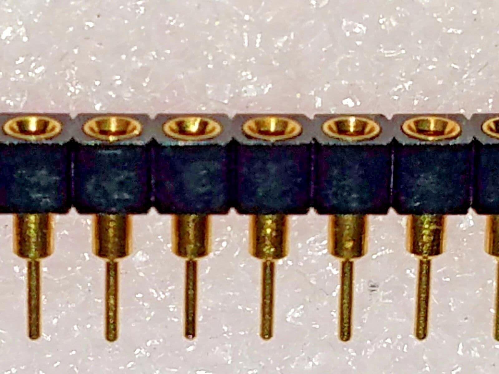

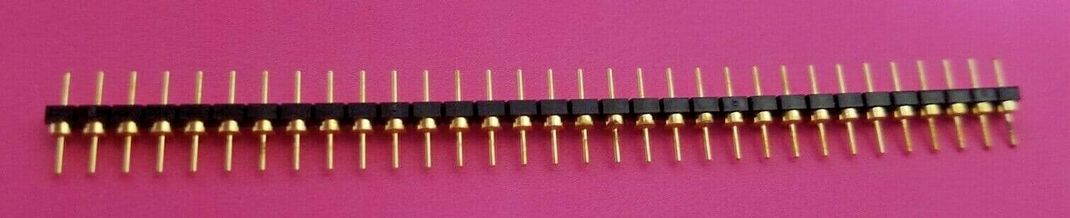

You can used machined pin sockets. However, you will need to get the version of the Nano 33 BLE without headers:
Then you will need to solder the male machined pin headers on the Nano 33 BLE. Like these:

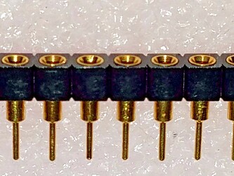

This is another case where you can use two strips of female machined pin headers cut to size instead of a socket. Solder those to the circuit board you want to attach the Nano 33 BLE to:

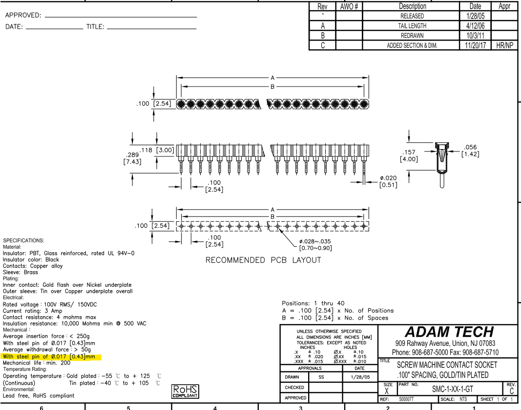

Those also seem to have the same pin size problem. This is the only one I found from Digikey.

Where are you noticing Note #1 ?
Can you please post a link.

The header sockets in post #3 that @in0 cited will do the trick, they will take the full length of the header pins, providing a good and secure connection.
You missed the part where I said that you need to buy a Nano 33 BLE without the soldered headers and then solder the correctly dimensioned pin headers to the Nano.

First link in lastchancename's post #2

They will if you buy the "without headers" version of the board and then solder the matching male headers to the board.

OK, it makes more sense now. Well, unless you find one of those "press-fit" solutions (example here, but with male headers), you are going to need to do soldering for the female part regardless.

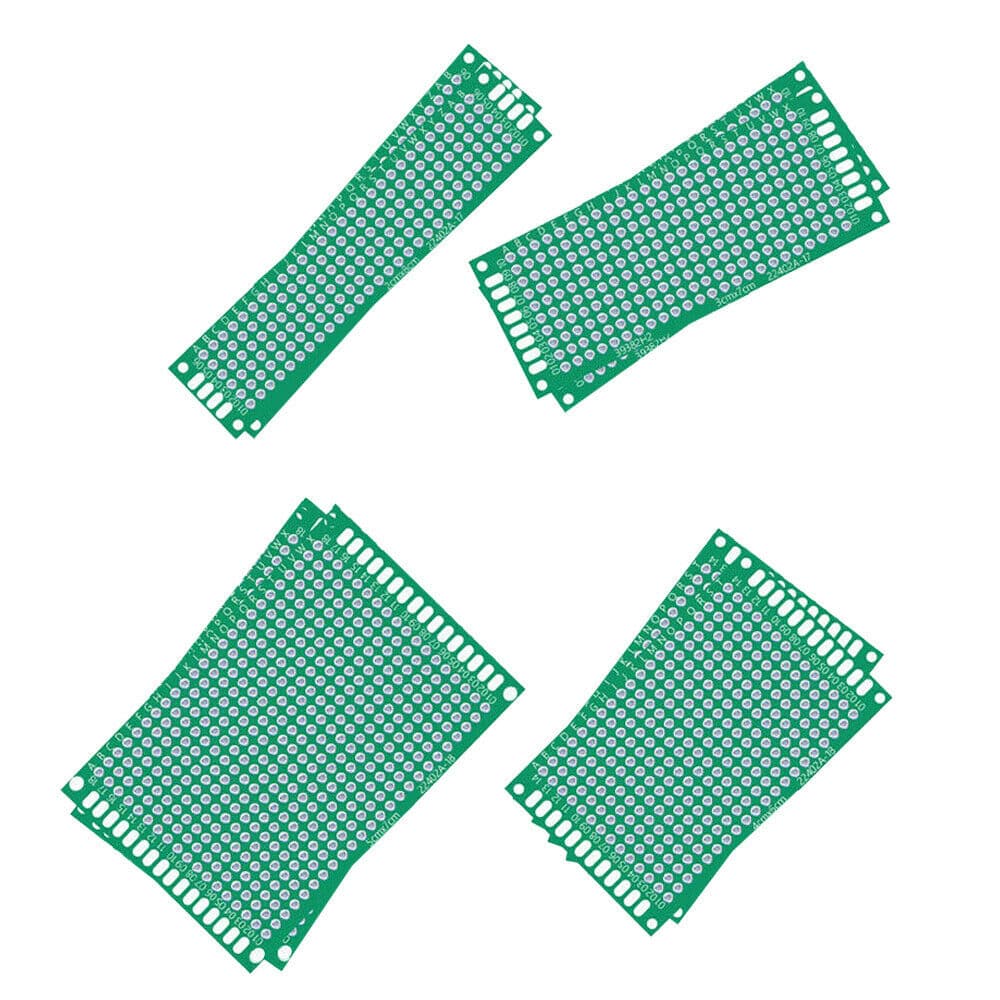

My recommendation is to buy some "protoboard", the plated through hole style like this (doesn't matter what dimensions you get):
and some 22 AWG solid wire.
Watch a few YouTube videos about soldering and then just start soldering bits of wire into the protoboard, evaluating the quality of your solder fillet each time.
This will allow you to practice as much as you like without being worried about the expense. And any protoboard and wire left over will surely be useful later. If you can get a good fillet on the protoboard within a reasonable amount of time, you will have no problem soldering headers to the Nano 33 BLE.
This will be the first PCB board I will be making. For the first few, I would prefer to screw up sockets rather than nano's. In the end it will be soldered. If not by me, by someone that does soldering all the time. I recently purchased a Hakko soldering station and built a much smaller circuit requiring about 5 or 6 soldered joints to one of those green boards. It came out successful. But it was only about 3 or 4 resisters and caps soldered in place. No surface mounted stuff on the other side to fall off because I over heated it.
