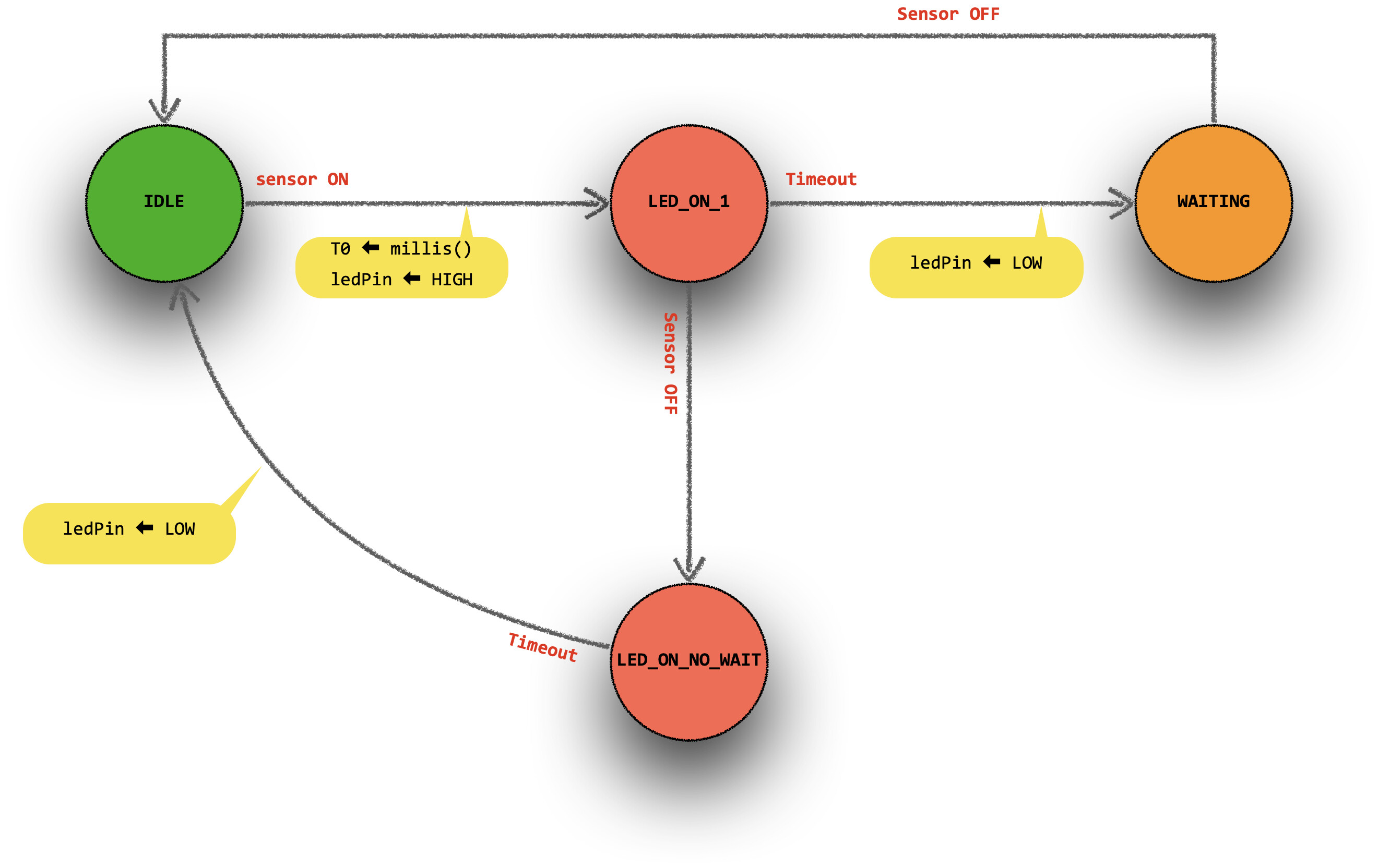

Your specification is not complete.
what should happen if the analog input is still above the threshold after the 30s? go again for a 30s cycle? just ignore and turn off and wait for the analog input to go below the threshold before being able to activate the digital output again?
a state machine is a good way to design this kind of system, here is an example of what it could look like
@J-M-L
I'm pretty familiar with programming state-machines but I don't understand your picture.
Too less explanation what is meaning what.
What do the textes inside the circles represent?
what do the textes along the arrowlines represent?
what do the yellow "messages" represent?
I'm sure if you try to think about it you'll figure it out - most people do :slight_smile:
to help if you really could not get it:
circle = state (so the label could be the state name)
arrow = a possible transition
red text = event triggering that transition
yellow bubble = action to take during the transition
start in the green circle state (idle)
(and it's incomplete, needs to account for the sensor being activated again in the LED_ON_NO_WAIT state depending how you want this to work ➜ goes back to specifications)

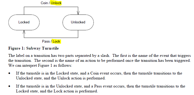

How can you do an action during the transistion?
For me a transition is
myState = sm_waiting;
the pure assigning of a new state
This assigning of a new state is conditional and of course inside the conditional code you can have additional commands
I still say for somebody that is very new to state-machines your picture has way too less information to write the code or even if you put the code next to it to understand the relations between the code and the drawing.
If you insist on saying "most people will learn it" then this learning happens through reading additional tutorials but not through studying your picture.
don't get lost in translation, I'm French, you are German (if I trust my guts), none of us is a native English speaker :slight_smile:
it means do the action, then change the state to acknowledge you have taken the transition
I said "most people will figure it out", implied of course that they have some programming background and understand FSM. note for mere mortals :slight_smile:
(I do have a tutorial in French)

This paper has the diagram below and associated explanation. The action's completion is what differentiates one state from the other. The wording below (... transitions to the state ... and the action is performed...) would imply that the action associated with the state change occurs after the arrival in the new state. That makes more intuitive sense to me than
... since that would mean the previous state would need knowledge of what the next state should do. For example if state LED_ON needs a led turned on, it seems better to me to turn it on on arrival in state LED_ON rather than do that on exit from state WAITING. Why should state WAITING be expected to know what to do in state LED ON? And there may be a dozen routes to state LED ON: would be tedious to have to code that led turning on in 12 previous states rather than only in the new state LED ON.

to your point, the idea is to graphically describe what a switch/case would do upon getting the event required for a transition. It's not what you want to do in the next state, it's what you do because you've got the event that will move you to the other state.
see code sample above for a better idea of what I meant in my frenglish
BTW you are correct on this but it's extra code to do what's required only once, when you enter the new state - so it's easier to do it when leaving the previous state in my opinion.
otherwise you need a intermediary state where the action is taken and then you move to the real next state
