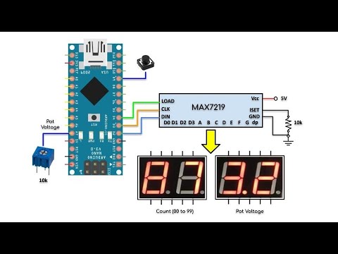

Hi!
I pasted the relevant segment of my code below, i found it on the internet, i'm using a simple 4 digit, 7 segment LED display with a MAX7219.
I don't know however how to 'translate' between the manual for the IC and code.
For e.g. if i send the command 10 with a value of 0-15 i change the overall brightness of the display.
In the manual, on page 9 i found the corresponding table for the brightness change but i can't found the command 10 or anything else anywhere so i can't implement new functions in my code.
Now i want to turn off the display with code and then turn it on again, but i can't find the command for it.
Whole code is pasted too, but the relevant part is this:

Thanks, i found the OP codes for the MAX7219 in the source code for the linked library.
If anyone wondering:
//the opcodes for the MAX7221 and MAX7219
#define OP_NOOP   0
#define OP_DIGIT0 1
#define OP_DIGIT1 2
#define OP_DIGIT2 3
#define OP_DIGIT3 4
#define OP_DIGIT4 5
#define OP_DIGIT5 6
#define OP_DIGIT6 7
#define OP_DIGIT7 8
#define OP_DECODEMODE  9
#define OP_INTENSITY   10
#define OP_SCANLIMIT   11
#define OP_SHUTDOWN    12
#define OP_DISPLAYTEST 15
these are the OP codes according to table 2 in the data sheet.
