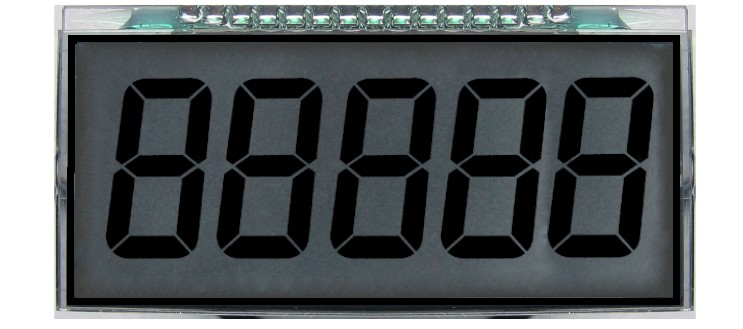

How to test to know common terminal pin in 14 pin segment lcd?

Apply the appropriate AC excitation voltage (as specified in the data sheet) to pairs of pins until you find it. Or look for the pinout on the data sheet.
ok sir
I have no see data sheet for lcd that have 14 pin.Can you give me a advice?
Look for a similar device. Are you just testing it, or do you plan to use it? If you plan to use it, how will you do that?
It looks like the OD-301 from Oriental Display but with 5 digits instead of 3 and 15 pins instead of 10. They also have an OD-6010 with 6 digits and some colons.
For 5 digits you have 35 segments. There can't be only 2 commons since 2 * 13 is less than 35. I think there are three commons since 3 * 12 = 36.

For a 5-digit 7-segment display, I'd expect a traditional multiplexed arrangement with one common for each digit and 7 segment pins connecting to all of the digits. (But perhaps there are additional limitations because of the signals being routed on glass.)

The 6-digit model has 16 pins, of which 4 are commons. I think they try to minimize the number of commons to allow for more frequent refreshes.

I think NOT 2x13 because that can only address 26 of the 35 segments.
I think the 15 pins will be arranged as a 3x12 matrix.
Only possible answer. Three "common" pins, not one.

With 15 pins and 35 segments, 4x11, 5x10, 6x9, and 7x8 would also work but I think they try to minimize the number of commons.
Sir.I knew what on pin in lcd.Now I test to drive lcd with TM1721 IC and arduino Mega.But I have no code.Can you give me test code with TM1721IC and Arduino Mega?
