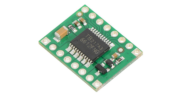

I got these cheep amazon 5v dc motors with wheels for fun and I was researching how to use them and I keep seeing stuff about motor drivers and I was looking at the arduino store for theses motor driver things and I was planning on using my MKR 1010 so I found the MKR Motor carrier and it was 60 bucks and I was wondering if there was a more budget option, I thought when I bought the motors it would be 10 bucks down the drain and that's it but now its looking more this 70 bucks! If you know of a cheaper option PLEASE tell me!

How many motors do you need to use at once? Here is an option for $6:
If you want the convenience of a shield for a relative expensive Arduino, then I guess you have to pay for it.
If you want to save some money, then use a separate (wired) motor driver board.
Pololu has an excellent range, or Adafruit. Just stay away from the l293/L298 crap.

I have 4 5v dc motors with wheels. I got them in Amazon.
For $12 USD, you can control 4 motors bidirectionally, using two of these — assuming that the current demands of your motors don't exceed the driver specs (1 A continuous and 3 A peak for each motor).
That should work
