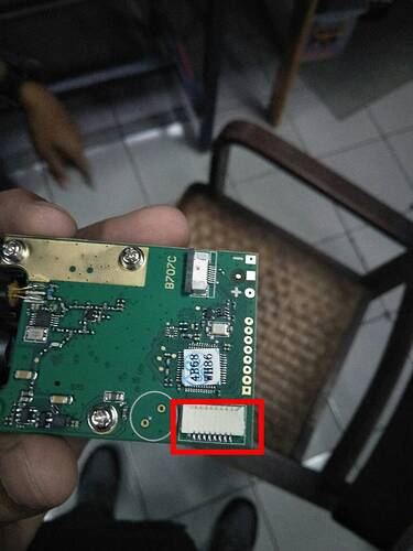

I bought laser distance meter with PCB B707C.
They just give me the modul like picture.
please help me..
how to connect it whith arduino ??
where is Tx and Rx ??
what should I solder in the red box (picture)? what is the function?

Google finds this as the possible manufacturer that you might find details from and the image on that page
implies a UART serial connection (possible 19200 baud).

Be aware this device interface is probably 3.3V so connecting a 5V Arduino to it may damage it.
As the picture shows the LDM connected directly to a BT module you should be good with UART signals (no need of RS232 adaptor board) as long as they are only 3.3V.
It looks like 2 wires from the battery pack go to power the LDM and then the 4 wires going to the BT module (HC-08) are going to be 3.3V (red), GND (black), RX (blue) & TX (grey)
look at the picture above. the rectangle at top center is marked HC01
this page shows the many variants of that module: Bluetooth modules
the one in the picture appears to be this one:
so, left to right, RX, TX, GND, VCC,
so, gray wire RX, blue wire TX

There's some useful information there, but the main challenge is soldering the right ports.
I mean you can clearly see the + and - connectors, but where do I solder the cable which goes into the digitalPin?
I took a look at that version with the battery pack and I guess it could be the connector with the gray cable?
You need two connections to a serial port, to 3.3V RX and from 3.3V TX on a 3.3V Arduino. Plus GND, of course.
In comparison to the radio module connections, it appears that on the laser module, the blue wire should be connected to Arduino TX, and the grey wire to Arduino RX.

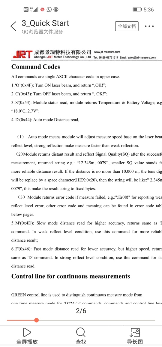

The Lady from JRT said she wasn't entirely sure if the product from Banggood was the same as theirs, but she snapped some pictures of the manual with her phone (and sent me the screenshots :fearful: )
They are low quality and cut off, but I've attached them for you guys.

This is just to confirm:
  1. The connections for the B707C are
  • 3.0 V (2-3.3 range) to the pad marked '+'
0 V to the pad marked '-'
Numbering the 8 pads inboard of the '+' pad 1 to 8:
pad 1 is B707B Rx and should be connected to Arduino Tx
pad 2 is B707B Tx and should be connected to Arduino Rx
  1. And yes that seems to work just fine according to the codes given in above posts.
I used the attached sketch written by a friend to work for Teensy 3.6 Serial4.
All very simple and excessively obvious for some - but one has to start from somewhere.
Note that in using the IDE serial monitor, you will need to set the COM port to the speed set by Serial.begin
In the sketch it is the same as for the B707C but probably does not have to be.
There remains the mystery of what the other 6 pads on the B707C do.
One is probably to command a continuous series of measurements.
And, if you are excessively inquisitive, the other two connectors for flat ribbons. Probably for keypad and display in a handheld meter.
I should perhaps also add that if, having turned to aiming LED ON with an 'O', you then ask for a measurement with a 'D' or an 'M', the spotting LED is turned off as part of the B707C response.
