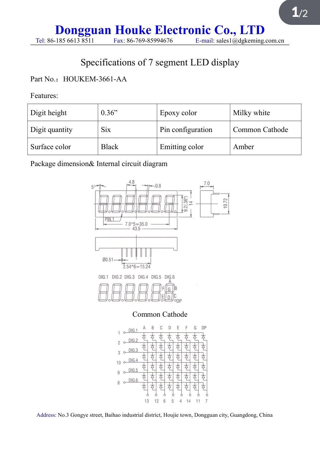

One of the images on the link you posted is a drawing with the 6dig7seg pins you need to connect... Looks like you need fourteen pins...

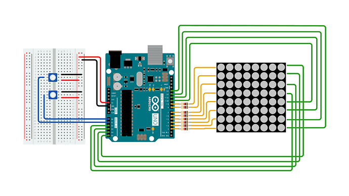

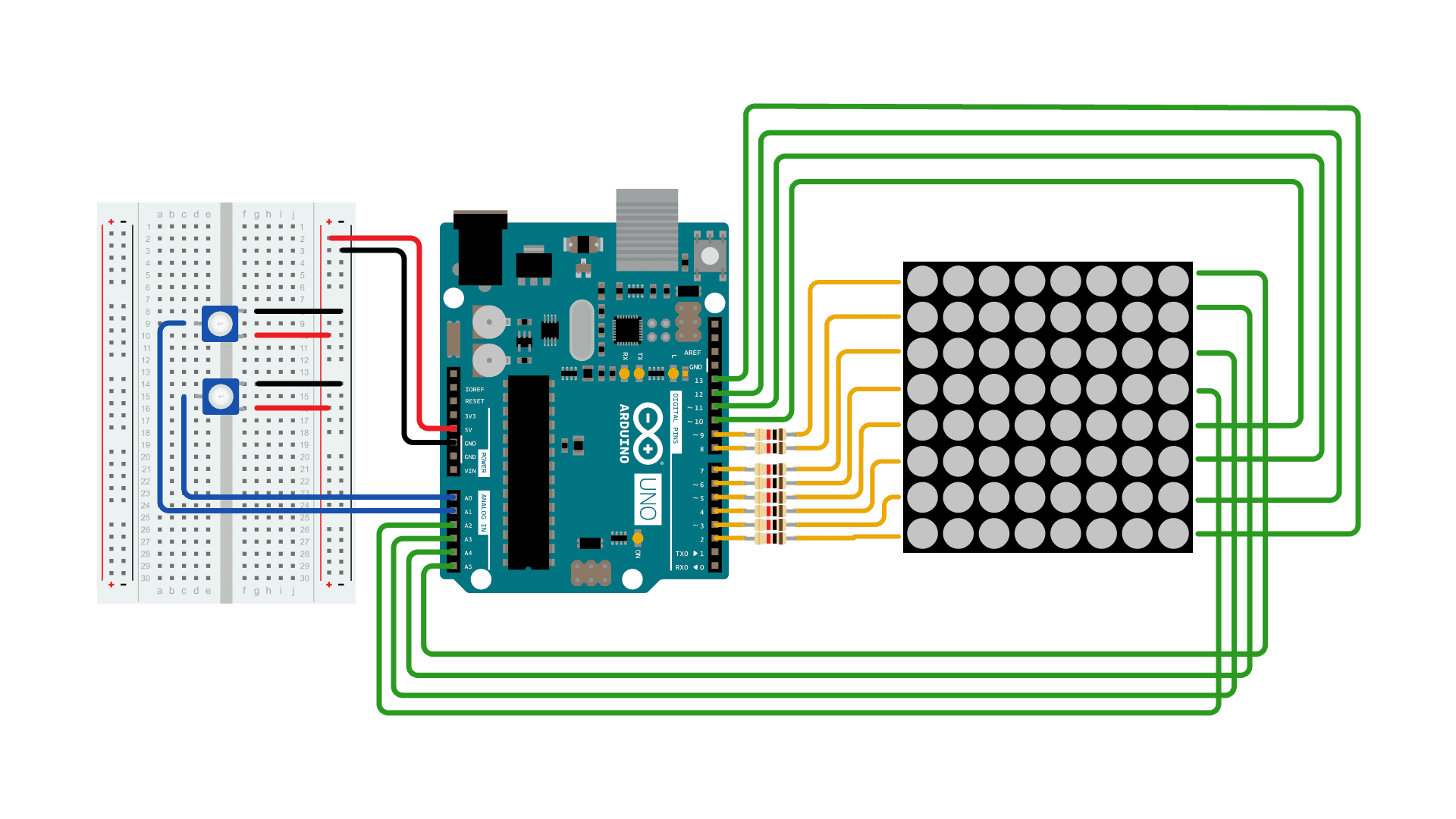

This might be your lucky day, I found your project (almost) here: https://docs.arduino.cc/built-in-examples/display/RowColumnScanning/
Let us know how you do!

The manufacturer gave me there documentation if that can serve to anyone

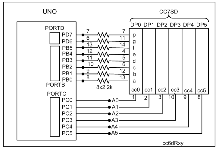

1. Try the following multipleded type 6-digit cc-type 7-segment diaply unit (Fig-1) sing SevSeg.h Librray.
Figure-1:
2. Uplod the following sketch (untested) to see 123456 on the display unit.
#include<SevSeg.h>
SevSeg sevSeg;           //create object sevSeg
int numberToShow = 123456;
  byte segDPins[] = {8, 9, 10, 11, 12, 13, 6, 7};  //DPin8 = seg-a, …, DPin-7 = seg-p
  byte ccDPins[] = {A0, A1, A2, A3, A4, A5};          //DPin-A0 = cc0, DPin-A1 = cc1, ...
  sevSeg.begin(COMMON_CATHODE, 4, ccDPins, segDPins, false, false, false, true);
  sevSeg.setNumber(numberToShow, 0, LOW);
  sevSeg.refreshDisplay();
That wiring diagram does not appear to match the display data sheet in post #8.
1. The OP may use a DVM (or follow diagram of post #10 @6v6gt, Fig-1 repeated ) to find the segment pins and cc-pins of the display devices (assuming the display devices are of cc-type) and then easily connect his display unit with UNO (Fig-1) following the guidance of Fig-2 of post #9.
#include<SevSeg.h>
OK. That diagram and code appears to better match the data sheet for the display although the sevSeg constructor appears to be configured for a 4 digit display.
It seems he has a Mega, not a Uno (see post #1), which is a good thing because, for a Uno, a direct driven 6 digit 7 segment display leaves only a few pins for the actual application.
I have provided an untested sksetch which the OP may adjust if deos not work.
