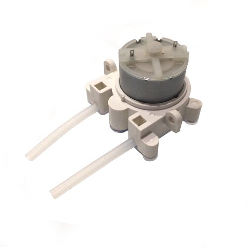

how to wire my pump with this g3mb-202p omron relay?
Hi, it may be silly to ask this. But i need to, as i so far still failed to connect it.
My project is simple, turn on the pump and off with relay.
My relay and pump is this one
My trouble is when my relay said to stop my pump is still keep running and too fast.
I use 9V battery as power supply, and my failed wiring is this
DC+ to 5V pin
DC- to GRD pin
Ch1 to digital 10 pin
A1 to battery negatif side
B1 to pump negatif side
Battery positif side connected to pump positif side

Those seem to be AC solid state relays. SSR data sheet
can't be done.
you have a DC pump and an AC relay.
the solid state relay has words on the side that say AC LOAD 240
just realized that you can take your line voltage and put in a regular electrical box and put in a receptacle for a plug.
get a double wide box and mount your relay inside.
wire the receptacle through the relay.
turn the relay on and off and your receptacle will come on and off.
then put in a wall wart that has output voltage as needed for the pump.
but do check the data sheet for that exact model. it says 230 AC, not 120/230
it may require 230 VAC, means it would be intended for the european market.

In order to help choose a relay or other driver for a motor one needs to know the rated voltage of the motor and the stall current of the motor (locked rotor current). Stall current can be estimated if the winding resistance is known. Also if the motor only turns in one direction, a properly rated MOSFET might be a more efficient driver than a relay.

I don't really know the voltage needed by my pump, as there is nothing like that on the pump even it's name like it's manufacturer or something like that. Maybe it's 6V?
I guess 9V battery is too much then
So it's better to put it on PWM digital pin? As yes i need the pump to run for specific time and at specific speed
Funny things is that my pump back then running so fast it's even make the pipe go out from it's place. So i guess it's too fast
where do you buy your pump ? if you bought it from a web page, then that page should list the voltage.

But if i may ask for opinion? Is regular water pump is good enough for this:
Pumping already equally mixed solution A & B to the nutrient solution of hydroponic
Because back then i though different kind, pumping undiluted solution A & undiluted solution B separately to the nutrient solution
And then my teacher give me this peristaltic pump because i need to be accurate
So the teacher gave you a low voltage DC pump and a high voltage AC (mains power) relay module.
That relay module can't be used for a battery powered pump.

You might not even need a relay module for a small low voltage pump.
A logic mosfet or NPN transistor with a few resisors and diode is all you need.
Ask your teacher, or Google "Arduino pump driver".
