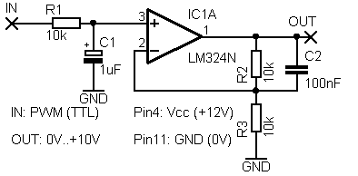

Yep. Low current is fine. I'm just trying to make a stock power-chair controller board think that the joystick is still there even though I've replaced it with with outputs from an arduino.

How much current? < 100mA
How much voltage? range of 4.5v-7v
What frequency? flat DC output, 5v PWM input
What accuracy? +-0.05v

You want to make the circuit still think the joystick is there, but instead an arduino is translating PWM from an RC receiver into the input expected by the board
Do you know if there's any current flowing through the signal lines? If not, you could generate analog voltage with RC filter, and use that as one end of a voltage divider, and the 12v as the other side. If so, actually, you could do the same thing, but just buffer it with an opamp.
You can do things like that with opamps and resistors and an RC filtered PWM output.

You can use circuit like this, fine turn the R2 to give you 7V
This could work.
PWM to 4.5-7volt, with 100mA current capability.
Most opamps will do, even an ancient 741.
