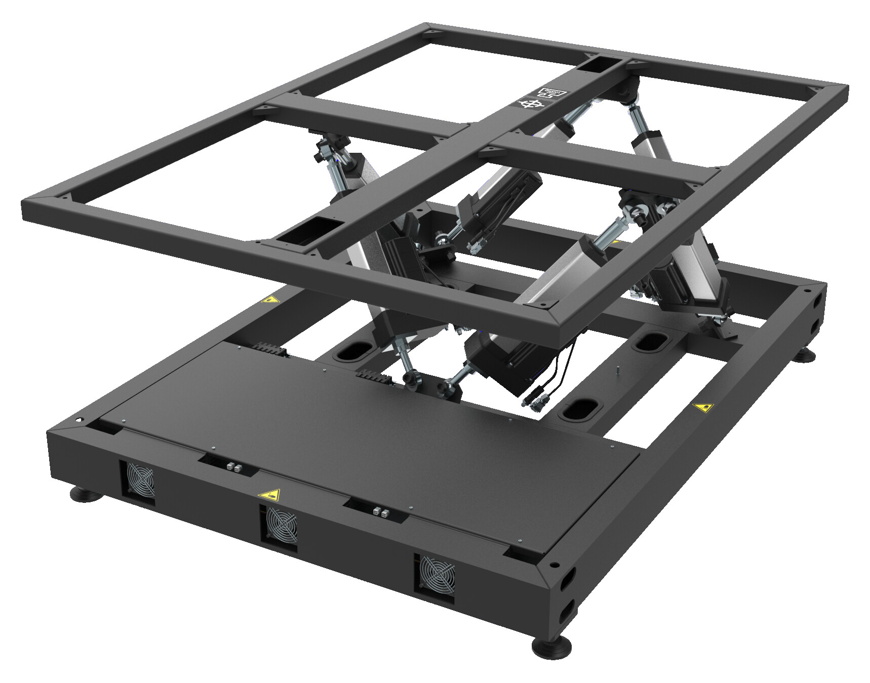

Here's where it gets wild. What if I hooked up a hydraulic pump to the generator engine (I have this part figured out). Then, I could remove the struts / springs / shocks from each wheel, and replace them with hydraulic cylinders. On the rear wheels, I could fabricate a tie bar connected to the rear wheels that would move the bottoms of the rear tires left or right (picture pushing the escape side to side). I have 100% of the mechanics figured out on this. (I'm comfortable with the fabrication and hydraulics of this).
Ultimately, I want to create a hydraulically powered motion sim out of my Ford Escape. Instead of moving a seat, I want to move the entire vehicle that I'm sitting in. Over simplified, when I step on the gas, the 2 front hydraulic cylinders will extend raising the front of the escape; the 2 rear cylinders will contract, thus lowering the escape, giving the feel of accelerating. Braking will do the opposite. Turning left will contract the two right side suspension cylinders, and extend the left. Right turns, visa versa. If I accelerate too hard out of a turn and get loose, the 5th cylinder (rear wheel tie bar) will extend, pushing the bottoms of the tires left (making it feel like the rear end is swinging right - simulating a rear end sliding motion).
I have played with basic arduino in the past. I've bought the kits, made LEDs flash, even built proximity sensors for to tell the distance of another vehicle / object. BUT, my arduino experience is limited. I do have experience with motion control / sensors / actuators in an industrial setting. But Arduino I'm not so well versed in.
Now here's where it gets fuzzy for me. I know guys are using arduino to build motion sims in their homes, controlling rotary motors / linear actuators. So I would assume since the other projects are simply utilizing electric signals to control motors / actuators, i SHOULD be able to control electro hydraulic actuators to achieve my goal, correct? How does that interface with the PC? How insane am I going to have to go (learning wise) to write a code for something like that?
