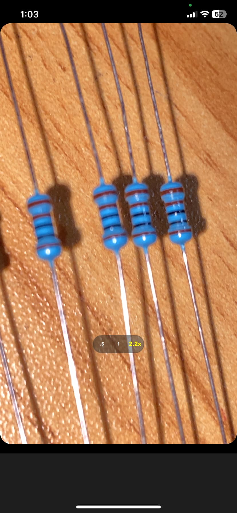

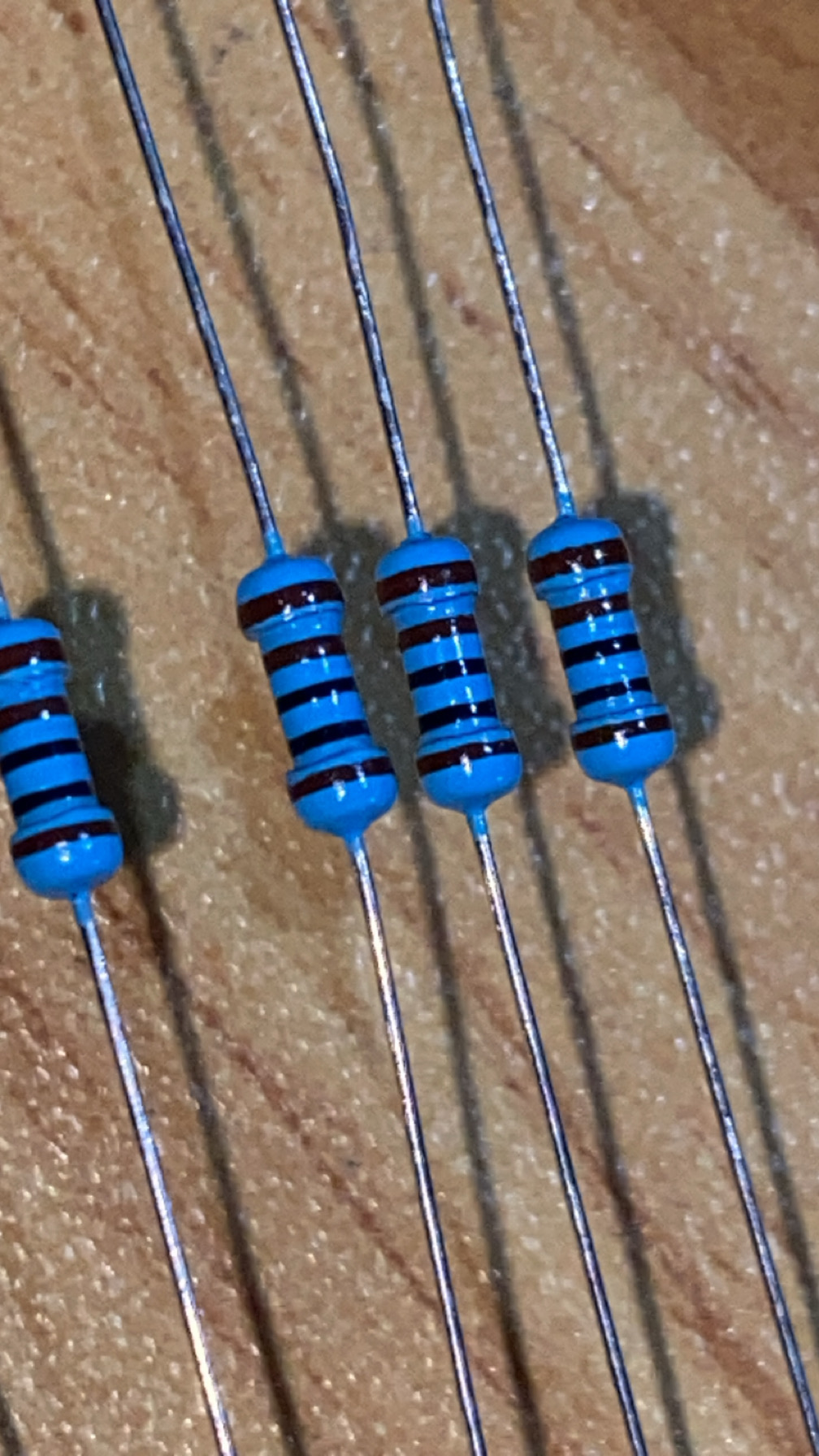

I have tried different circuit connections but can’t seem to get the LCD to print any text. Could the problem be my resistors? Circuit diagram calls for a 220 ohm resistor

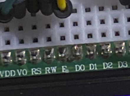

Also, use a multimeter to check wiring for continuity and solder joints for bridges (see below between E and D0) and poor connections.

Google resistor codes to answer the last part.
Where is the 10K pot to Vo?
