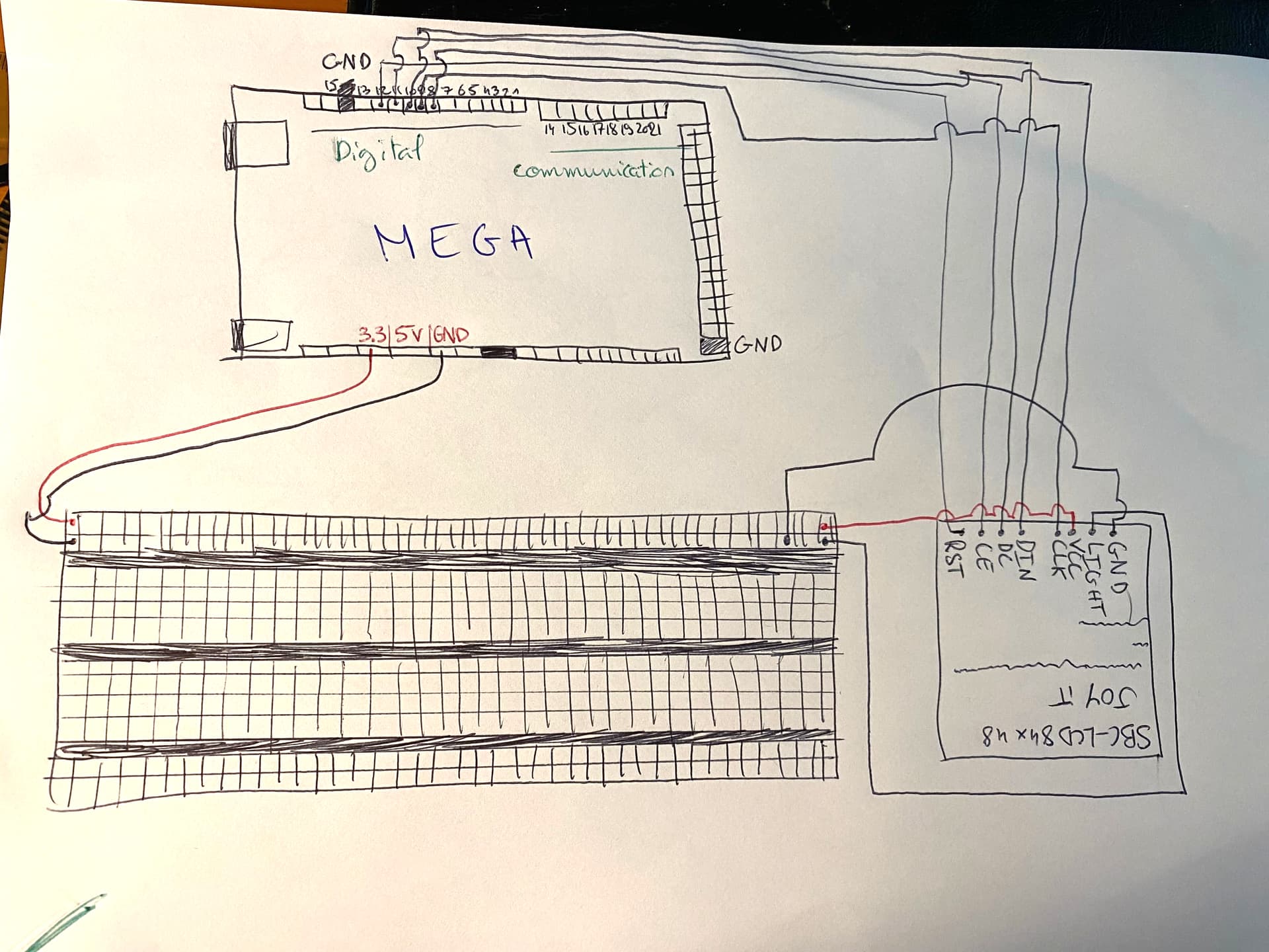

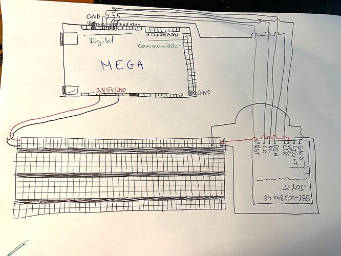

Posting an annotated schematic would help a lot. You took great pictures but I cannot follow your design nor can I read the pin designates.
As @gilshultz says
How to make a schematic you can post. - Using Arduino / Introductory Tutorials - Arduino Forum
@pvac was asked twice to provide a schematic of this circuit on another thread, does not seem to be interested in doing that.
do you have a good app for this type of schematic ?
Sheet of A4 and a pencil
We do not understand why you do not want to provide an annotated schematic. Speaking the language helps all of us understand your problem. This is not the first time you have avoided posting the schematic. If you do not know how there are many tutorials, books, etc on how to do it and a lot of help online as well.

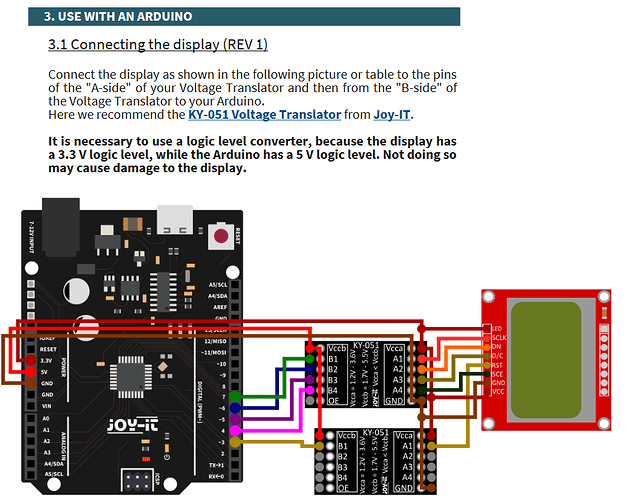

Don't see any level shifters..
Check the screen manual, page 3..
SBC-LCD84x48_Manual_2023-04-24.pdf
good luck.. ~q

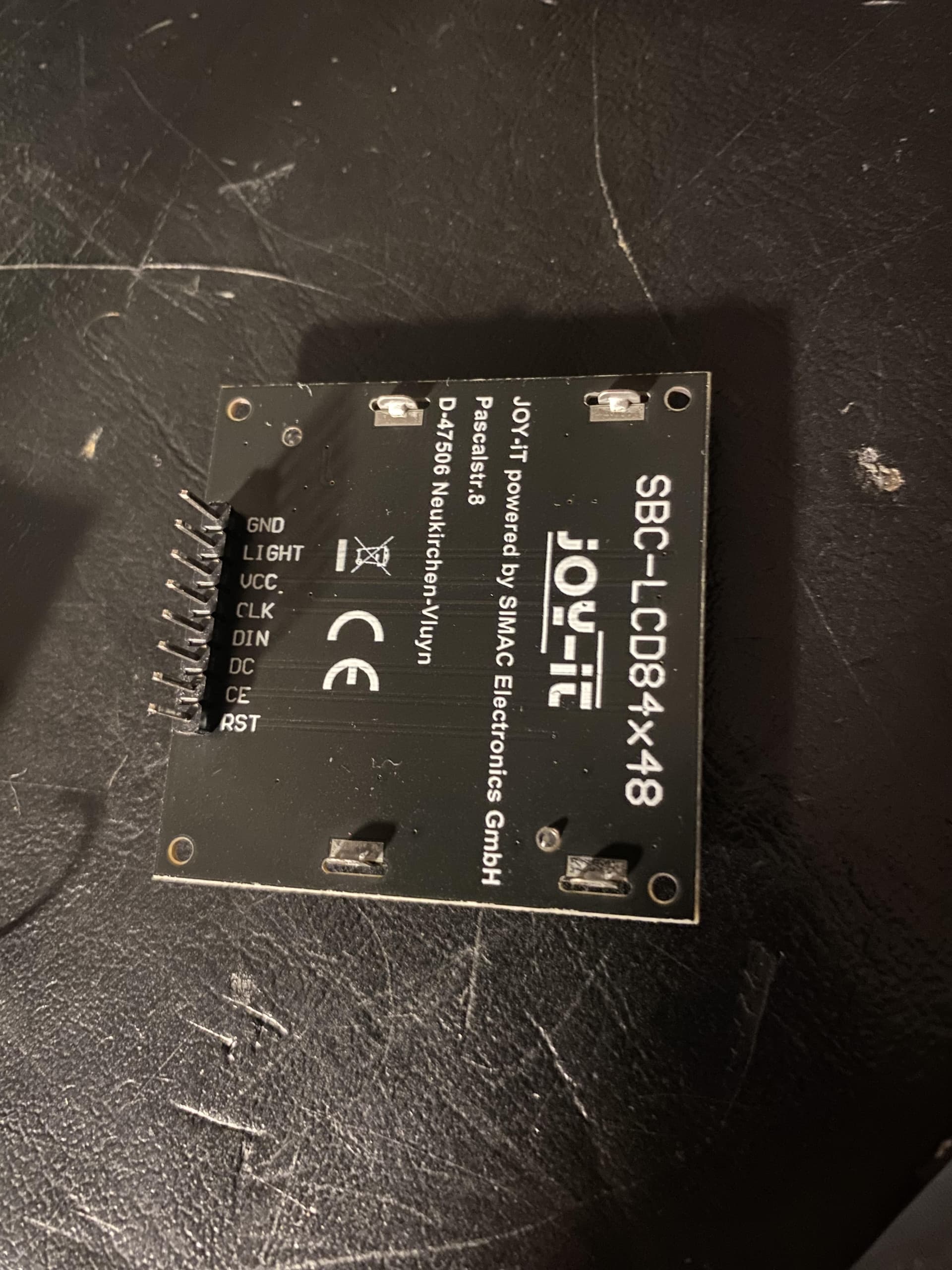

there is my LCD PART, sorry for my absence, i was in college
Better?
And this LCD?

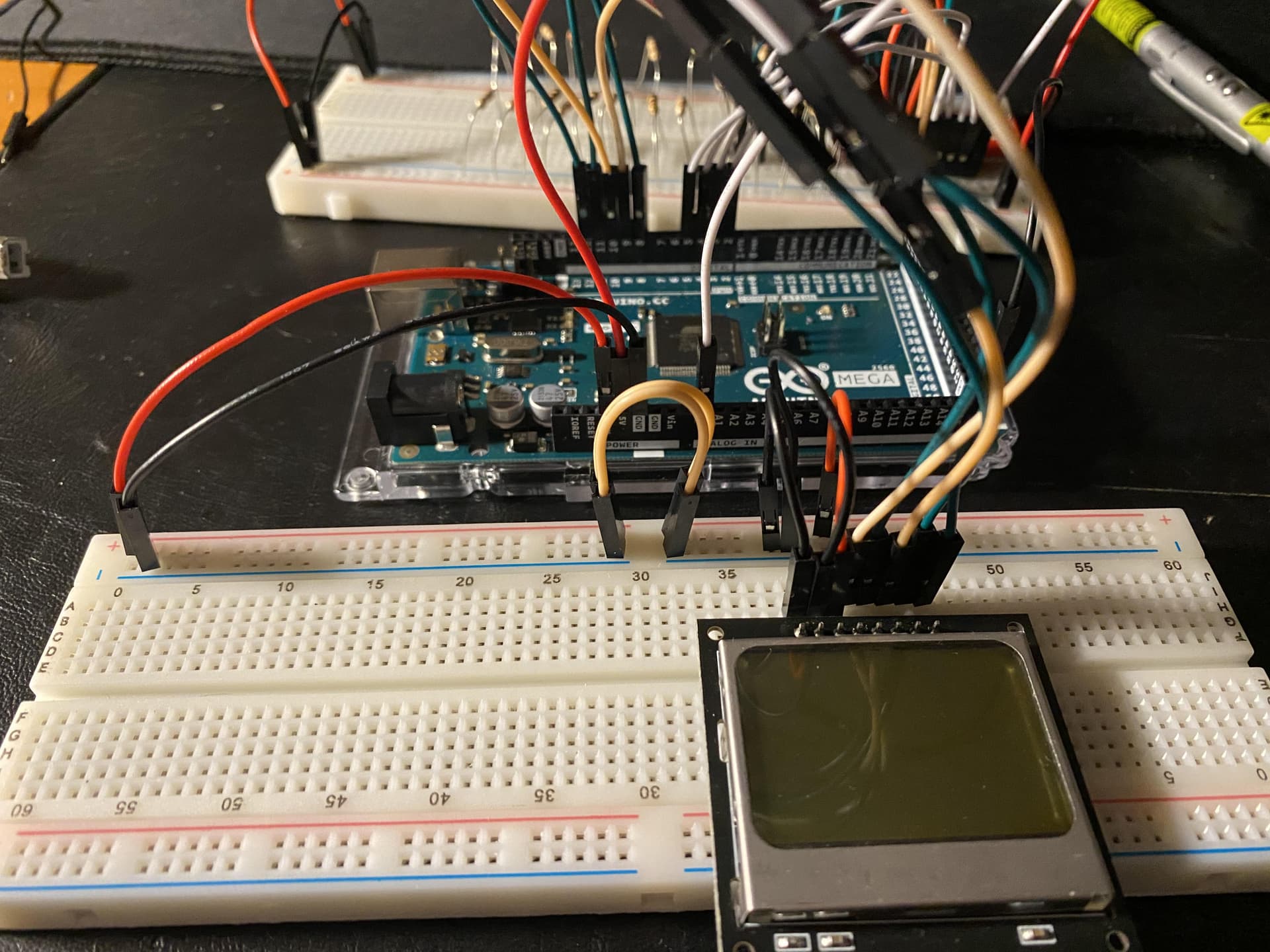

Have you wired the SPI interface connections correctly?
Needs level shifters.
Page 3:
Does it really matter if I don’t have a Level Shifter? There won’t be another way because I don’t have a level shifter.
Precisely, this is where I think there is a mistake, I tried the PIN of the data sheet but it does not work, it is that I ask you the question: is what I did well as in the data sheet? knowing that I don’t have a "level Shifter"
Normal resistors configured in a voltage divider that drops each lead of the 5v (Arduino) to 3v3 (display)... so, two resistors per lead.
(Late edit... i forgot to include this tutorial link)
i did something, and it's actualy working without level shifter so it's okay, thanks for your precious help !!
