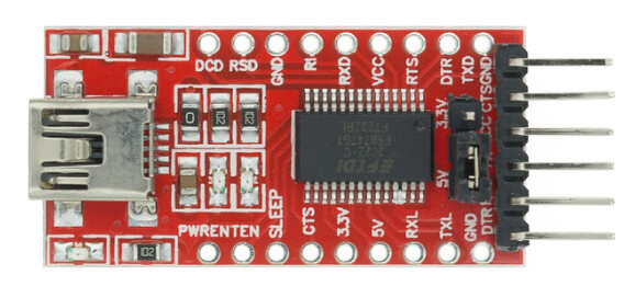

I bought these
https://www.aliexpress.com/item/4000120687489.html?spm=a2g0o.order_list.order_list_main.27.4d7e5e5bqhaiU5&gatewayAdapt=glo2fra
Is that good? :frowning:

It make it difficult for you, as you have to press boot and reset manually.
If you buy one with DTR and RTS, you can program your esp without press manually and at the right moment the buttons.

oh I see. So do you suggest to plug the BOOT to another GPIO like the 25? I think it's a good idea to get the one with DTR and RTS. I will draw another scheme and show it to you if you don't mind.

Ok, just added the DTR / CTS. I left the BOOT at GPIO0 since I've seen that in other schematic.
I will use this FTDI adaptor ... hope it will be fine
