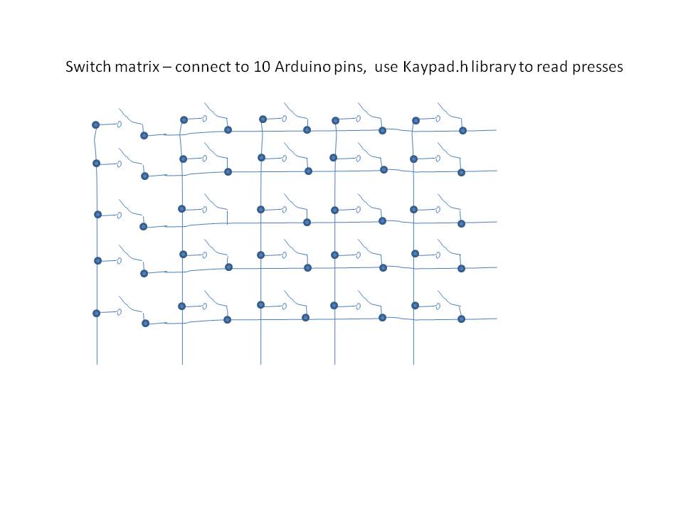

How about a simple 5x5 keypad, 25 discrete buttons so you can space them out some if needed, read buttons presses with Keypad.h library?
Have an adjacent LED to show which had been pressed.
If want to get carried away, use buttons with built in LEDs that you turn as buttons are pressed, have a Clear button to turn them all off when game is over.

How are your soldering skills?
Wire up 25 buttons in a matrix like this.
Wire up 25 LEDs to a MAX7219, turn on an LED when a button is pressed.
I have a board that will make the LED wiring easy for you.

A) you can use a 5x5 button array,
B) or 1 button that you press 25 times.
C) you could use 2 buttons, over and down and make the person press them to light the desired square.
D) 6 butttons, either one per pin (easier) or use a resistor to make a voltage divider for AI (not much harder)
using the 2 buttons or 6 buttons would need you to program them to step down through each row.
for 24 buttons you would need either a shift register to input the button data or use a voltage dividing network and connect to the analog pins.
24 LED's
3 shift registers
caps
the 5x5 LED's light up by the 595 shift register.
