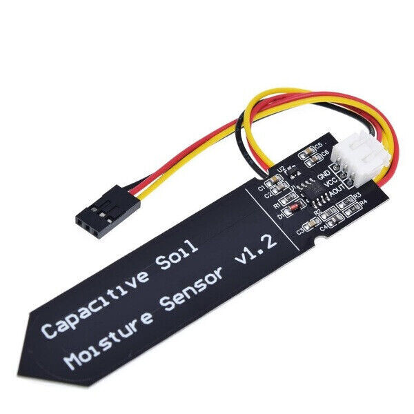

Go with Node MCU. you are going to report mositure (it is not humidity but the moisture when it is about soil) values to web. Uno or Nano boards will not help you a lot for this as you said that you want to buy only one board.
Buy soil moisture probe module also which provides analog voltage with respect to moisture level.

I would recommend a Wemos d1 Mini and a capacitive soil moisture sensor.
