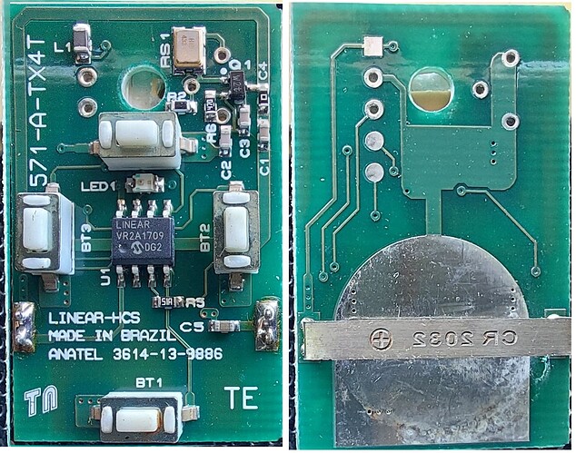

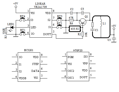

Analyzing the PCB of this controller I identified that it uses an IC with a different pinout.
I did extensive research looking for different types of remote control ICs, I searched with the numbers found on the IC of this control and with numbers found on the PCB of this control, but I couldn't find any datasheet.
It has diferent pinout.

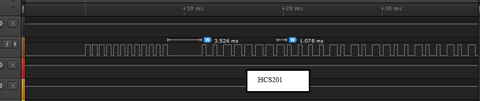

Using a logic analyzer, I got the timing chart of the HCS201 IC and this IC.
Comparing the timing charts, I noticed small differences in timing both in the synchronization block and in the data bits.
With a small modification in the reading times of my project, I was able to read the data from this IC.
But I couldn't find the datasheet of the IC used.

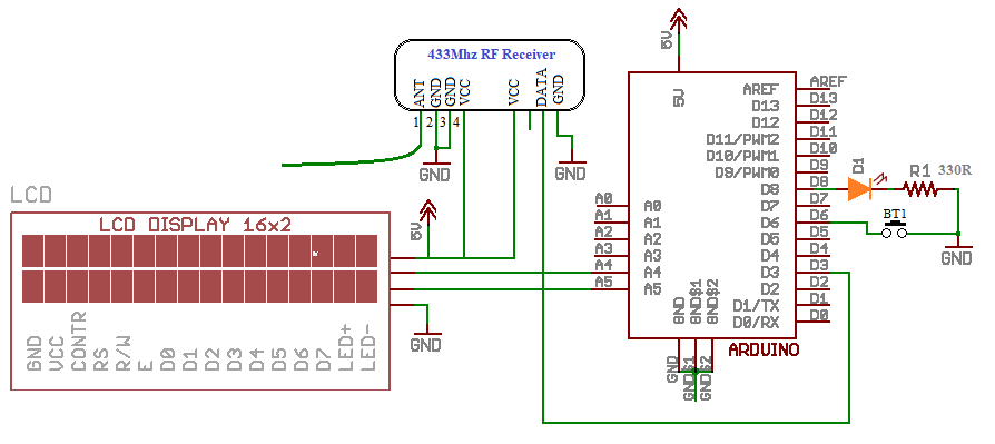

Below are photos of the control, the schematic I created of this control, and the schematic of the project project I built, the timing charts of both ICs (HCS201 and the "VR2A1709" IC).
Although it is unnecessary, I will also post the code I used for this project. It was developed from two codes.
The HT6P20 part was extracted from the RCSwitch.h library example and the HSCxxx part was extracted from the link: Decode Rolling Code 433Mhz Signals with Arduino – Manuel Schütze

The logo on the chip seems to indicate Microchip. Maybe an 8 pin microcontroller like the PIC12 series or an ATtiny.
Wow, how did I not think of that.
Good tip. I'll look for it based on the pinout.
I think it's PIC12xxx, because the ATtiny's power pins are different.
PIC12xxxx
