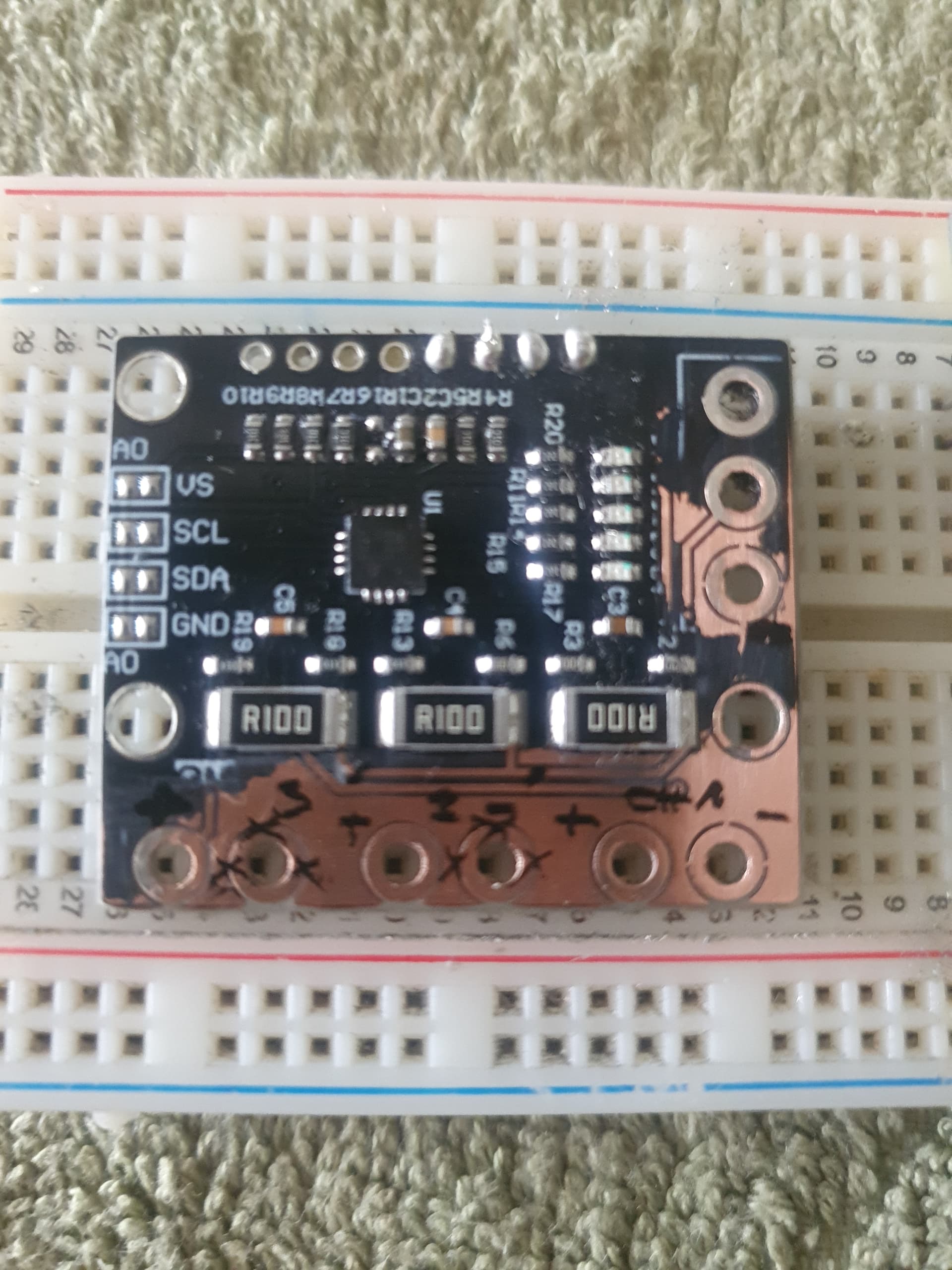

Connect the INA3221 ground (GND) to the motor negative lead.
Connect any of the IN- pins to motor positive lead
Connect a diode between the INA3221 IN- and ground. Connect the cathode to the IN- pin
IN- must be less than 26V and must be a POSITIVE voltage. Make sure you are spinning the motor in the correct direction to generate a POSITIVE voltage.
Do NOT connect anything to the IN+
Make sure you have the module with the 3 separate connections IN+1, IN-1, IN+2, IN-2, IN+3, IN-3.

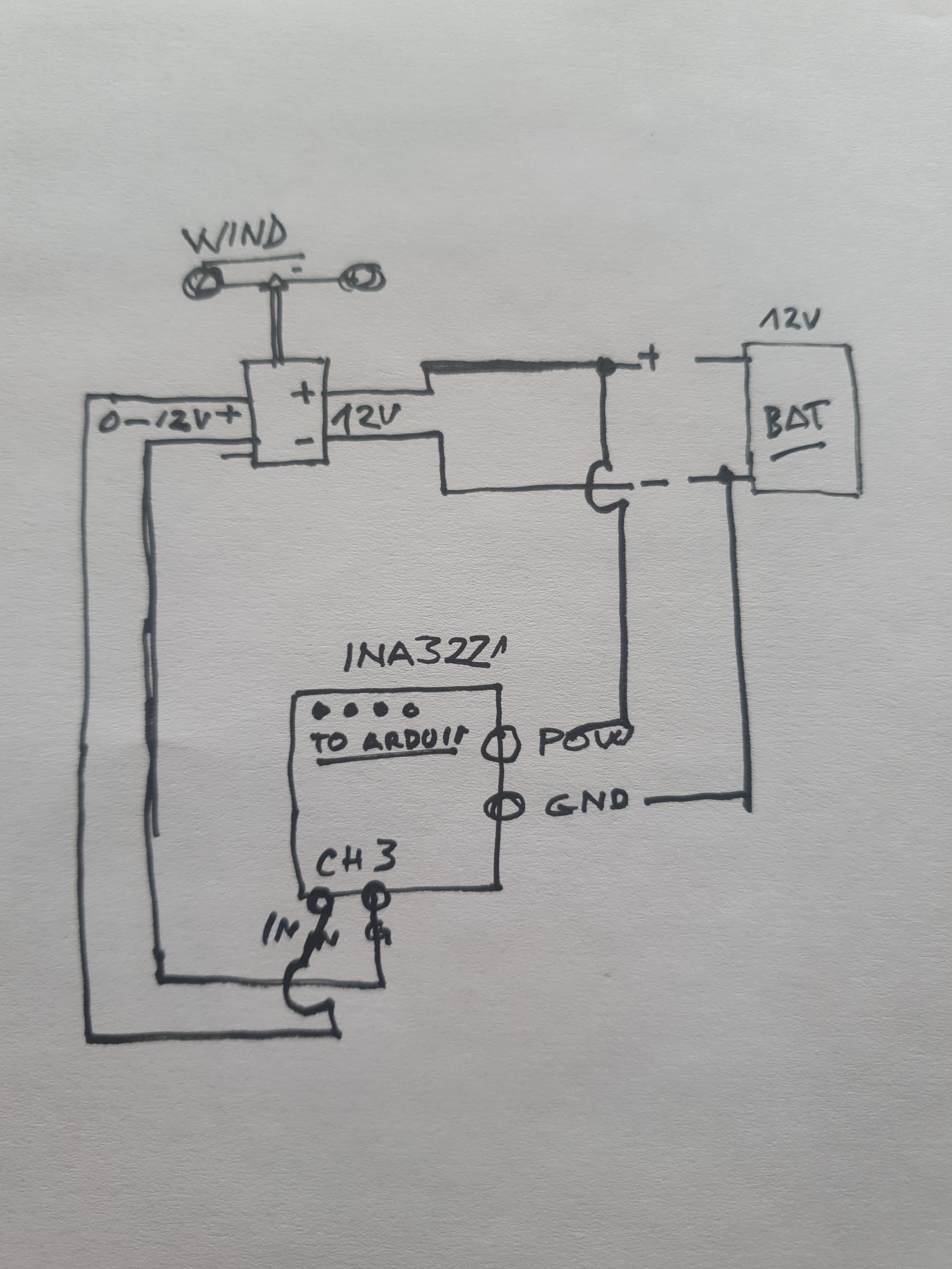

idea is: motor as generator from 0V to 5V being read by INA3221 CH1 and having reult displayed by Arduino (any) via i2c, so, INA3221 VCC (3V3), GND, SDA and SCL to Arduino board and motor output + to CH1 and GND of INA3221 - motor will be turned by wind. Is it feaseable?

Are you trying to measure the output of a 12V anemometer?
Not sure if that board will work correctly with those ground pads cut
Not only from a 12V anemometer, but also a 12V wind direction, and also battery load, all on a ESP8266 with solar charged battery. The ADC port is reserved for the raind sensor (not the rain volume - tippet bucket).

Is the IN- input still connected to those pads after you cut the ground traces?
I don't think it is.

And having a way to read it, as i think INA3221 may do, it's ideal, instead of working with voltage divider and limited ADC ports (1) from the 8266.
The picture shows that you cut the ground traces. Did you cut them or not?
according to Fixing the INA3221 breakout board - #18 by R11K, yes.
but i just want the voltage part (V!, V2 and V3) not the load (1, 2 and 3)...
@pw44
I don't see the jumper wires on your board. Where are they?
Once you put in the jumpers, the pad with the jumper will now be the IN- connection.
So if you follow my instructions in post #3, it will work.
Why not use an ADS1015 ADC module and a voltage divider. It's simpler to use, you will have more precision, extra channels and a lot less headache
I find out that the INA3221 breakout board have some serious design errors, so will not be suitable.
Even cutting the leads and creating new paths did not work well.
Replaced by two INA226 and it's working like acharm, 2 independent power sources.
