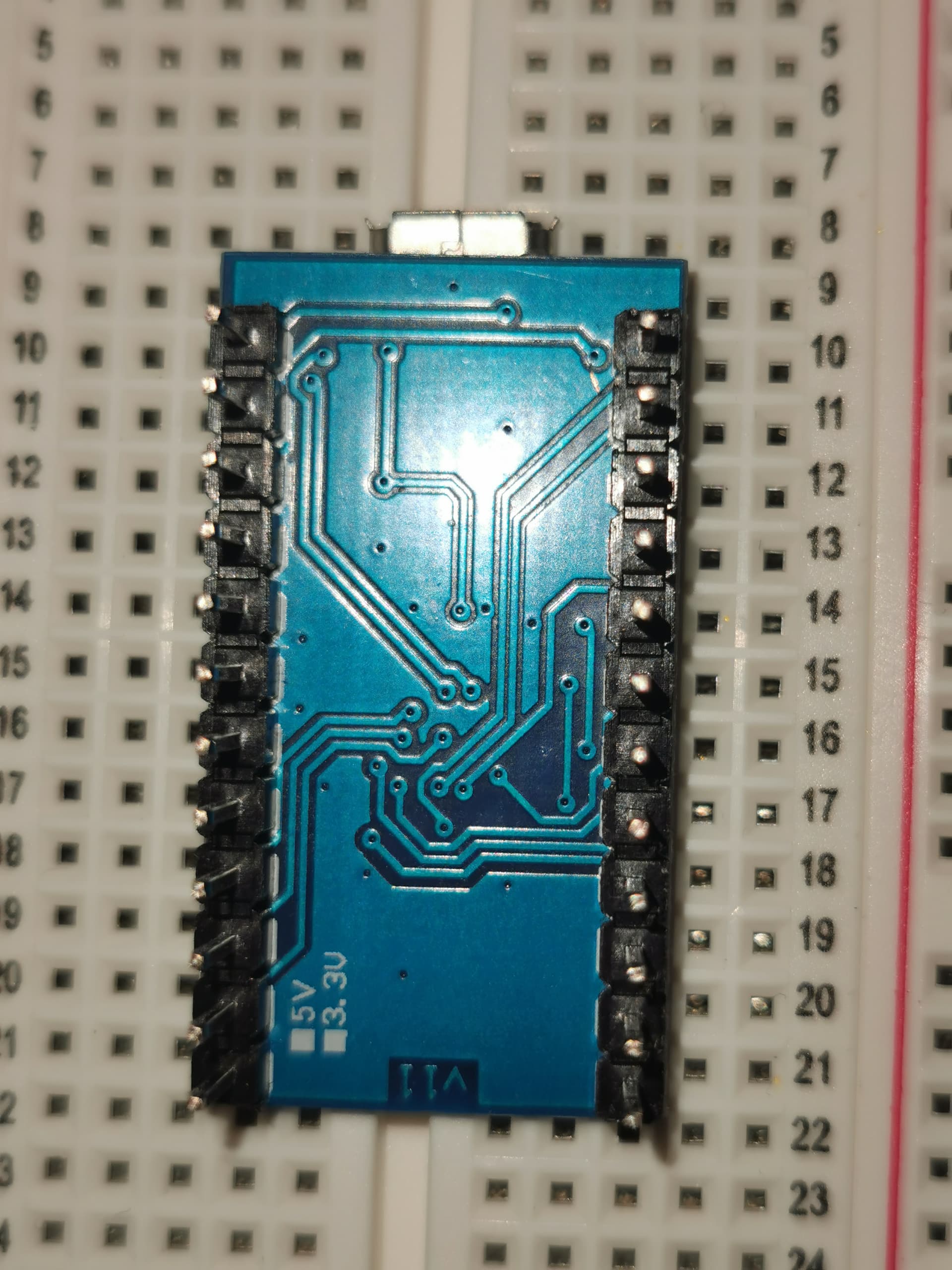

Hello everybody,
I ordered a bunch of ProMicro ATmega32U4 5V 16 Mhz from AliExpress.
Uploading a sketch to try the keyboard.h library, from that moment the board it not recognized anymore from the computer. Before the board was recognized as Arduino Leonardo but now it is impossile to communicate with it, even if the red led is still on.
I try to burn the bootloader using my Arduino Uno connecting the wires as specified in the sketch:
  • Pin 10 in Arduino Uno to RST in ProMicro;
  • Pin 11 to MOSI pin 16;
  • Pin 12 to MISO pin 14;
  • Pin 13 to SCK pin 15;
  • Ground to GND.
When I try to burn the bootloader, I have the following output:

The led in the ProMicro blinks in this procedure but I can not burn the bootloader.
Is the chip fried? Is there anything else I can try?
Thank you so much for your support.
Re-check the wiring, the could be a mistake.
You mean it could be a different pin setting?
I took the reference sheet from SparkFun, even if the AliExpress board is it not.
Is the reset pin connected?
Yes, pin 10 in Arduino Uno is connected to the RST pin in the ProMicro.
Please can you take pictures of both sides of the board, and upload them here.
Looks alright, how did you connect it up?
I wired as specified in the first post.
Playing a bit with the wires, maybe for a false contact, now I am able to go further but another problem arises.

Looks like a bad contact to me....Wire it up somewhere else on the breadboard.
I checked every contact with the multimeter and it is fine.
Now I am not able to establish anymore a connectgino between Uno and ProMicro.

At the end, I believe that the chip fried. :frowning:
That could be quite right....
