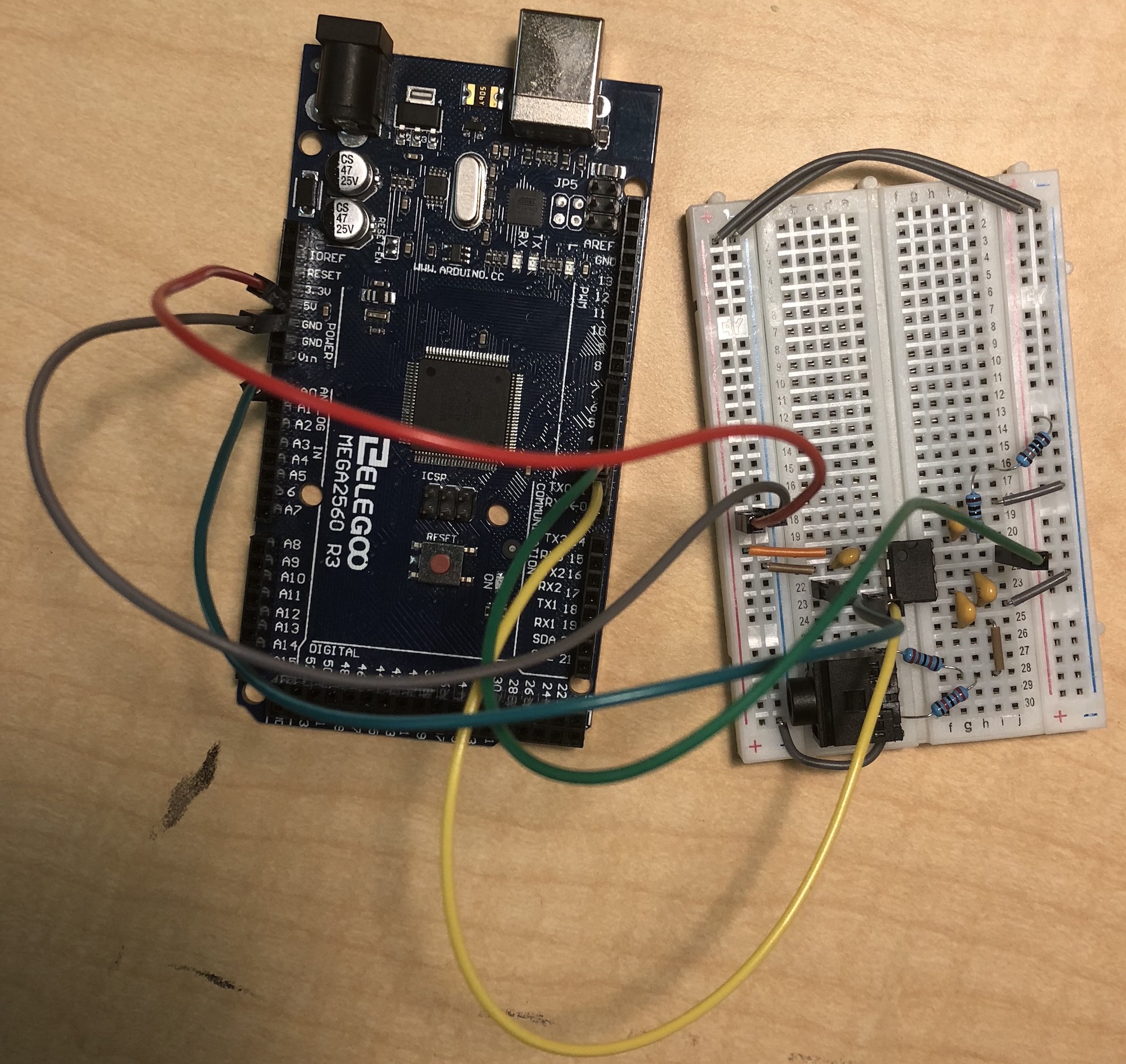

Hello, everyone. I know there are dozens of posts about the MSGEQ7 chip (and believe me, I've read them), but I've run into an issue that I still can't solve.
Purpose: to use the MSGEQ7 to analyze the spectrum of incoming music and output DC voltages proportional to the signal's spectrum. This will be used to control a strip of programmable LEDs.
Datasheet: here
Circuit: here. The circuit design is straight from page 4 of the datasheet. Music comes in from my phone/laptop through an aux cord into the jack. Left and Right channels are connected via two 22KΩ resistors in series with a 0.01uF capacitor (I've also tried using a 0.1uF cap). A 33pF cap combined with two 100KΩ series resistors (making 200KΩ) make the clock. Strobe and Reset are connected to digital pins on the Arduino Mega. The DC output is connected to pin A0 on the Arduino.

You seem to have the circuit wrong on your bread board. There is a capacitor between pin 5 and ground. This will be shorting out your signal into the chip.
Thanks for the reply, Grumpy_Mike. When I read the rules they didn't say I had to embed the pictures into the post. I thought I could simply link them. Sorry about that.
With regards to the bread board circuit, the capacitor is actually between pin 6 and ground. The perspective was a bit wonky there. See here:
By the way, ignore the resistor in the bottom right. I should have removed it before taking the pictures. It's a 220Ω resistor for the LED data pin.
  1. You can add attachments
Well that bit looks fine but we can't see where the wires go to on the Arduino.
Also solderless bread board produces poor contacts so go through those for continuity with your meter. Also your components are all spread out which is not good for the high frequency bit around pin 8 and the decoupling capacitor on the chip. It should be as close to the pins as possible.
Do those resistor from pin 8 actually add up to 200K? Use your meter to check.
The other thing is that audio jack socket is it really making contact? The ones I have look like this on the top but do not fit into a 0.1" pitch hole spacing. Check continuity from the other end of a jack lead connected to it to the components on the resistors.

Really great ideas, Mike! I'm using this headphone jack and tested its continuity to success. I also checked the resistors and they indeed add up to 200KΩ. I condensed the circuit a bit as well. Here are some updated pictures:
It still doesn't work properly. Now I get straight 0's. This is really strange.

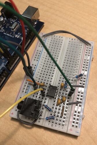

Here are two pictures of the new circuit. Sorry for the mess:
I only have the left channel connected, but I set my phone's audio to be mono and shifted the balance 100% to the left channel. Also, I have two electrolytic capacitors connected in parallel summing to 14.7µF (instead of 16µF) if that's okay.
Now I get 1s and 2s as my output for everything. Even playing a 400Hz tone does nothing. I don't have access to an oscilloscope at the moment (I will Wednesday) so I can check the sound then to make sure it's actually getting amplified.

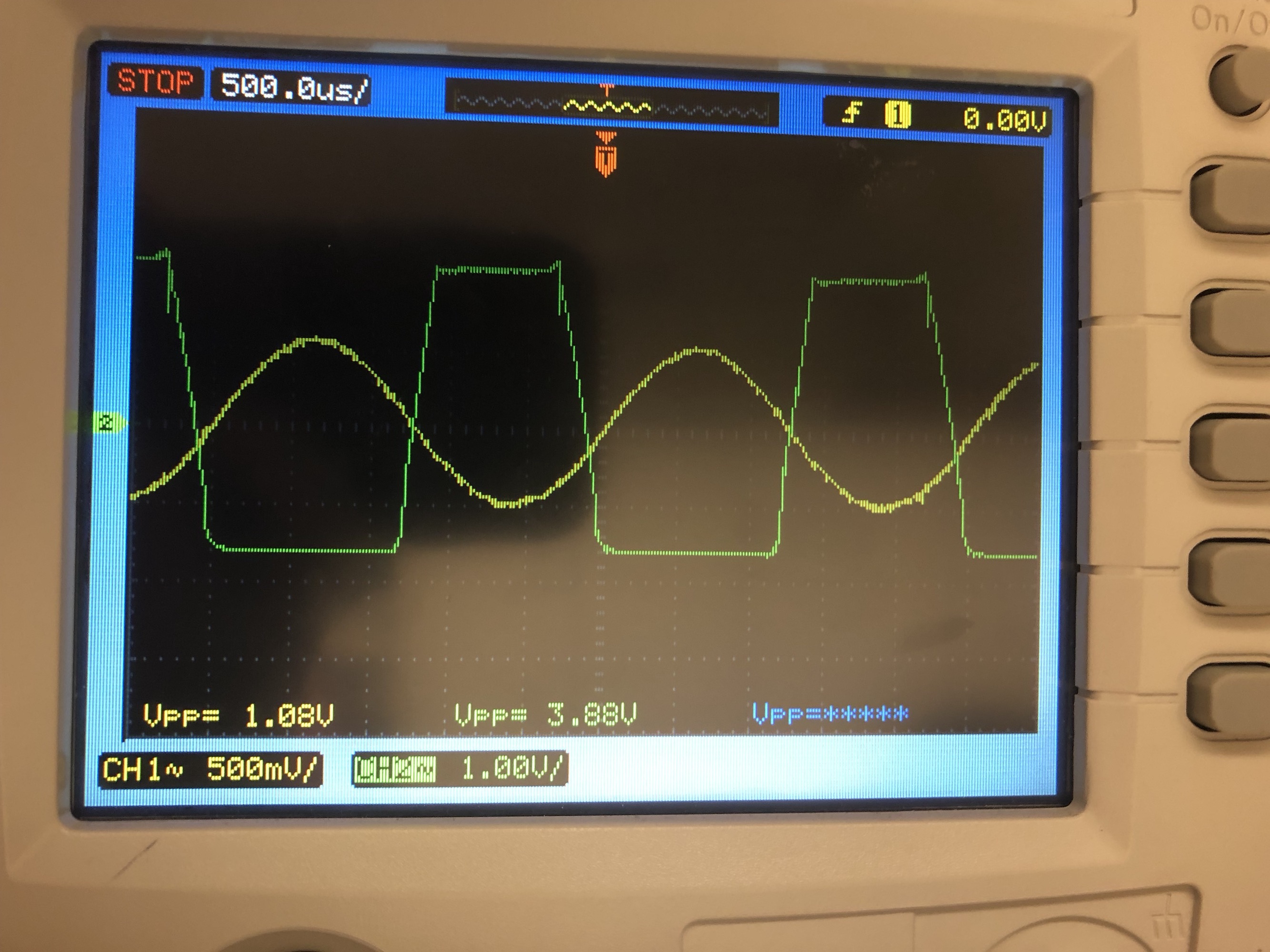

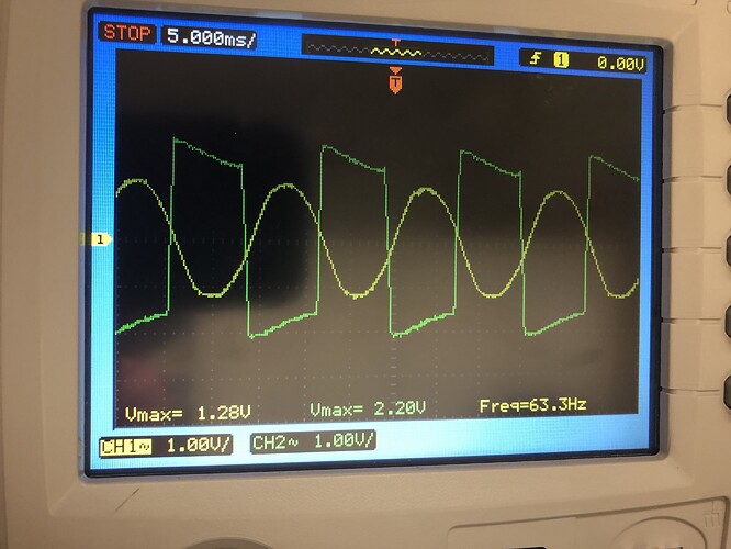

So I tested the circuit with an oscilloscope to see if the sound was properly going through the circuit and getting amplified. Despite the ratio of the resistors being 10:1, the voltage level was only amplified 3 or so times. So either my understanding of amplification is flawed (very possible), or I need a different op-amp. I tested the circuit using a 63Hz tone and a 400Hz tone. The pictures of the scope are below. I would have taken screenshots on the scope directly, but I forgot to bring a USB drive.

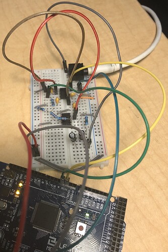

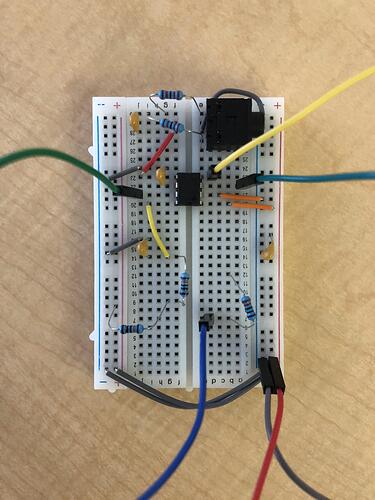

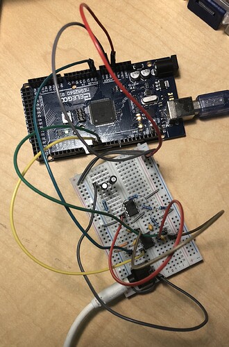

I disassembled my circuit and rebuilt it from the ground up, hoping to find any mistakes I made. This time, I just used a simple summing amplifier. The gain should still be 10. Unfortunately, it still doesn't work.
I'm gonna try this one more time with my NE5532P op-amp when I get my hands on it (it's made for audio applications), but if it doesn't work, I think I'm just gonna throw in the towel.
The output signal is severely clipped. This is a result of the operational amplifier you used not being able to get close enough to the its power supply rails. You should be able to see what how close you can get from the data sheet of the op-amp.
What you need is what is called a rail to rail op-amp, or close to rail to rail. Again looking at the data sheet will tell you. I tend to use a MCP602 which is a good compromise between cost and rail to rail performance. The closer to true rail to rail operation you get the more expensive the op amp gets. From its data sheet you see:-
Linear Output Voltage Swing VSS + 100, —VDD – 100mV with RL =25kΩ to VL, AOL ≥100dB
Which means it will get to 0.1V short of the positive supply and 0.1V above the negative supply ( normally ground )
