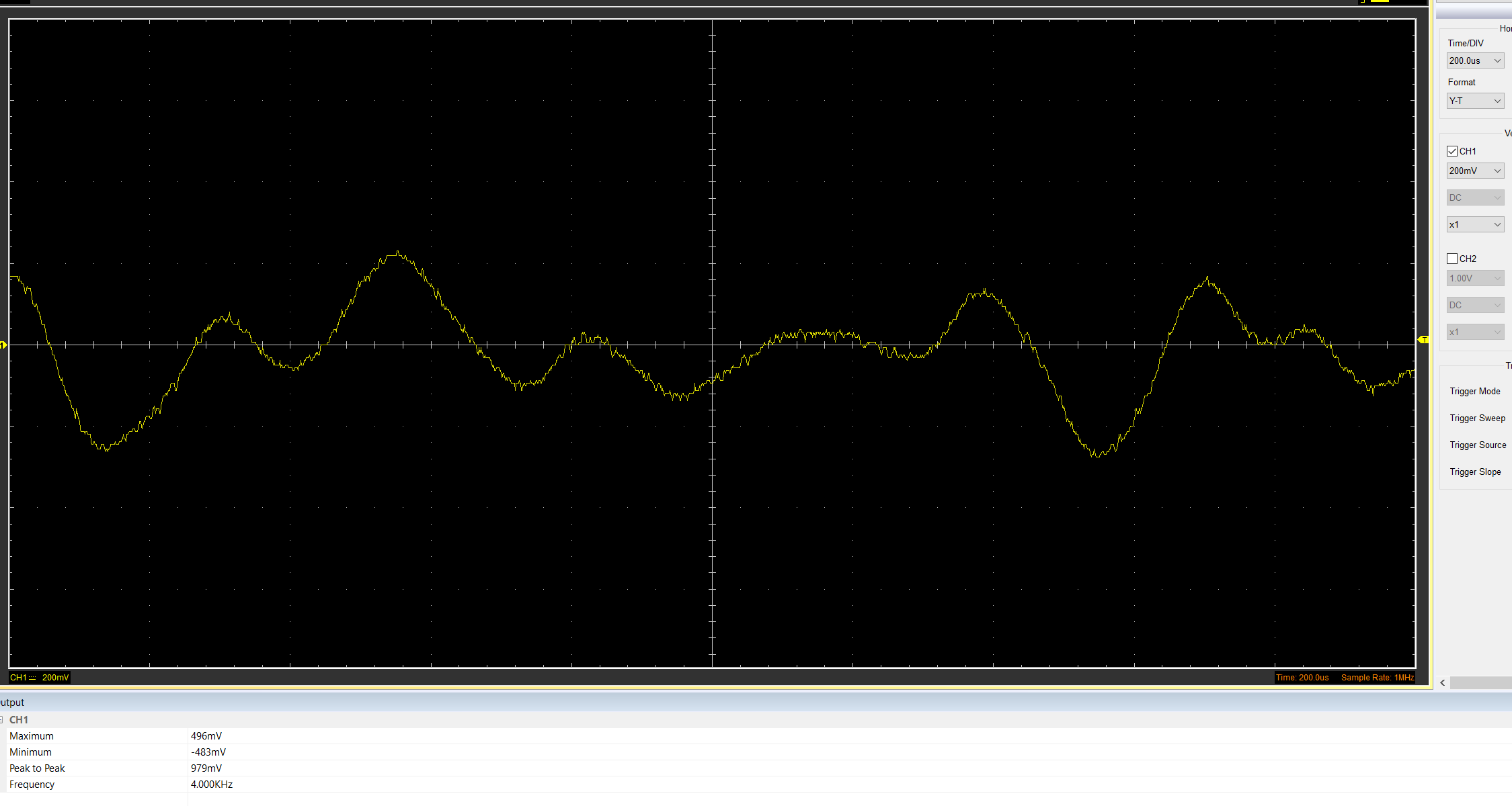

Hi ,
I try to use an MSGEQ7 for my project to drive a Ledstrip. This MSGEQ7 spectrum analyzer chip is connected at pin 5 to a typical audio connector. In between I have a resistor from 22K and a capacitor of 10nF in series . I also tried 100nF but with no success. When I measure pin 5 (Audio In) at the chip I measure a High level (around 3.3V) because I powered the chip with 3.3V. I expect to see an audio wave but I see no wave at all.
When I decouple the wire from Audio In and measure it then I see the audio wave coming in. So the moment I couple it to pin 5 my wave disappears and I have a high level. Is that chip defect?

I attached here 2 screenshots of my scope. One is with pin5 attached, the other is without pin 5 connected. Measure point is between capacitor and pin5.
WOW! You have a 'scope! I assumed you were using a multimeter. If you have a meter, double-check check with your meter. Is that a "real" oscilloscope or one of those cheap USB boards that plugs into USB? Do you trust it? Does the 'scope measure 0V (maybe with a little noise) when disconnected?
...There are (rare) cases where attaching a 'scope probe (or meter probe) changes the voltage/signal. It's "funny" when you get a circuit that works when you touch the probe and then fails again when you disconnect the 'scope.
So indeed I am surprised I have high level on input because I also have the capacitor in serie. That should remove the DC component in the signal. It's like the IC is putting it high again.
Yes, this is baffling. I once had a boss who used to say, "Stranger than truth!" Are you sure it's a 10nF non-polarized capacitor? ...A 10uF electrolytic (polarized) can "leak" into a high impedance and it can leak badly if reversed. You already tried a different capacitor so we can be fairly confident that it's not shorted.
Since you have a 'scope you can trigger with on the reset pin and look at the output from the MSGEQ7. But, you'll really need some known (electrical) test signals. I guess you can make a quick check using the microphone to see if you get "something" or nothing. If you get a constant DC voltage you know it's not working.

The one with the Audio input has the audio ground connected to the mid rail bias point through a capacitor. Therefore there is no DC connection to the signal ground and so it will not work.
Ok thanks for the input, I got it working by adding it to the ground of the circuit (pin 2) and also I think a bad connection on my breadboard caused some issues.
I connected pin 6 to the same gnd as well (with the capacitor).
happy It's working.
